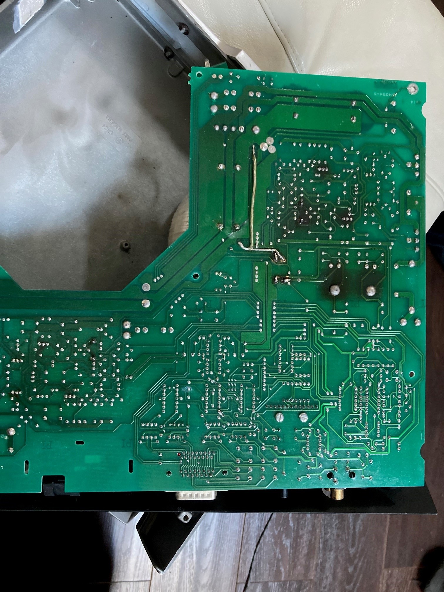

Hi all, I'm after some help from the experts if i may. Ebay special, quad 99 power amp, the amp will not come out of standby. Im going to use as a stand alone amp so i have the selector on the "Input" but the red light stays a constant red.

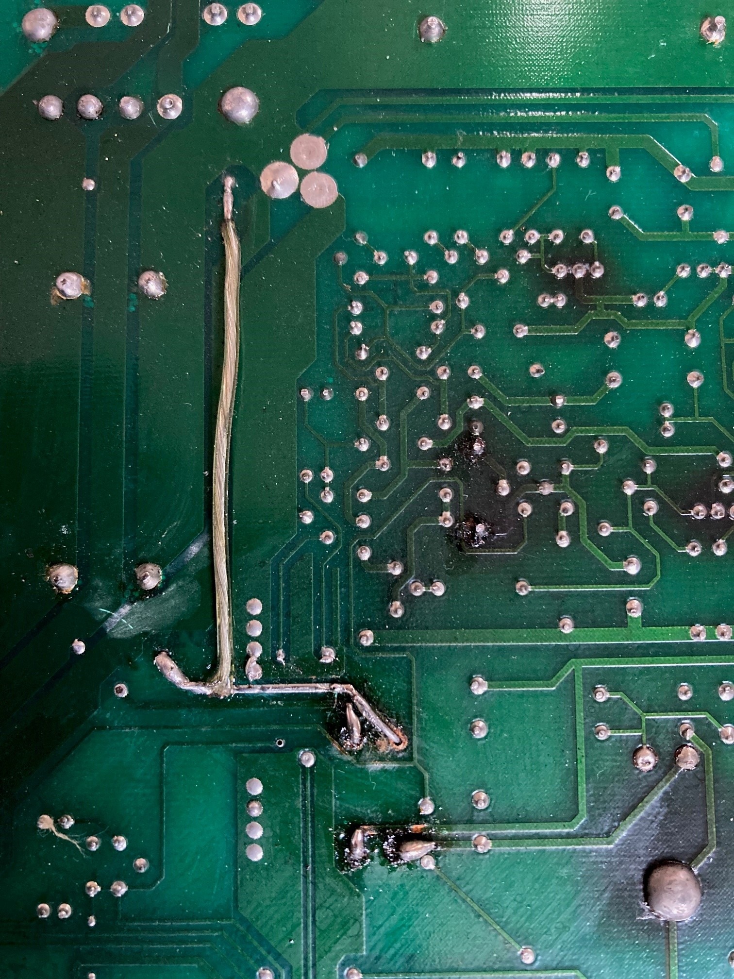

I have attached some photos of the board, which it appears to me, has had a mod of some sorts. can anyone confirm what the mod is for? and by chance could this be to bypass the selector switch???
Any thoughts gratefully received. Thanks.!

That 'mod' could simply be wire replacing a burnt or broken PCB track. Based on my experience of repairing a 99 preamp, the tracks and through holes are very fragile and won't allow too much rework before falling apart. Good luck.
Hello ITCSUK,
first of all, I would clean the circuit board from the dirt (brush and spirit) there may still be a hairline crack on the soldering. Then repair properly again and check the through-plating from the lower to the upper layer on a board with a double layer.
I was just looking at the board and saw two spots that I would take a closer look at. Firstly, the resistor (marked red), which looks a bit stressed, and the marked connection on the right capacitor (where the other side was patched) looks a bit rough and may have suffered from excessive stress. Maybe everything is unimportant because repairs are out from afar are always kinda bad
Good luck and have a pleasant day
These have an underrated capacitor across the muting power supply, first thing after the diode from the mains transformer. It needs to be 100uF 100V and it is found on the later units as 50V. It goes leaky, pulls down the muting voltage, so it would not come out of mute. C146 on the mono version, dunno on the stereo one.

Another possible suspect would be if any of the rail voltages were faulty. I don't know how much power management monitoring the amplifier does to prevent the system from unmuting.
Muting, in this case, isn't the typical relay disconnecting the output of the amplifier from the speakers as you can see the output inductors are wired directly to the terminals. This is the same as the 77. I've got a 77 integrated and when you turn that on you get a turn on thump through the speakers even though it's still in standby. If the 99 power amplifier does the same thing then you'd be able to check for DC offset on the outputs of the amplifier. If it's below ~50mV then the power amp circuitry itself would appear to be functional. If DC offset is only a few mV then you could connect the amp to a cheap speaker, power it on, and see if you get the typical power on thump. If you do then that would indicate that the power amplifier circuitry is fine.
Looking at the PCB you can see differential line receivers. Now Quad only provided one set of additional single ended inputs for non Quad systems but they are clearly using balanced connections through their Quad link thingy. It wouldn't be too hard to modify the amplifier for a pair of balanced inputs I don't think.
Moving on from that. If the power amplifier circuitry is working correctly, and you cannot get the amplifier to come out of standby, then theoretically all you'd need to do is find out where the signal is being muted (following the path of the single ended inputs) and then bypass it.
The modification on the underside of the board definitely looks like a repair job.
