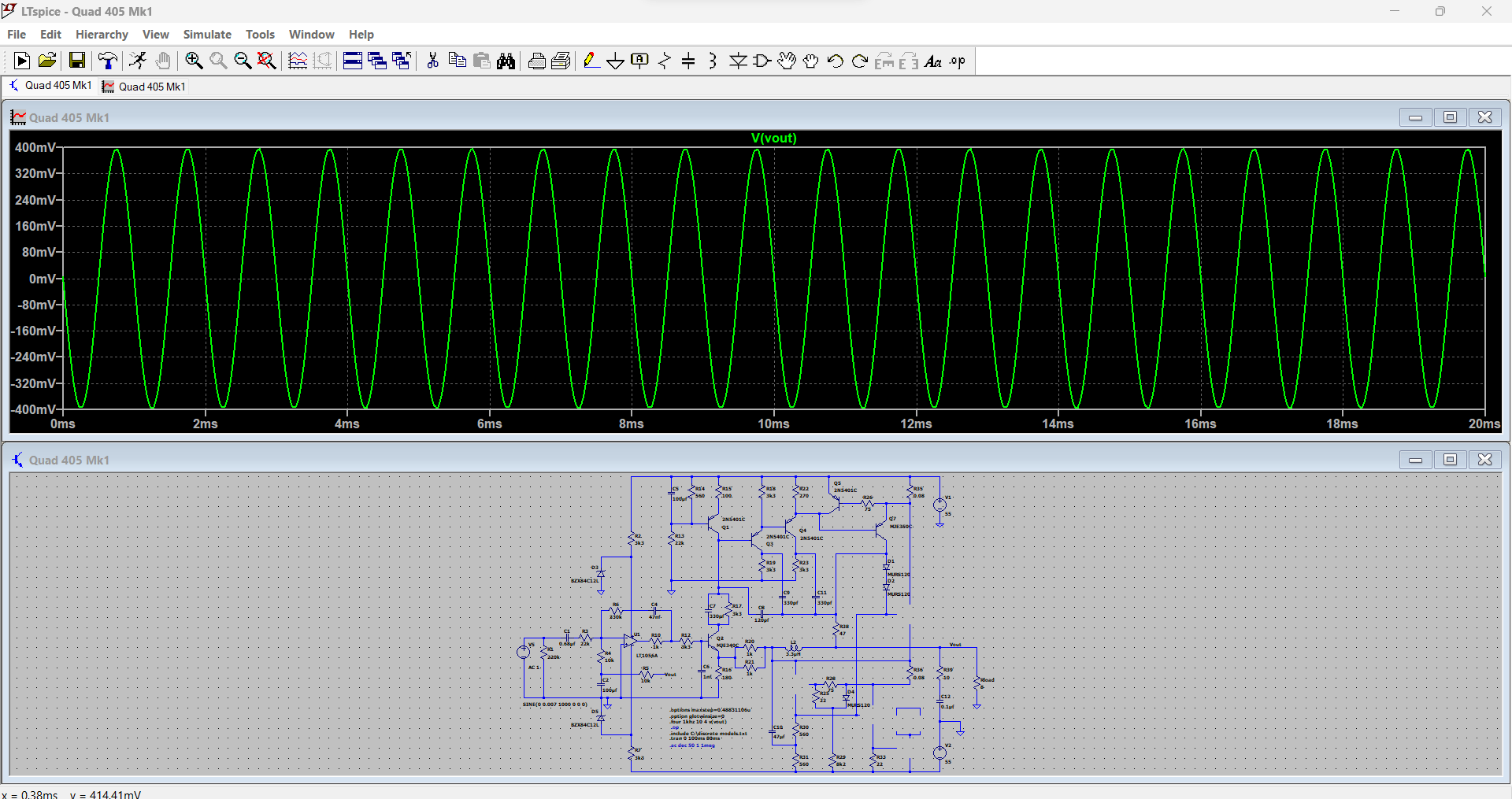

My sims of the 405 show it can deliver 1 watt into 8 ohms resistive in pure Class A and it does this even with the output dumpers removed. At higher load impedance more voltage swing is available, for example it can deliver around -/+30 volts into 100 ohm in Class A.

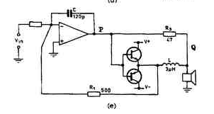

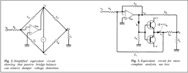

@hbc - the Current Dumping concept is different. See attachment.
In a nutshell - the class A amp drives the bridge to the dumpers. When the dumpers switch on, there is a jump in the loop gain which would normally cause distortion.
But with the bridge balanced, the conduction of the dumpers actually increases the feedback factor which decreases the gain and thereby cancels the jump in loop gain. The result is that (ideally) the switching of the dumpers does not impact the performance.
See fig 2 & 3 in the attached.

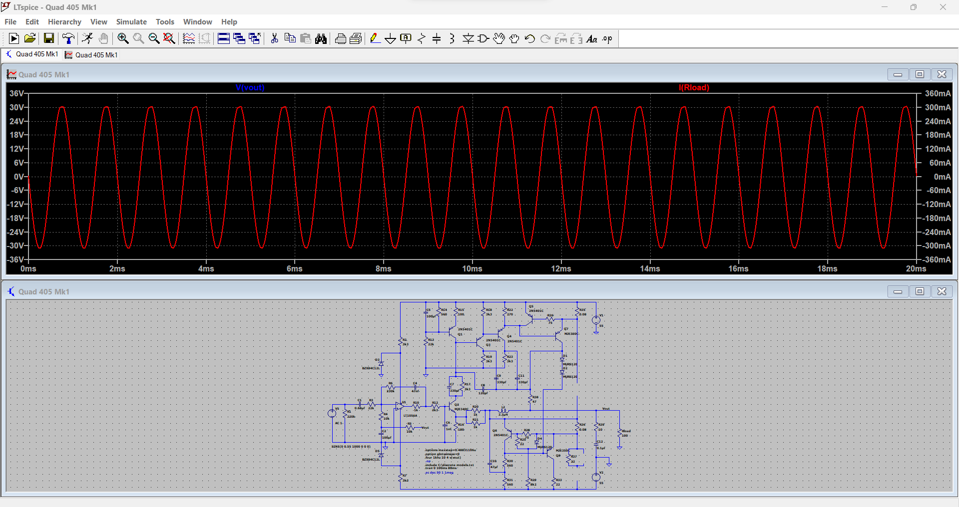

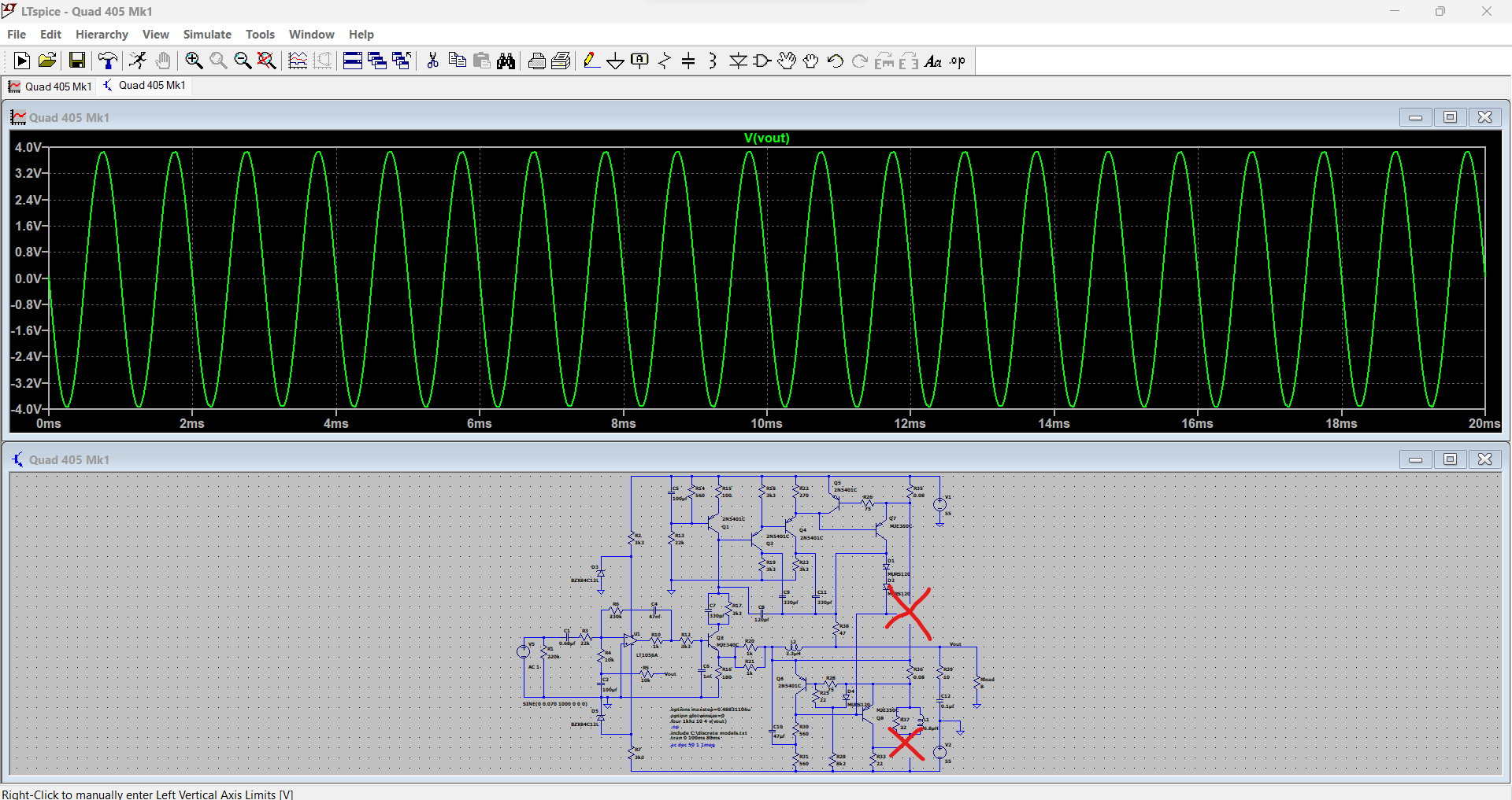

I thought I had attached an image to yesterdays post.
1 watt into 8 ohm with dumpers removed. The output current ability (so -/+ 500ma here) seems to decrease a little at higher voltage swings into higher impedance loads. Its progressive but falls to around -/+300ma at -/+30 volts output into 100 ohm (second image)
LT sim file attached but you will have to change it to use your own transistor models.

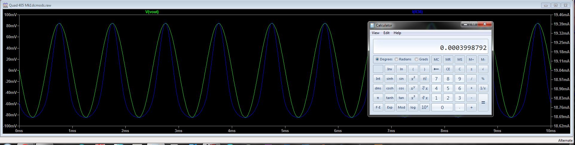

@Mooly Thanks, that's very kind. I put some generic sensible to me guesses in and off we go :) Indeed taking out the dumpers and it give one watt into 8 ohms, which is very pleasing, actually. I haven't full thought this through yet, but am conscious that the bottom "dumper" is a CFP, and with the NPNs removed the PNP device is still acting like a dumper. Removing that and it all falls to pieces, leaving the bootstrapped resistor to pull the 8 ohms....

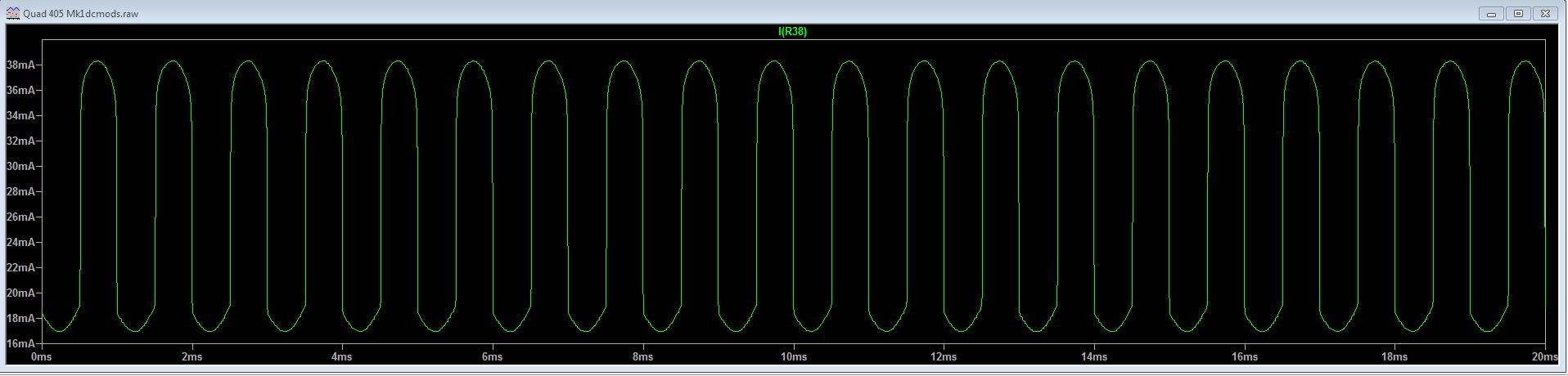

This is my problem with the 1 watt output (with dumpers connected). That (current through R38) should be a sine wave if it is solely coming from the class A not driving the dumpers.
If I wind down the input to 1.5mV I get this:
Where I R38 (blue trace) is starting to look "fairly" sinusoidal as the dumpers are pretty much not doing anything. Which gives me 400uW output in to 8 ohms.

That makes sense in what you are saying.
So cutting all the lower stage out leaving only the two 560 ohms for current and it delivers 280mv rms into 8 ohm (10 milliwatt)

@hbc, your post above shows the bridge in all it's glory: the two resistors plus L & C! (Except the input R).
No math necessary.
When the dumpers switch on, current is flowing through the L which generates a feedback signal back to the input, in addition to the feedback through C already present.
Thus switching on the dumpers, which increases the gain, also increases the feedback factor.
The trick is in balancing the bridge: When the bridge is balanced, the extra feedback exactly compensates for the extra gain. QED.
In the attached figure, the balance condition is Z1*Z3 = Z2 * Z4 and Z1 and Z3 are the resistors, Z2 is the cap and Z4 is the L.
Since Z2 = 1/wC and Z4 = wL, the balance becomes R1/R2 = L/C.
Your sim looks OK.
