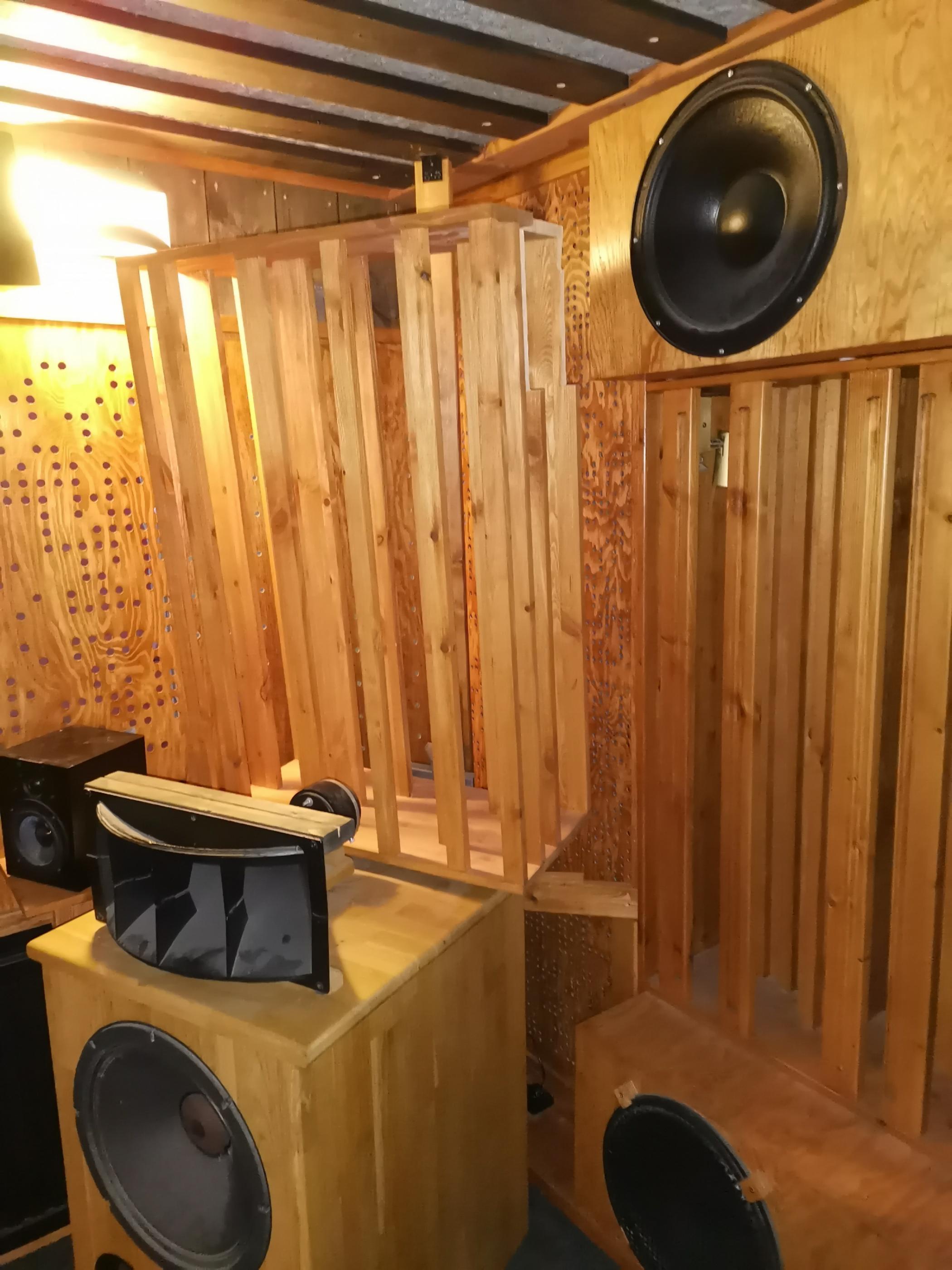

Volumetric diffusers (= real 3D-diffusers) are quite easy to build and also less time consuming and expensive than Schroeder or skyline diffuser. You can pick your choice of material, wood / MDF / particle board etc.
If you google you can find ie:
(PDF) Volumetric Diffusers Check figure 13 which show the principle, a "layered fence" with varying slat widths, starting from small towards the room and then wider backwards towards the wall. The math behind is quite heavy to comprehend, a DIY-construction is not. Richard J Hughes wrote a thick document for his Ph D degree in acoustics on volumetric diffusers. I used some of his examples and wrote myself a spread sheet in excel to quickly customize 2 pcs in my room. (Have it on an old computer if I can find it in case anyone is interested.) For a truly wide band version, use the entire width of the room and let depth be something like 50-60 cm (20-24 inches.)
The picture shows 1 of my small ones (behind the horn): 5 layers, 30 cm / 12” deep and 70 cm / 27,5” wide, height 103 cm / 40,5”, slat width at front 35 mm / 1,38 " the last one at the back 143 mm / 5,6", -the largest I could fit in. If one attaches some LED strips behind the slats it can turn out rather nice aesthetically.

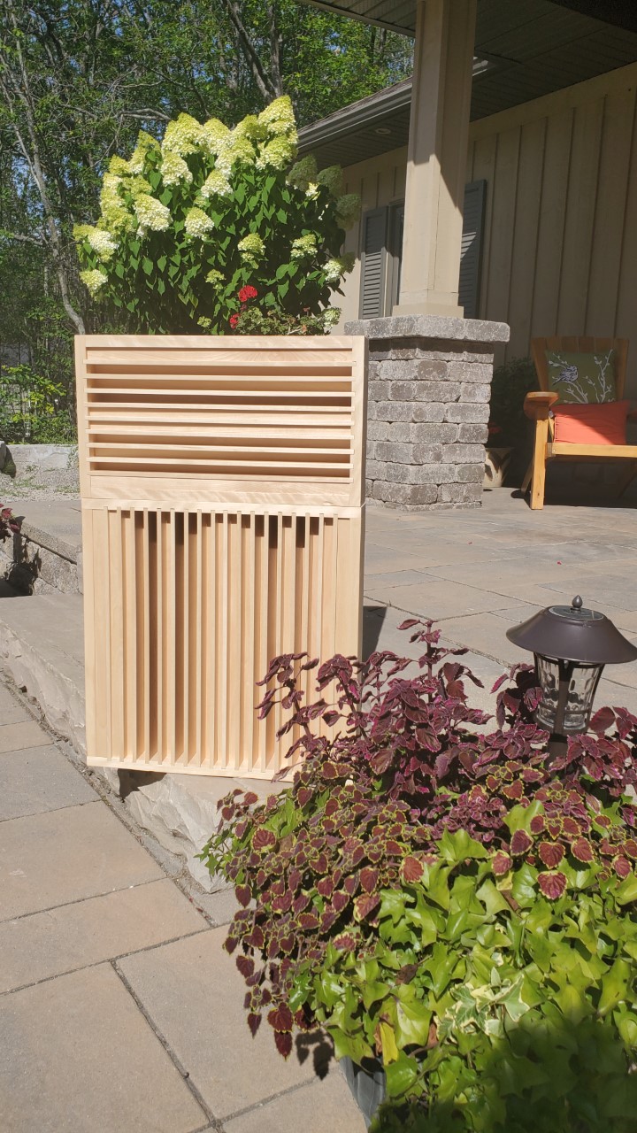

I'm making 42 of these and there are 9 slightly different sizes to fit in between ceiling trusses. Made from solid Birch - For piano practice room.. Bit of a learning curve with fit and finish.
