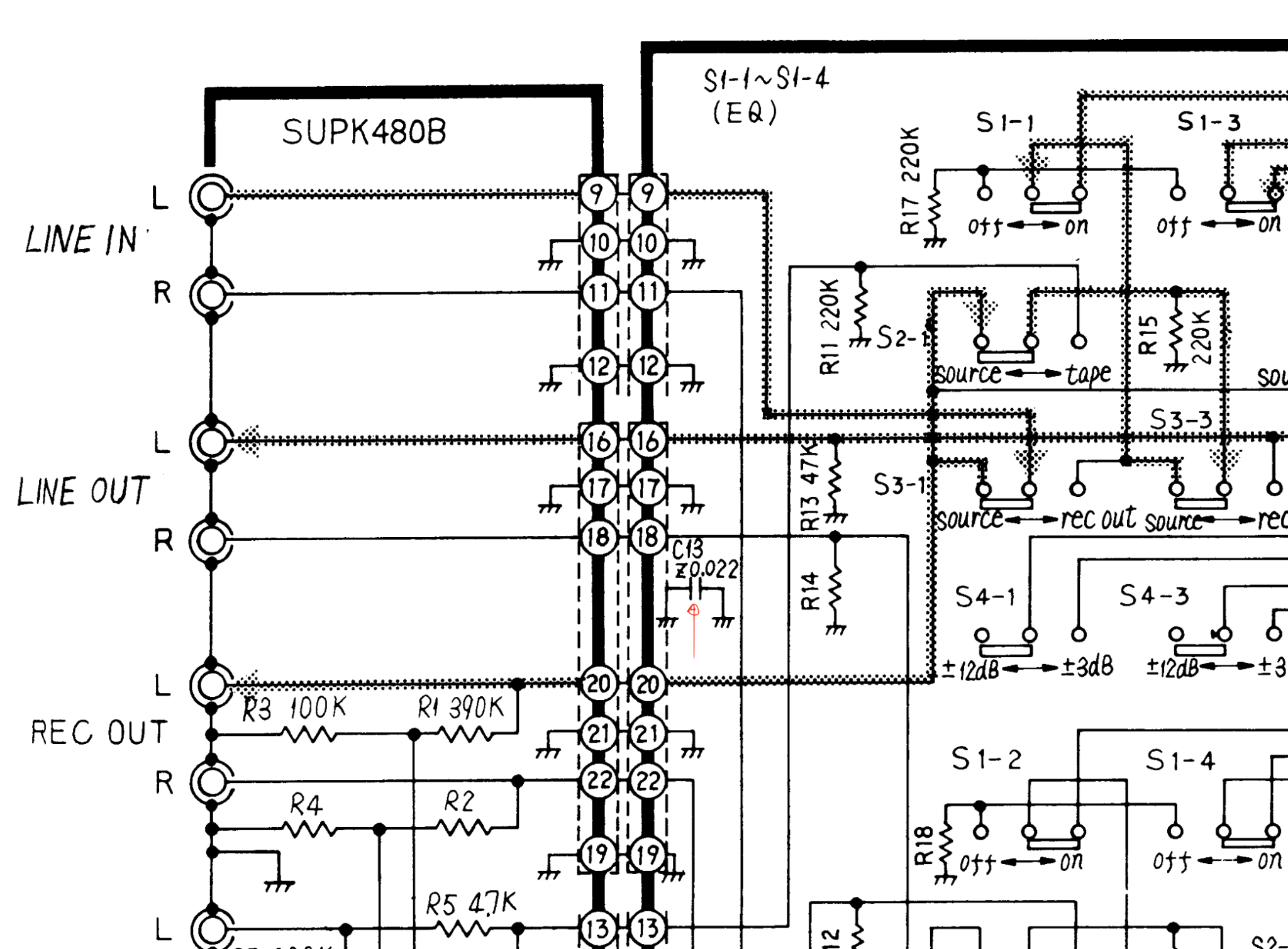

The schematic (The capacitor is C13, marked with a red arrow)
As you can see, this capacitor is placed between two grounds. I soldered the new cap with the negative side facing the right ground (chassis).

Use a 10uF bipolar electrolytic and you won't have to worry about polarity. For example:

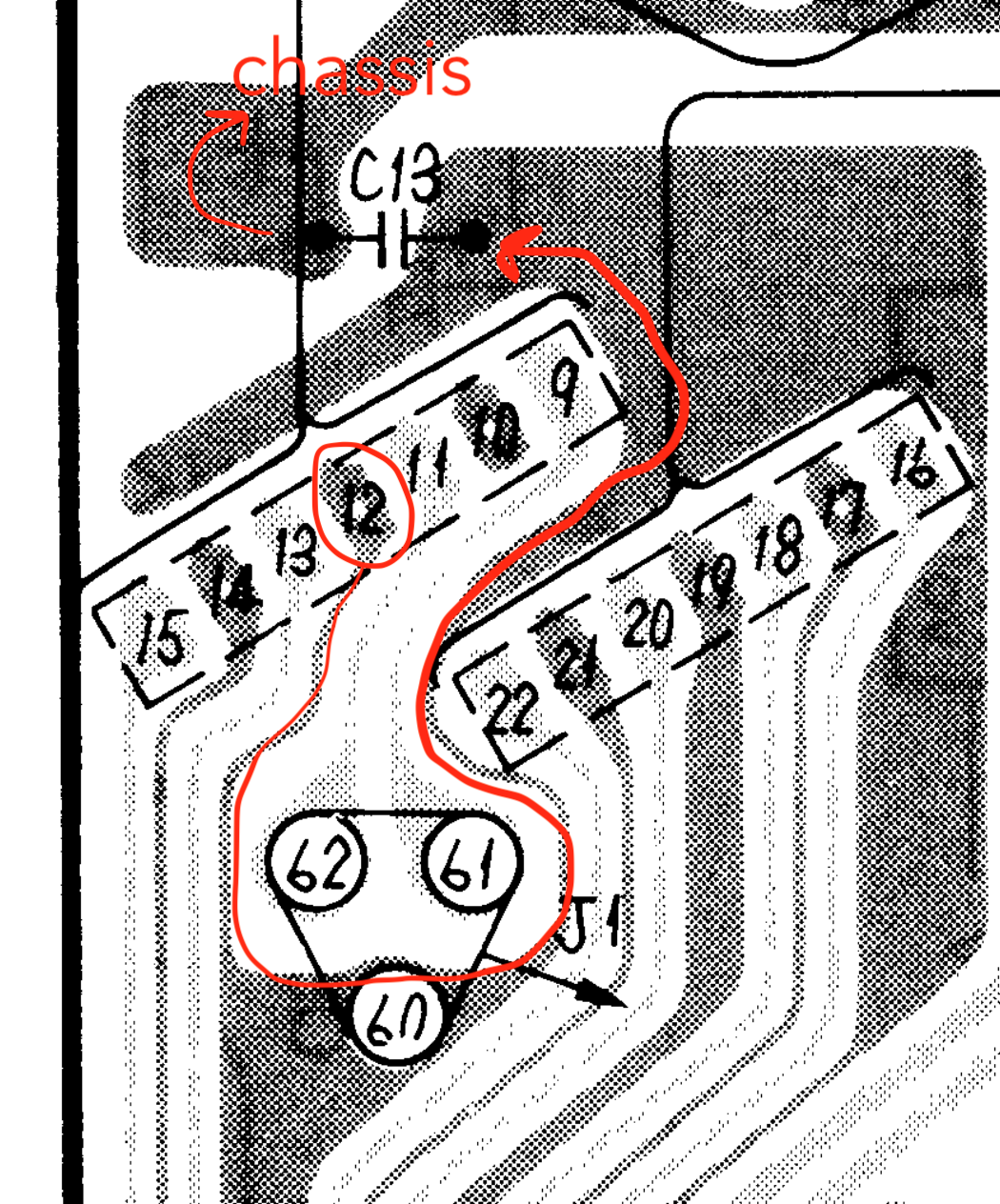

Ok. Not at home right now, but I'm checking again the service manual and I found this:

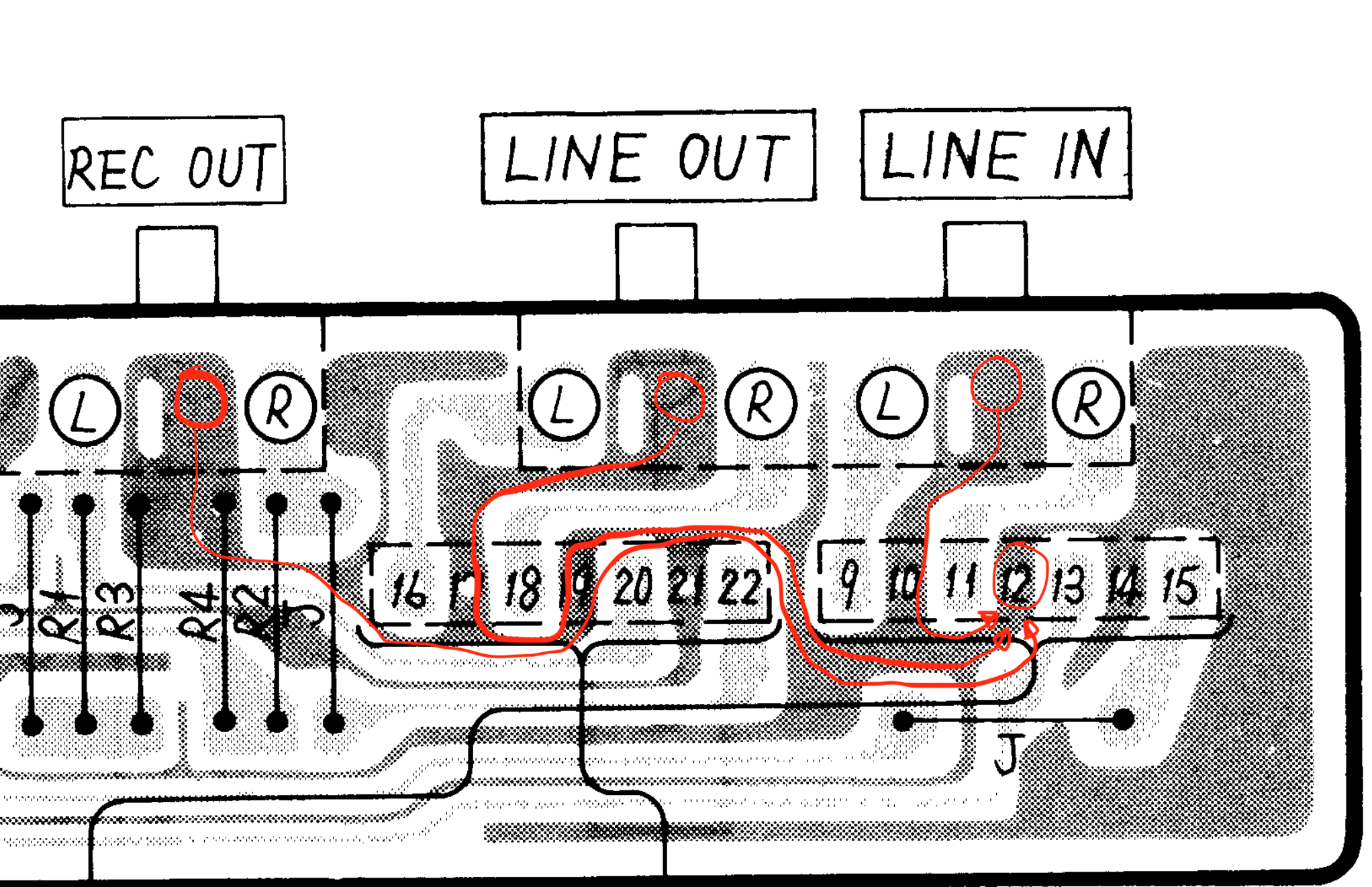

Every Output and Input ground goes directly to pin 12. Pins 17, 19, 21, 10 and 14 goes nowhere. Then:
From pin 12 goes to first leg of the capacitor. Then the other leg of the cap goes to chassis.
So I can assume that the Output & Input grounds are connected to chassis via C13.
So i guess the polarity of this cap is irrelevant whether it is ceramic or electrolytic.

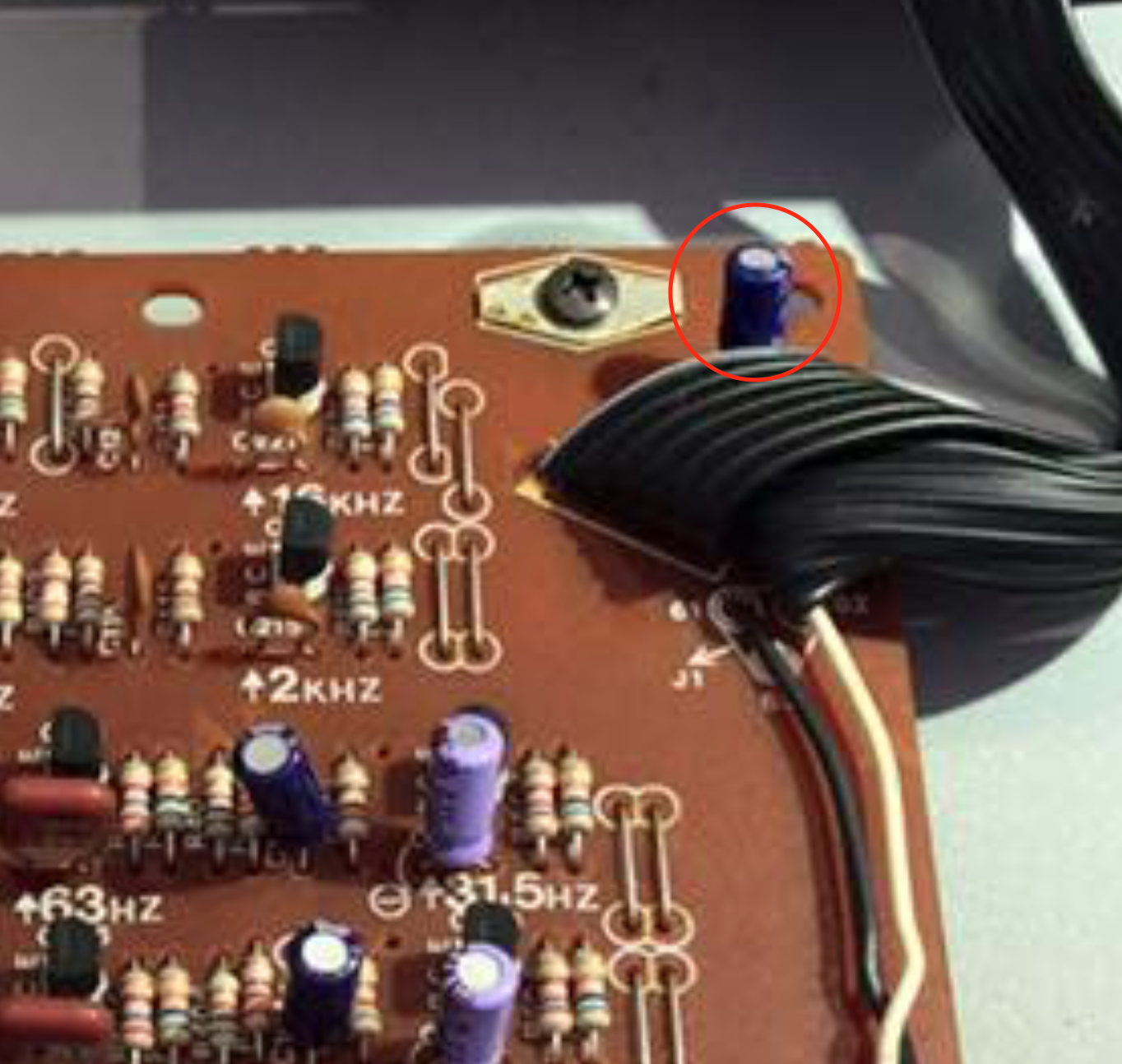

I found this picture of the same cap (using an electrolytic one instread of ceramic as the Service Manual says) and the negative leg is facing the chassis. So problem solved.
