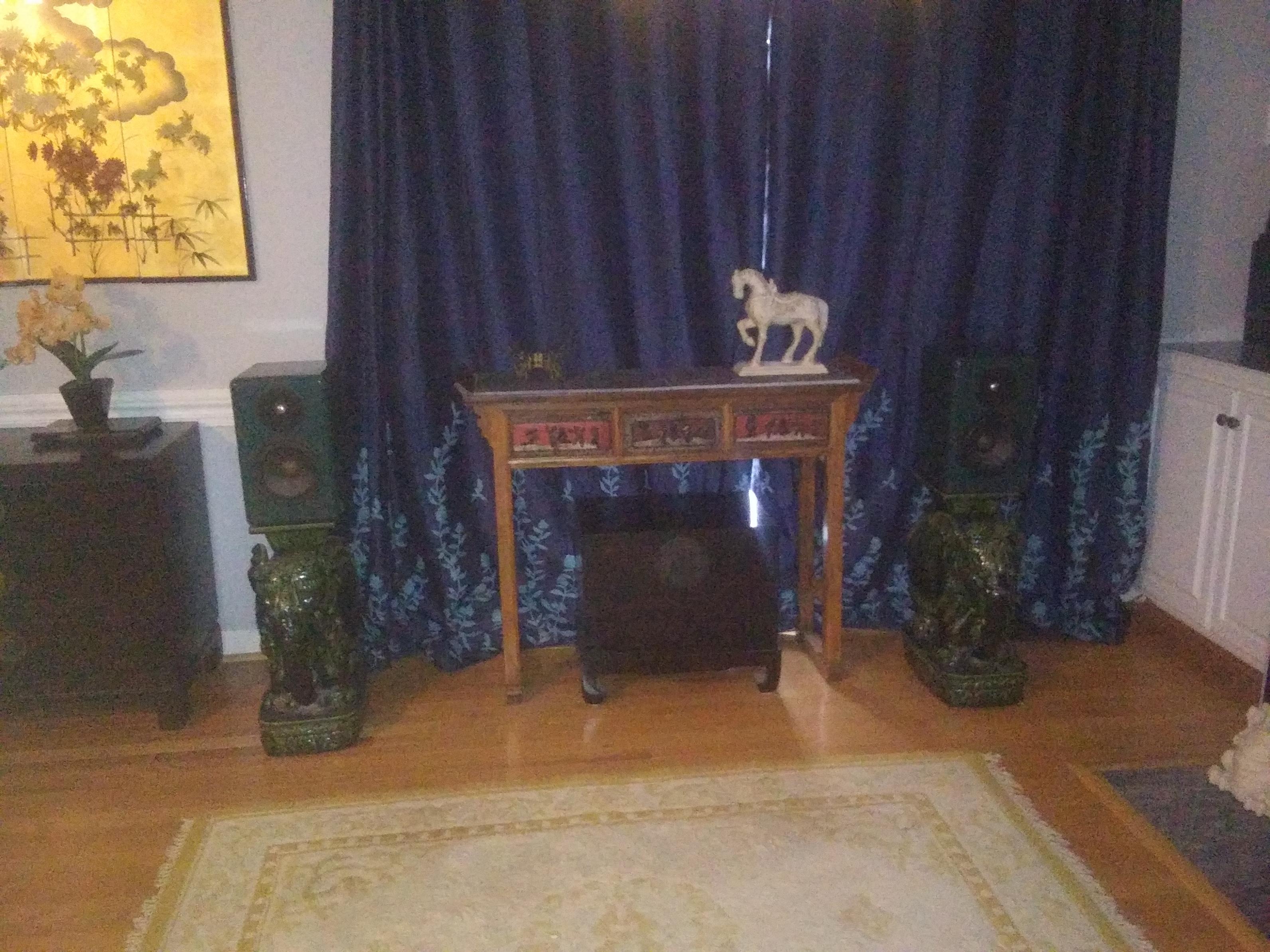

That said, My XLSS subs are 1/2 birch ply inner, 1/2 MDF core, with 1/4 oak ply on the outside. Heavier than I can manage any more, but dead as a doornail. Only using one now as this house just did not have room for the second. Yup, the Chinese chest is the sub.
