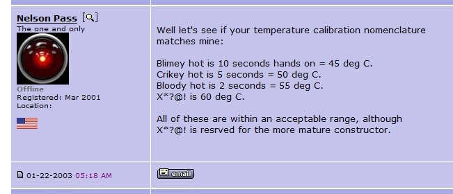

Unless you can't put your hand on the sinks, I would say there's no rush.

I can't leave my hand for very long, i think it's more than 60
I'm going to go to a repair shop as soon as possible.
