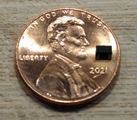

Question for those who solder SMD components. (Surface mount.)
I want to try the soldering paste method, and notice that the paste comes in different temperature ranges. I wonder what you all would use for transistors that are approx. 2.9 mm x 1.4 mm? And if you have any other tips or suggestions as to what equipment you use, that would be appreciated also.
Here's a pic of one on a penny:
The short version is that it usually doesn't really matter, especially with small devices. The lower-temp stuff is easier to make sure it all reflows, and will allow you to assemble a board with some larger components that would otherwise resent higher temps... but the low-temp stuff is often not lead-free, which may or may not be relevant to you.
For a board with a few passives and semiconductors only, no really large items like power inductors, you can use pretty much any grade of solder, up to the lead-free high-temp stuff. Datasheets for each component will give a suggested temp profile, and a max temp. Obviously you need to stay below the max temp for every component present, and you want to obey they pre-soak times for larger components so as to avoid thermal stress.

okay its only a sot-23, don't bother with solder paste, unless you have to solder a couple of hundred.
Solder paste is too fiddly for soldering a couple of sot-23 transistors, just use small diameter solder, around 3mm will do and a fine tip soldering iron, it will take a few seconds to solder.

I will be doing several hundred. (Possibly, several hundred per month.) I was thinking that the paste option would allow me to do more of a production line type assembly technique. But also, I'd like to try the paste/hot-air style just for the sake of learning it. I am micro-min and SMD formally trained. But the training was oriented more towards single component repair/replacement, rather than production line.
