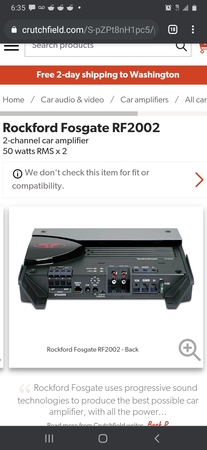

Thank you for the response. Heres a picture of the car amplifier I'm working with. It has a standard (as far as car amplifiers go) rca connection with one positive and one negative, like what will come out of the line output converter. So I dont believe I need the RCA Y cable like you would on some of the home theater style amps or powered subs.
