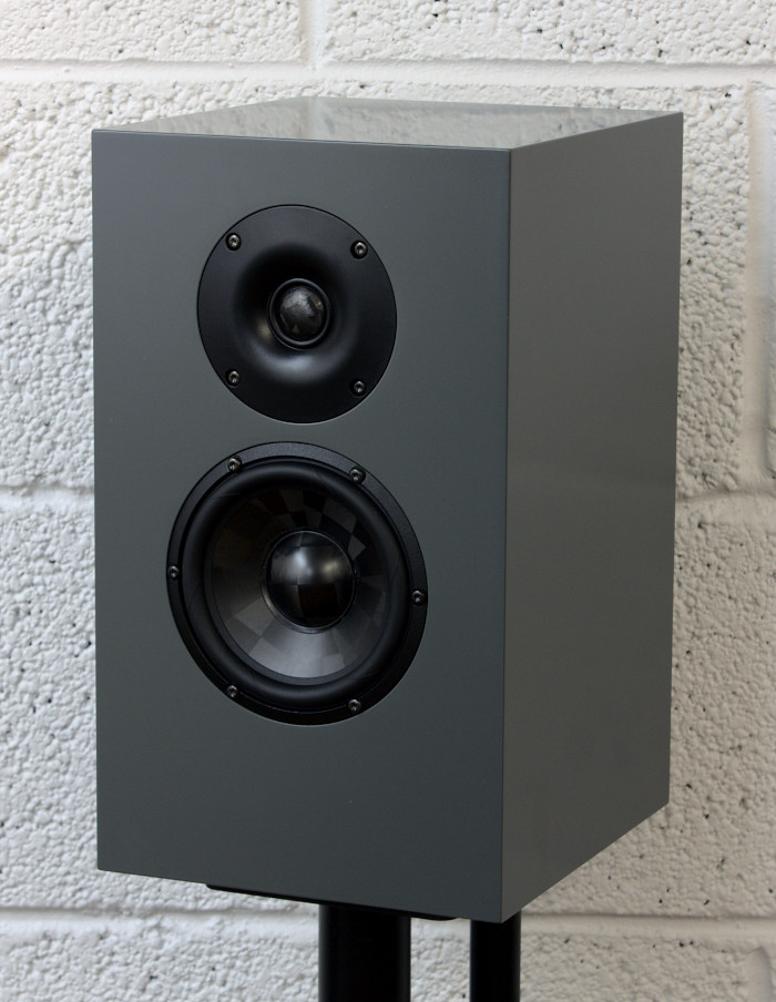

A few days ago, I came across the SEAS King RO4Y MkIII speaker kit and it seems to almost fit the bill.
On the surface, it looks like the most bang for buck that it is going to get for my application (a 3k kit that potentially rivals 10k+ speakers?).
I am of course aware that it is not exclusively the price that determines the value of a pair of speakers for ones application (the specifics matter: components, room, usage, etc), so I am unsure wether or not this Seas kit is my only good option and if it is even a smart idea to begin with.
For reference, I am in a rather small room 4mx3m currently, though it is pretty well treated with very dense absorbers and for what its worth I am getting a very good response with my (of course considerably smaller) Adam T5v monitors. Also note that this is not the room I will be staying in as I will most likely move to one that is a little larger in the near future, if that at all adjusts the equation.
If I had unlimited money I would probably buy the ATC SCM25 Pro monitors as I love their sound signature (clear, natural and forward mids with little distortion), but I simply cannot fork over the 7k (used price that is) they cost, so I am essentially looking for a similarly performing speaker that would fit my budget a little better (around 3k).
I would be very thankful for more experienced people to give me some sort of guidance as to what would be best in my current situation and if DIY (or building a kit) is the best option to go with, or if I should simply go out and buy a used pair of Amphions, PSI's, or other higher end speakers that fit my budget.

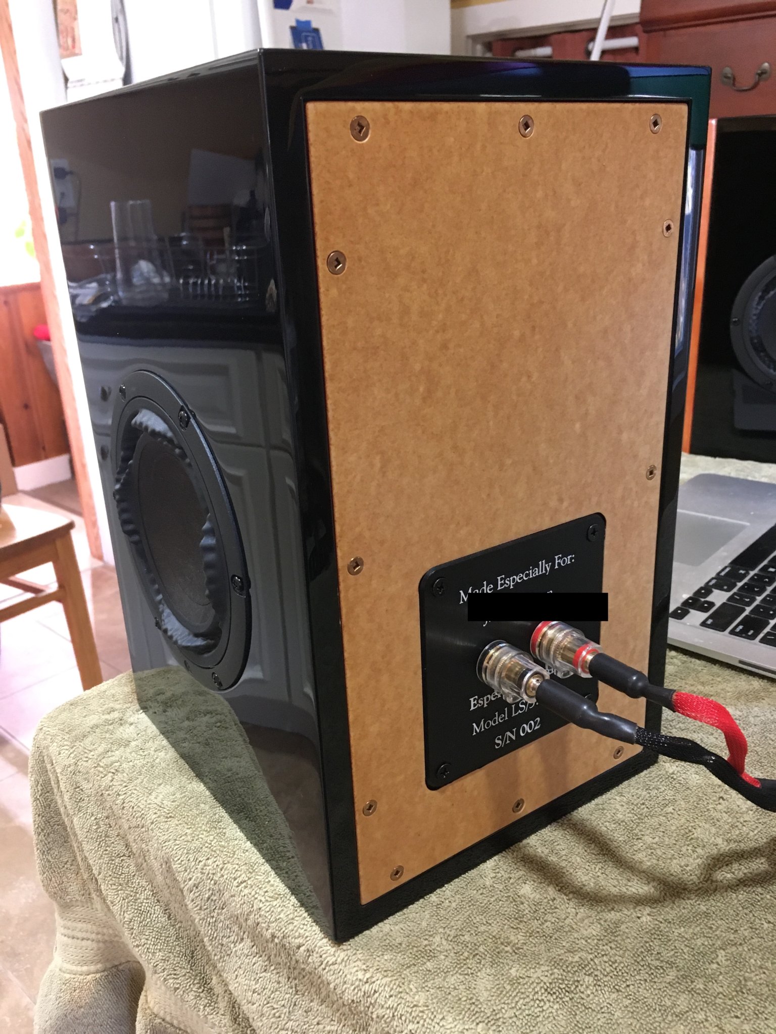

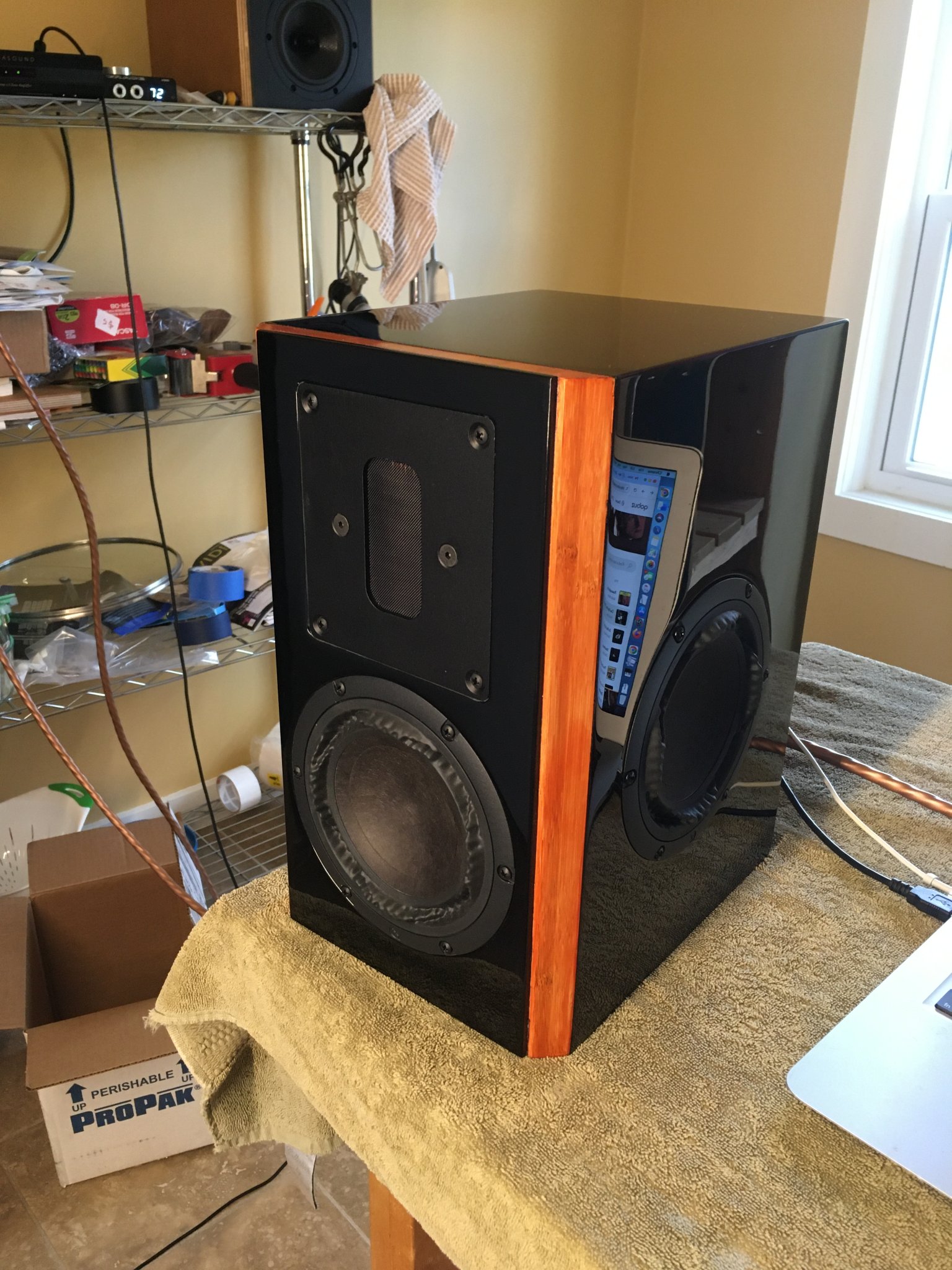

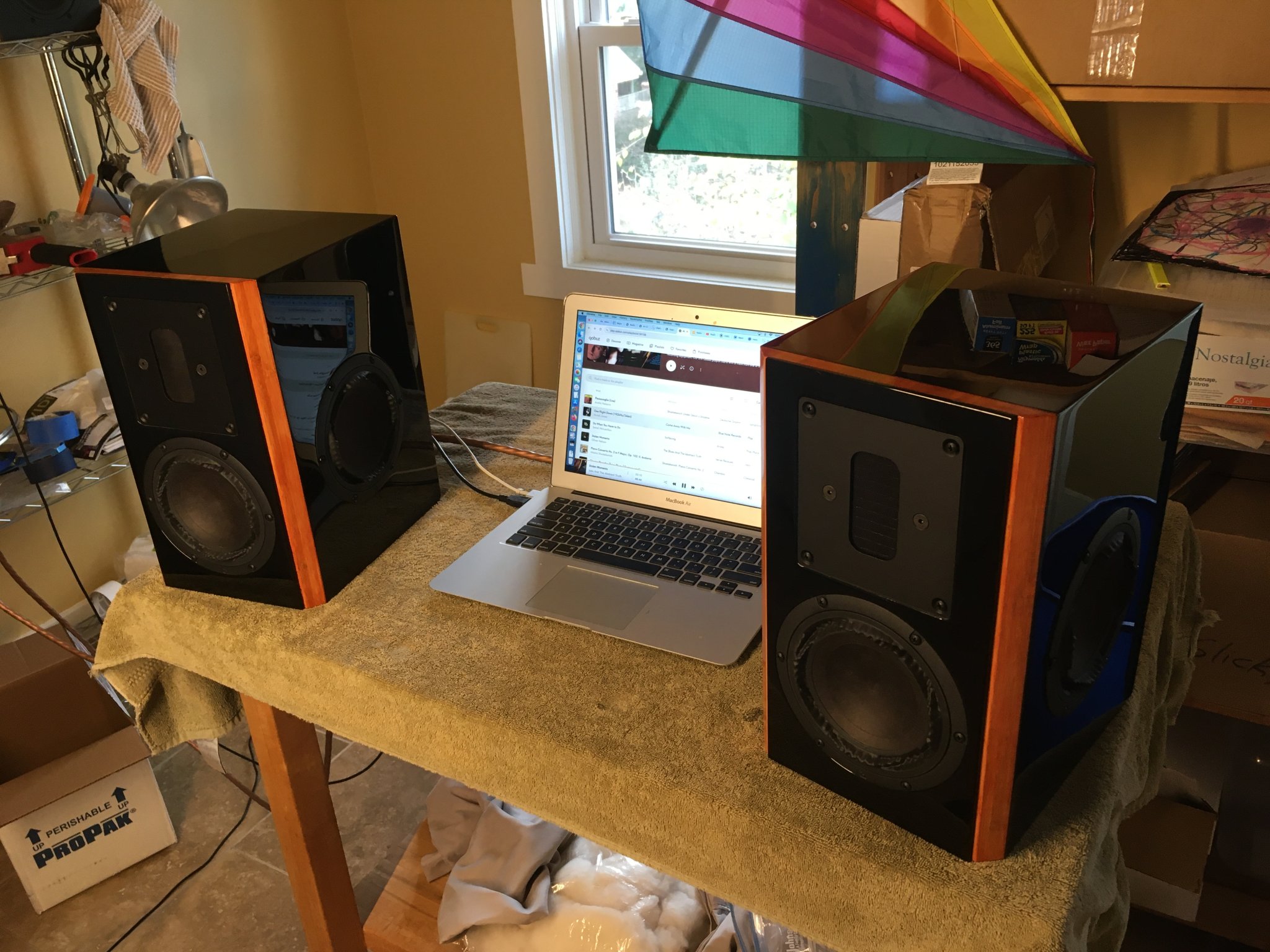

I attach a few photos of my most recent project, which went through four generations... going from a ported two-way with Woofer A and Tweeter B, to three generations later, Purifi PTT5.25 woofer with 2 Purifi Passive Radiators per box, and Beyma's TPL-75 3-inch AMT Tweeter. (Generation One is up on the right of the wire rack.)
You can knock off/copy my final design with a generic box build... generic, because my customer opted for Richlite cabinets with violin varnish (7 coats) on the front-panel edges, and the rest of the cabinets done by Steinway & Sons' outside contractor for "special" piano finishes, such as hi-gloss Danube Blue.
You do not want to know what all that cost.
The rear panels are held on with Silicon Bronze wooden-boat-building screws. Execution of my cabinet design was by Corwin Butterworth, who studied at the world-famous Rhode Island School of Design Furniture Department.
All you would have to do, is the crossover design. BTW, the PTT5.25 has the same magnet and motor system as Purifi's 6.5, so that was a no-brainer for me. 30% more "Push."

As impressive as the SEAS King RO4Y MkIII is, I have a few issues with it. And, it's perhaps a bit much, for nearfield monitoring.
HOWEVER, SEAS has a new driver I have not heard (US Hobbyist cost, with sales tax and shipping, circa US$1000 per matched pair); but it fascinates me, because it is one step more advanced than TPCD: "MetaModal TPCD."
It's a 5.75-inch woofer mid: W16NX005. A/k/a E0115-08. EVEN BETTER, SEAS has offered as Freeware the plans and miniDSP programming for a 2-way sealed box (14L). The "Lucid."
By my calculations, the SEAS W16NX005 has 50% MORE "Agility Factor" than the Purifi 6.5.
Yes, its bass rolloff is 10Hz higher than the Purifi 6.5's; but SEAS's stock "Lucid" DIY recipe is active DSP. (SEAS also offers plans for analog-parts Xovers.)
