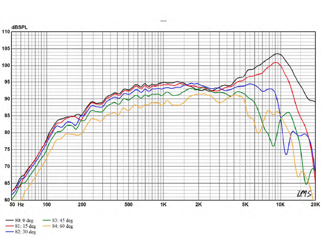

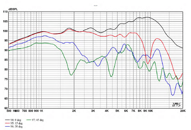

I have some problems interpreting the frequency graph of the LM10. I'm looking for about 94dB sensitivity from ~600 Hz to 5 kHz. As far as I can see, from the vertical dispersion graph the LM10 seems to be the answer to my needs, but the horizontal dispersion paints a different picture, only touching 95dB at 1 kHz and dipping again between 1 and 2 kHz. How can horizontal and vertical dispersion graphs, both at 0 degrees differ so much? Am I overlooking something?

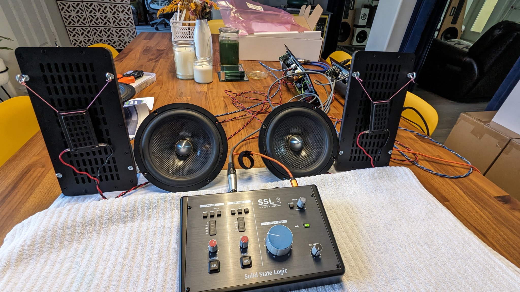

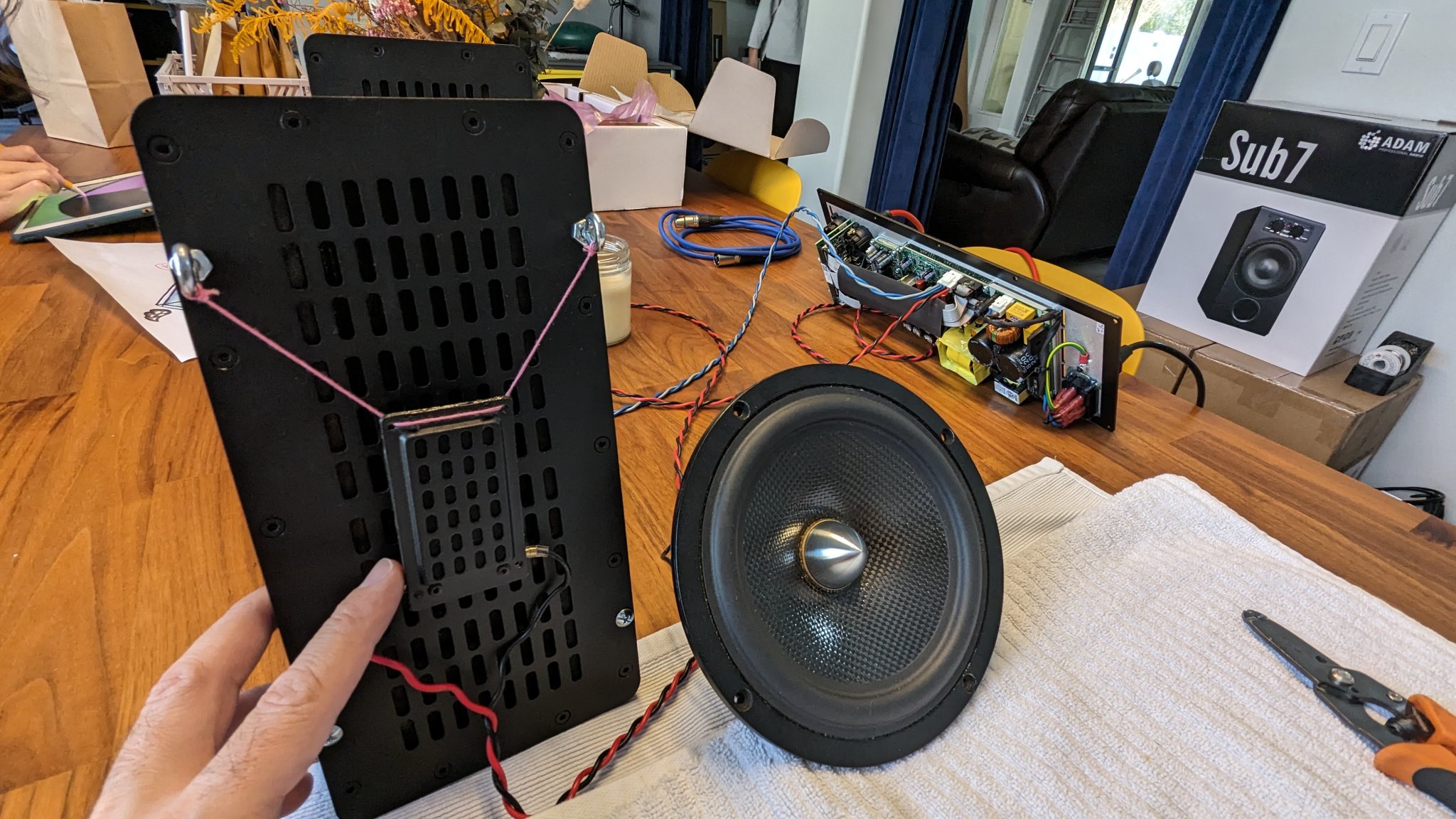

Been messing with mine a bit. I'm in the early stages of an ultra nearfield listening chair system. Trying a homemade coaxial configuration using the little Radian LT2. A week after I bought the LT2, the improved 2.2 came out. I'll likely get that, if for no other reason than the cosmetics of them match the LM10n better. Nothing seriously measured or configured as if yet though.

looked through your thread just wanted to ask is the trebble driver definitely needed in your opinion ? I was hoping to use the lm10n as a mid/tweeter I thought the response carried right on up or is it a dispersion issue ?
