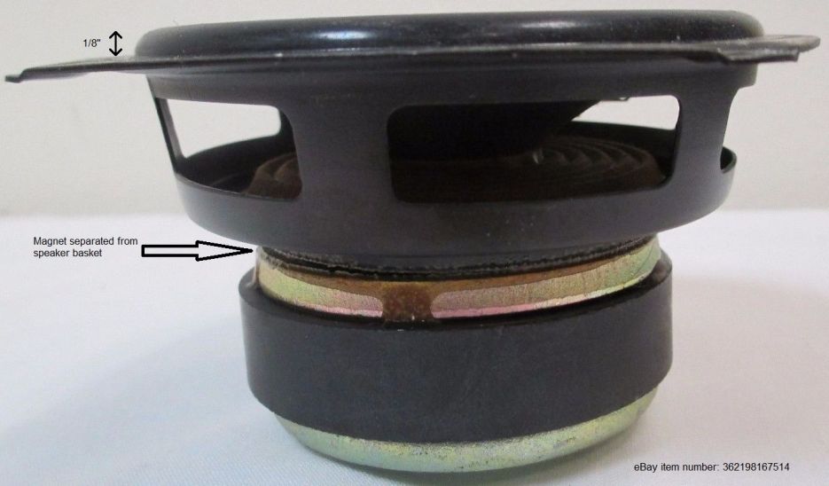

To restore one of my Minimus 7's I bought a raw woofer on ebay. It didn't go well because the speaker was not packaged appropriately for shipping. The problem is the speaker surround extends beyond the metal frame and needs to be protected from external force. The speaker enclosure naturally does provide protection but a raw driver is exposed. Request special packaging if you have woofers shipped to you.
Thank you for the heads up. I have a couple of the 7W cast models in my garage that I may end up stealing from. But we will see. I would like to keep them as complete as possible. Nice little speakers that work with a bluetooth amplifier. Finished a project for my daughter not too long ago. Pink paint was what she asked for.To restore one of my Minimus 7's I bought a raw woofer on ebay. It didn't go well because the speaker was not packaged appropriately for shipping. The problem is the speaker surround extends beyond the metal frame and needs to be protected from external force. The speaker enclosure naturally does provide protection but a raw driver is exposed. Request special packaging if you have woofers shipped to you.
