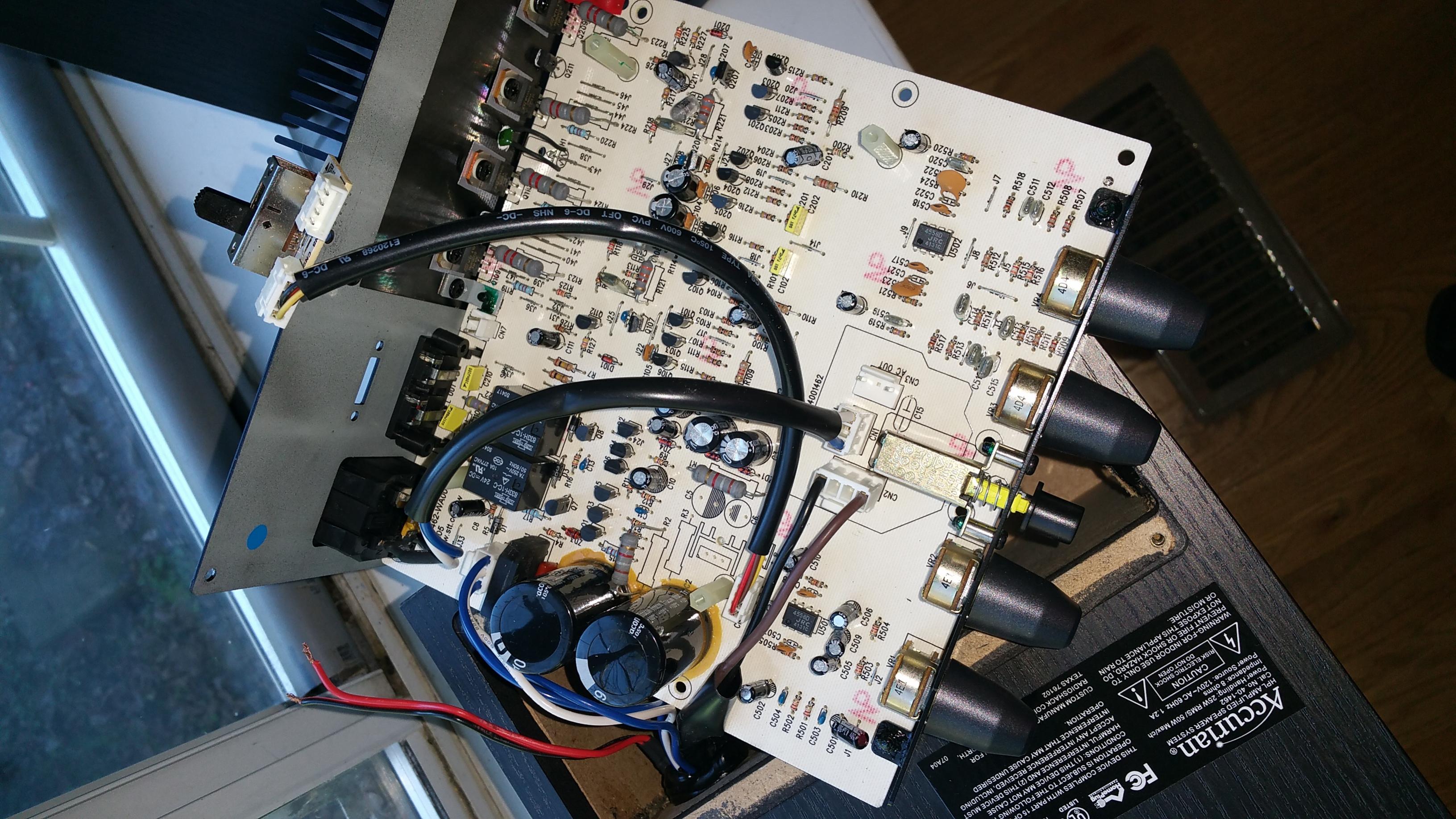

my dad cut the red/black wires!
I think I can add a 3.5mm line-in port to replace the switch (top/left), according to directions here, but my Dad removed or cut the red/black wires that run up inside the enclosure. He was using this as a passive speaker, which was a shame.
Any idea what or where the red/black wires should connect to? if the wires went into a plug that was attached to one of the boards, he may have just cut the plug off the end, and if so I don't have it currently. Small chance he may have saved it, but doubtful.
Any help would be appreciated.
I just pulled out the amp to mine, and the red/black pair go to a 2-wire connector on the main board near the back that is labeled SPK on the top and CN7 on the bottom. You can see the CN7 in your photo.
