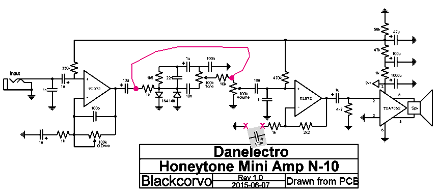

So the RS Mini amp has been MIA for years and only expensive old-stock on FleaBay... I mean $60 isn't going to break me, but then I came across this mini battery powered guitar amp sold at Guitar center for $23. Reviews seem good and I watched some videos on youtube about it.
Any comments on this thing as a suitable replacement for the old RS Mini Amp as a testing device for hobbiest amplifier service (Car audio amps)?

Do you truly remember the Radio Shack Mini amp?
It wouldn't launch your guitar-hero career. It was hardly adequate for wire-tapping.
If so, if the RS MA would really work for you, this is probably 2 cents "better", especially if you (if you can!) bypass the middle bit.

I can try. Apparently the board is all smd though. I’m picking one up Friday. I see where you by-passed the tone section. There is also an overdrive section near the input as well as that one cap to ground getting cut out. To be honest I may try it as is out of the box first to see how 'bad' the output tone looks on the scope when putting this inline with a frequency generator. Mainly the purpose of this device is to follow low voltage audio paths, but I also remember using an RS Mini amp to find fuzzy OpAmps or causes of them on amplifier PCBs. It was handy but not hardly a 'pro' device.
I also thought of maybe going to some old computer repair shop and try to find a single battery amplified speaker there. That would probably do just as well to be honest. I do remember the RS Mini amp had a rather HUGE gain and sensitivity though.
PRR,
From your changes to the circuit:
You after removing the 470nF cap, it is just open?
or is ground reconnected, but now it only has the
removal Xs. ?
Without that tone pot for guitarists to fiddle with
they'll be forced (limited) to the tone pot on their axe.
But then if this little bugger over drives into clipping
there probably isn't much "tone" in that pot anyway.

I found this site with some just -ok- pictures of the insides.
Danelectro HoneyTone Repair & Modifications

...Without that tone pot for guitarists to fiddle with they'll be forced (limited) to the tone pot on their axe......
I thought this was about signal tracing??
I wonder if bypassing the tl072 on the left would help. I bet it would shake the house with clean vibes then.

So I got this HoneyTone today. Seems it'll be alright for testing. its got a bit of a hiss at high volume but I'll get used to it. One thing I may do is install a tweeter somehow so that I can hear the upper range better later on. For now it'll be just fine without modification.
