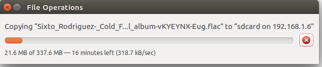

It's 10MBit/s only. 🙄
That caveat was noted...😉

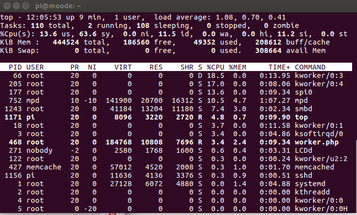

Although the gpio ethernet is limited in throughput it seems to work fine for the web interface and webradio streams.
I was getting dropouts in web-stream audio while the ethernet device was maxed out.
However, without doing file transfer at the same time then the web-stream , ssh , and web-interface have been very stable and usb playback is reliable...🙂
For my use it is more than acceptable,,🙂
