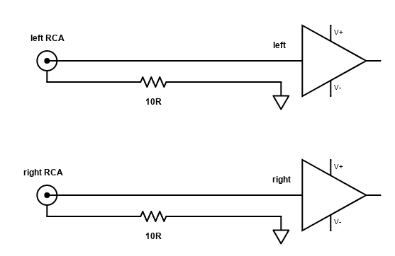

I'm working on a LM3886 amplifier, and I have it working and it sounds mostly great. But when I put my ears up against the speaker, I can hear a little bit of what sounds like faint power supply noise.
I've been messing with the grounding, but I can't seem to nail it.
Right now for testing I have two RCA inputs that are isolated from the chassis (verified with a multimeter). These go to two different PCBs representing the right and left channel. These are connected by two 2-wire twisted pairs. If I don't tie these to ground within the amplifier, it doesn't sound good at all. If I tie them to ground at the power supply caps, it sounds good, but it has the faint hum with my ear up close (this is the current configuration). If I take one channel and ground it instead at the speaker gnd of the appropriate channel the hum goes away and it's totally quiet. If I do the same with the other channel though, the sound gets worse. The RCA cable source is my iPad using a mini audio connector cable that splits into RCA.

Instead of the ground wire from each RCA, use a 10R resistor connected to the audio ground.
This will defeat the ground loops.

Never fail to connect the input RCA ground terminal, that would considerably increase noise.
The usual practice is to run a twisted pair from each input RCA to each amplifier input stage.
Then just add a 10R resistor in series with the RCA ground wire, in both channels.
Like this:

Not like that, just go by the drawing.
The resistor is in series with the twisted pair ground wire (not in parallel).
If the wires are short, the resistor can take the place of the ground wire entirely.
If the wires are longer, you can add each resistor in place of part of each ground wire,
but still in series with the ground wire. Look at the drawing.

So then you're saying don't connect the RCA ground terminals with any internal ground? Just run the RCA shield terminal ground, in series with a 10 ohm resistor, to the amplifier and use that as the input ground?

Yes, that's it.
For example, the ground wire with the resistor, could go to the same point where the feedback loop goes to ground.
But if these are pre-made boards, there should be marked pads for the input ground wires that should be fine to use.

Yes, that's it. Can you post photos of the RCA sockets and the amplifier input board to confirm?
It's my board, so I can change it as I see fit 🙂 Right now it has JST-PH connector for the input, with one wire for the signal and one for the ground. This ground is completely independent from anything, and not connected internally to anything in my amplifier. So my only question was if I need to connect it to my amplifier ground as well, or if the RCA jack ground is enough for the input side of the amplifier.
RCA socket is isolated, and it has a ground lug and the center signal lug.
Your amp has other pins and parts connecting to an audio board ground point.
The input ground wire with resistor should go there. Post your schematic here.
All circuits must have at least one loop. The input ground wire is part of that loop.

Ok, but that's what I asked above, and I thought you said not to connect it to the amplifier ground. If that's the case, I'll tie the RCA ground also into my low signal ground. Isn't there a loop with the source though? I.e. if I play music using an iPhone via the RCA cables, isn't the ground wire supplied the loop for the audio input?
Yes, that's right.
You don't want an audio loop to be completed by an external ground circuit through the power line.
This is what happens when you don't connect the RCA ground lugs. That will always add noise.
An external source, floating or not, will work as part of the loop, if the interconnection is properly shielded
