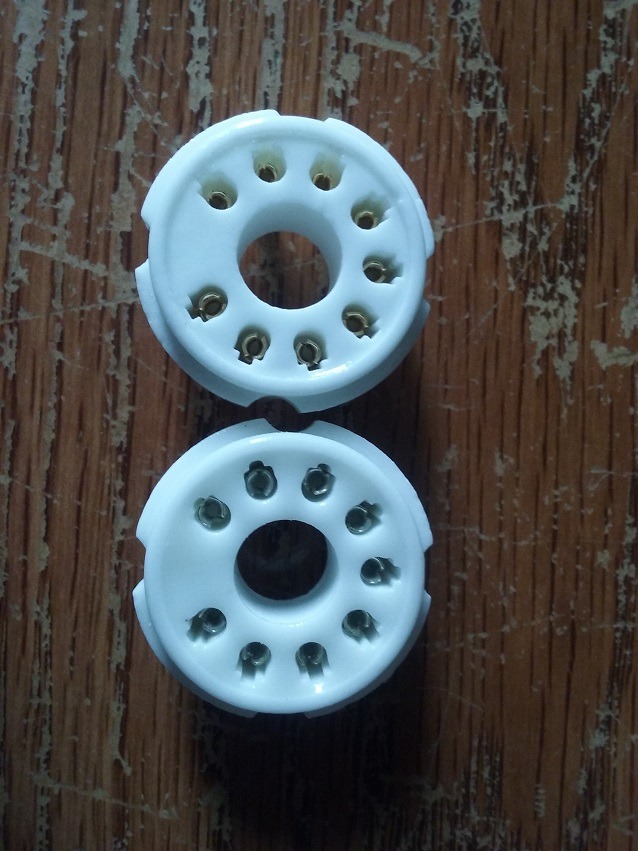

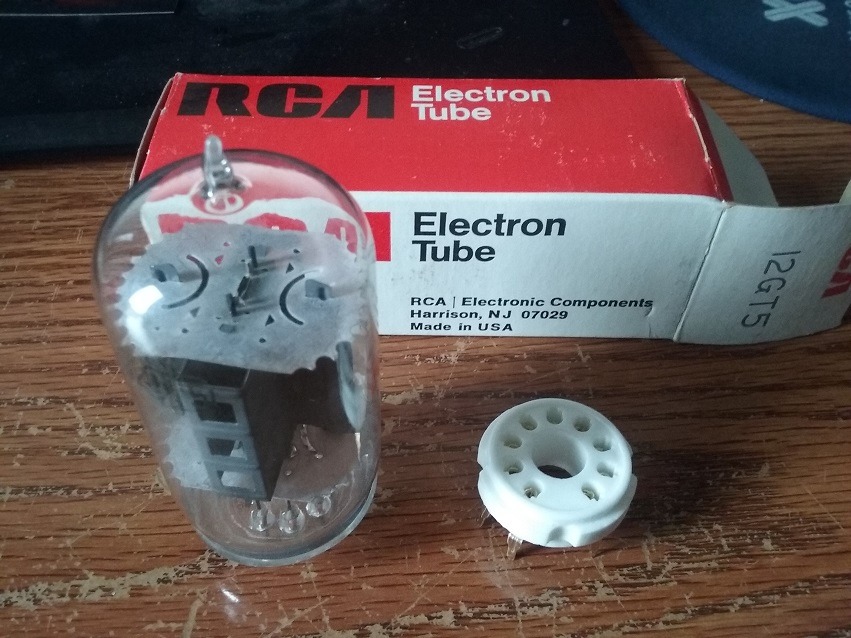

Received shipment 100pcs of Big base 9 pin equipped w/ 1.0mm pin sockets ... Am ecstatic to report that they are CORRECT!
First trial fit into 12GT5 was a bit tight- but relaxed to normal after 3 insertion / removals.
To abbreviate design thesis- install Compactron pin sockets in Magnoval bases- The End...
To give credit where it's due- 'smoking amp' gave me the idea, I just followed thru and made it happen on the production side-
Pic #2 shows silver pin Magnoval (1.2mm) socket next gold pin (1.0mm) Novar hybrid. To accomplish this would seem easy, but there were hurdles-

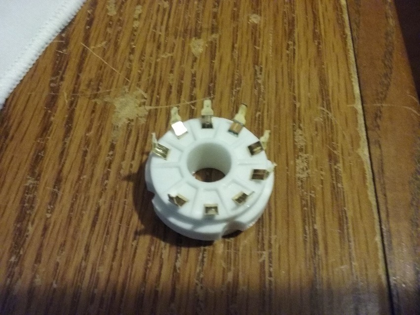

Received 100 count of these set up for PCB mount, pulled and tested 5 random pcs- all had w/ uniform feel...
Bit tight at first install w/ 12GT5, but loosened up after 3 insertion/ removals that feel normal to me

I think you can use these PCB sockets for chassis app's if remove brackets from these:
https://www.ebay.com/itm/223447901457
Adds $1.85 each to socket purchase, but still a lot cheaper than $8.64 each.

Any chance of having some of these made that are chassis mount rather than PCB?
The PCB sockets shown in post #1 dp have the shoulders needed to use a chassis mount ring. You just wouldn't have eye'd solder lugs, you'd have to J-hook the PCB pins I guess.
