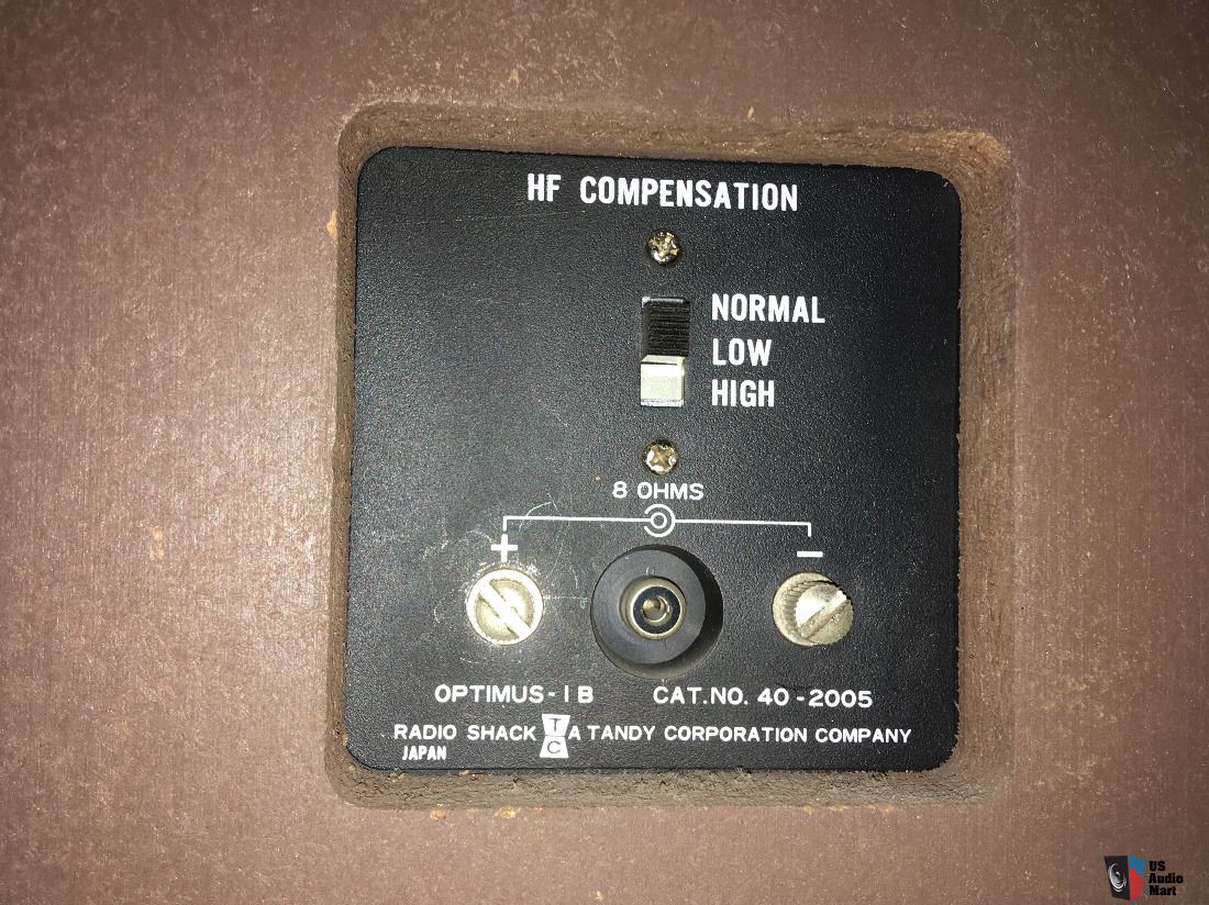

Was donated a pair of these today, Crossover attached
The woofer (2519Aa Japan) looked promising with a low Fs & Qt, parameters:
Fs 20.75; Re 7; Qe .38; Qm 5.53; Qt .35; Vas 142.38; Sd 314; Le .84; eff 87.6
did some sims, Woofer looks good in 60L (Optimus oix is 38L), tuned to 22Hz
all this fun & I haven't listened to them yet....
The Big Q: Do I restore them to original, or 'improve' them to my own taste....???????
Bugger, just realised I left the tweeter switch out of the xover diagram, give me a few minuets....

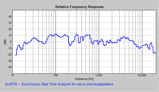

Q&D RTA plot attached (taken in a small & cluttered room)
How do they sound? - Very well balanced, to my ear anyway, good on Jazz, and a surprising amount of solid lows on Rock, punchy kick drum. Don't know that they'd handle a lot of volume, but good medium-loud

All I know is I wouldn't want to have my highs emanating from two drivers spaced this far apart - concepts like these disappeared for a reason after the 1970s. The peculiar ring around them presumably mitigates the effects of no flush mounting, but it also puts them pretty far apart. And why is the baffle so far recessed inside the cabinet?
EDIT: Highs +8/-10 dB? Oh my. Wouldn't be surprised if this changed a lot with vertical angle angle.

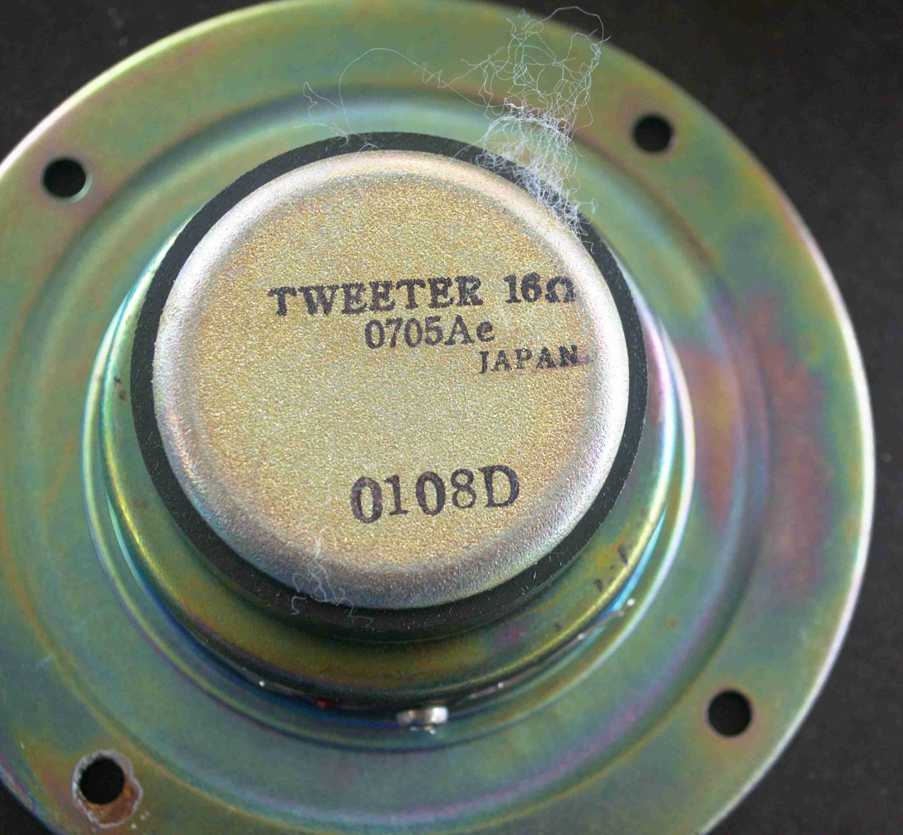

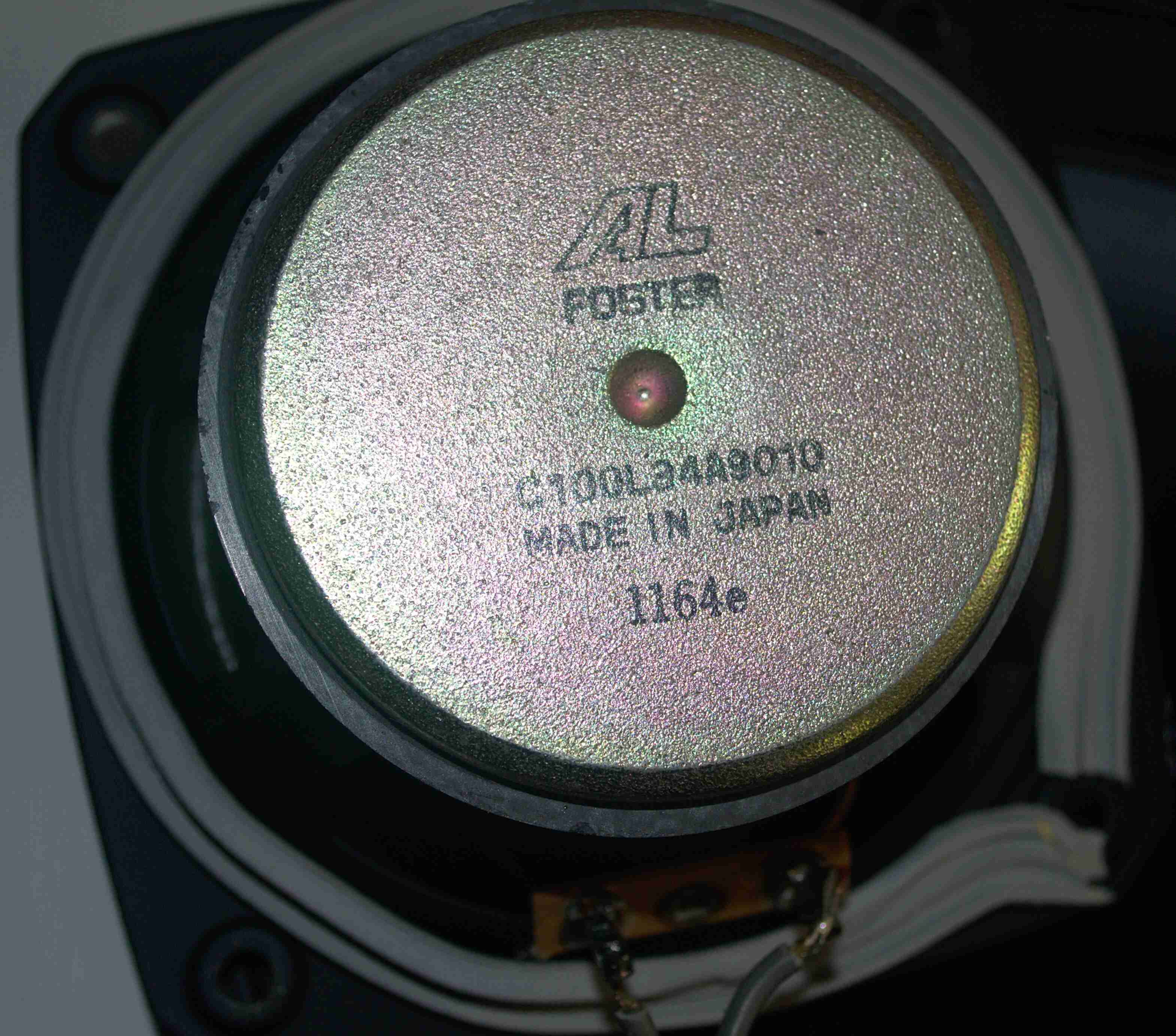

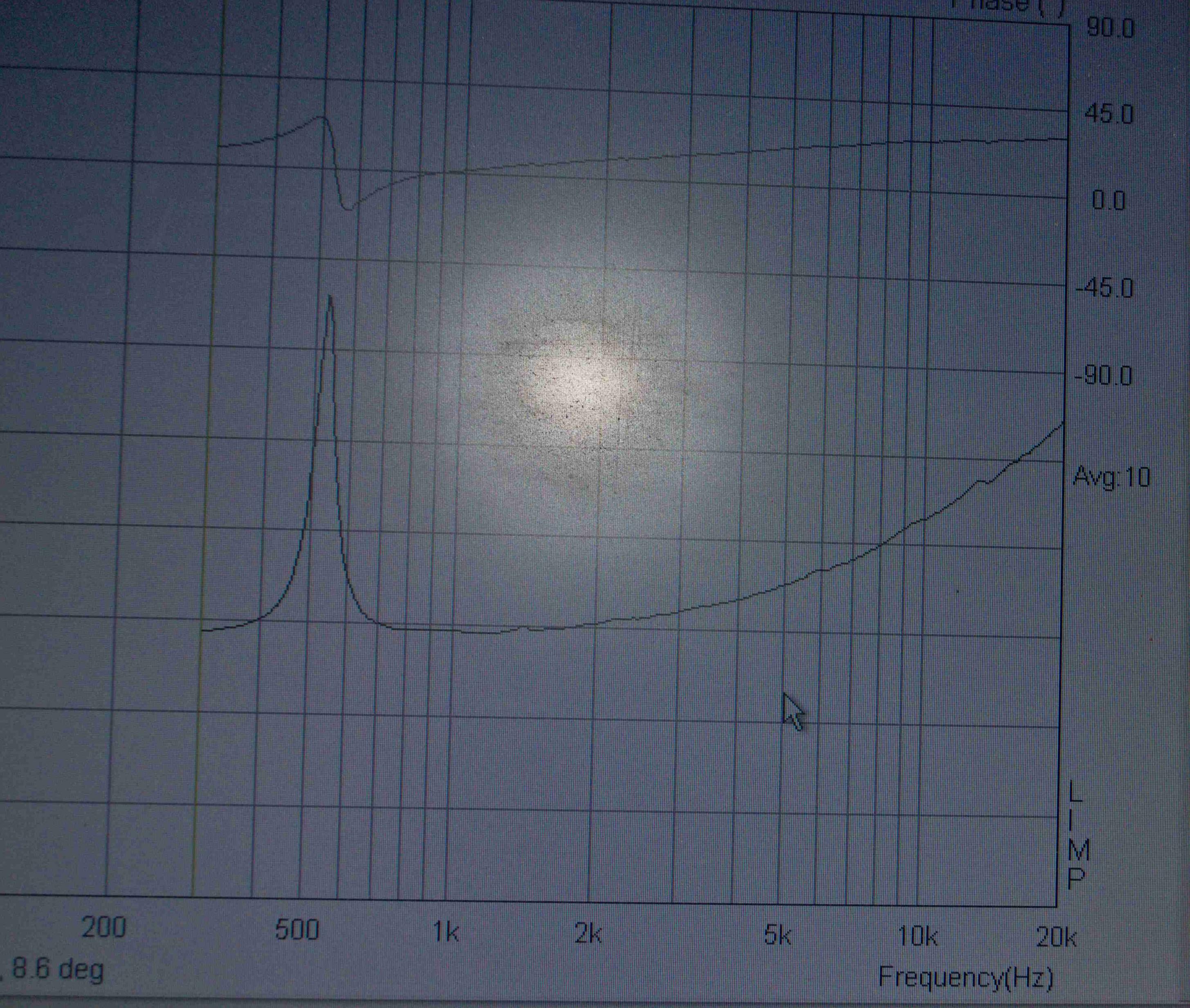

The Tweeter - Fs is 533 Hz, Re is 14 ohms, Le is .08mH. some pics attached, including a Foster to compare, typeface looks similar, bad shot of the impedance graph, which on the rough side (both the photo & the plot)
Magnet looks a lot smaller than in the 8R units I am familiar with; I guess there were many iterations of the unit over the decades. Supertweeters are there if you ever want them, stupid me could not resist the clearance bargain for a buy of 10 and I have a couple of pairs left

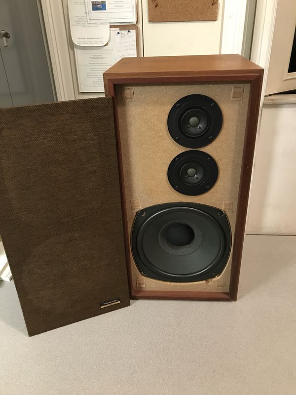

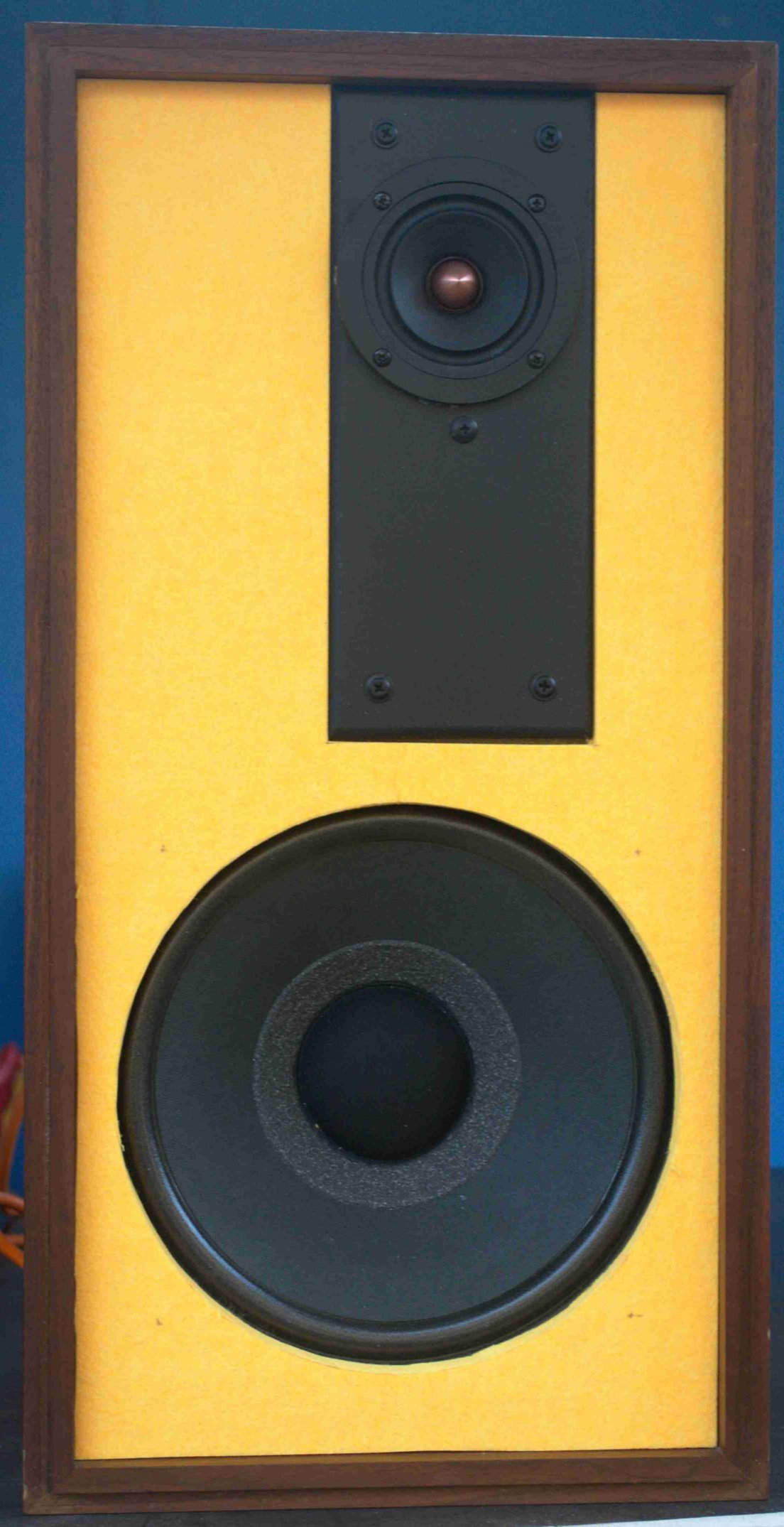

Refurbed these:
Replaced Foster mid/tweeters with a Dayton PS95

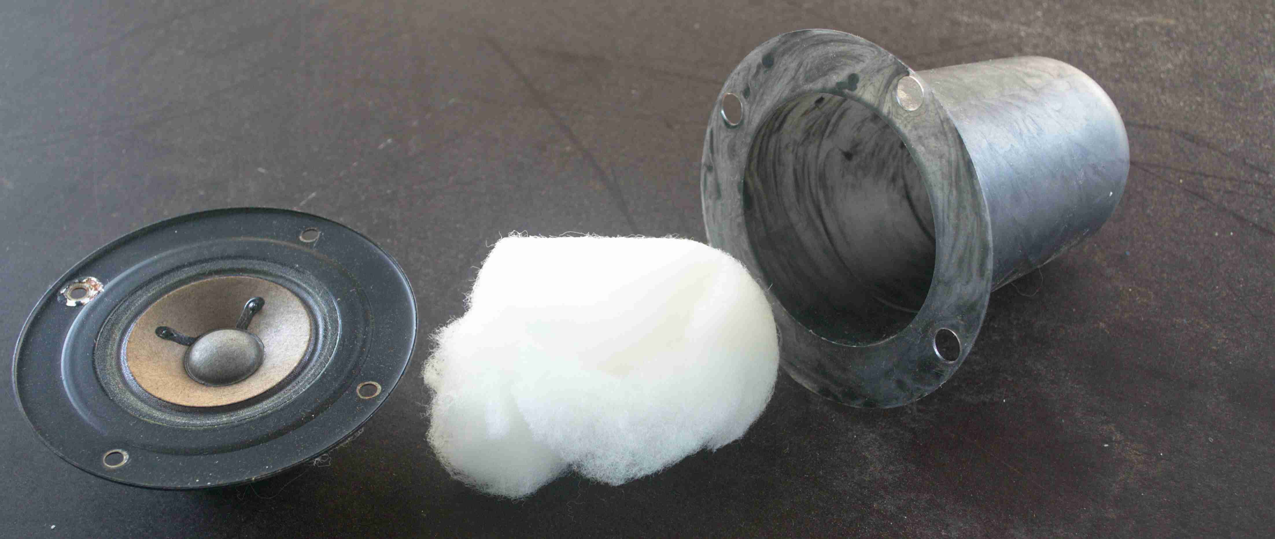

Replaced the nasty Fibreglass with Polyester from an old pillow
Too tightarsed to spend $60 on inductors, so running the woofer full range - xover ATM is a single cap
(annoyingly I have the right sized inductors, but AWG is too fine, would loose 3 precious dB if I used them)
Unsurprisingly, they have a somewhat forward sound, I'll need to put a small resistor in front of the PS95 at a minimum

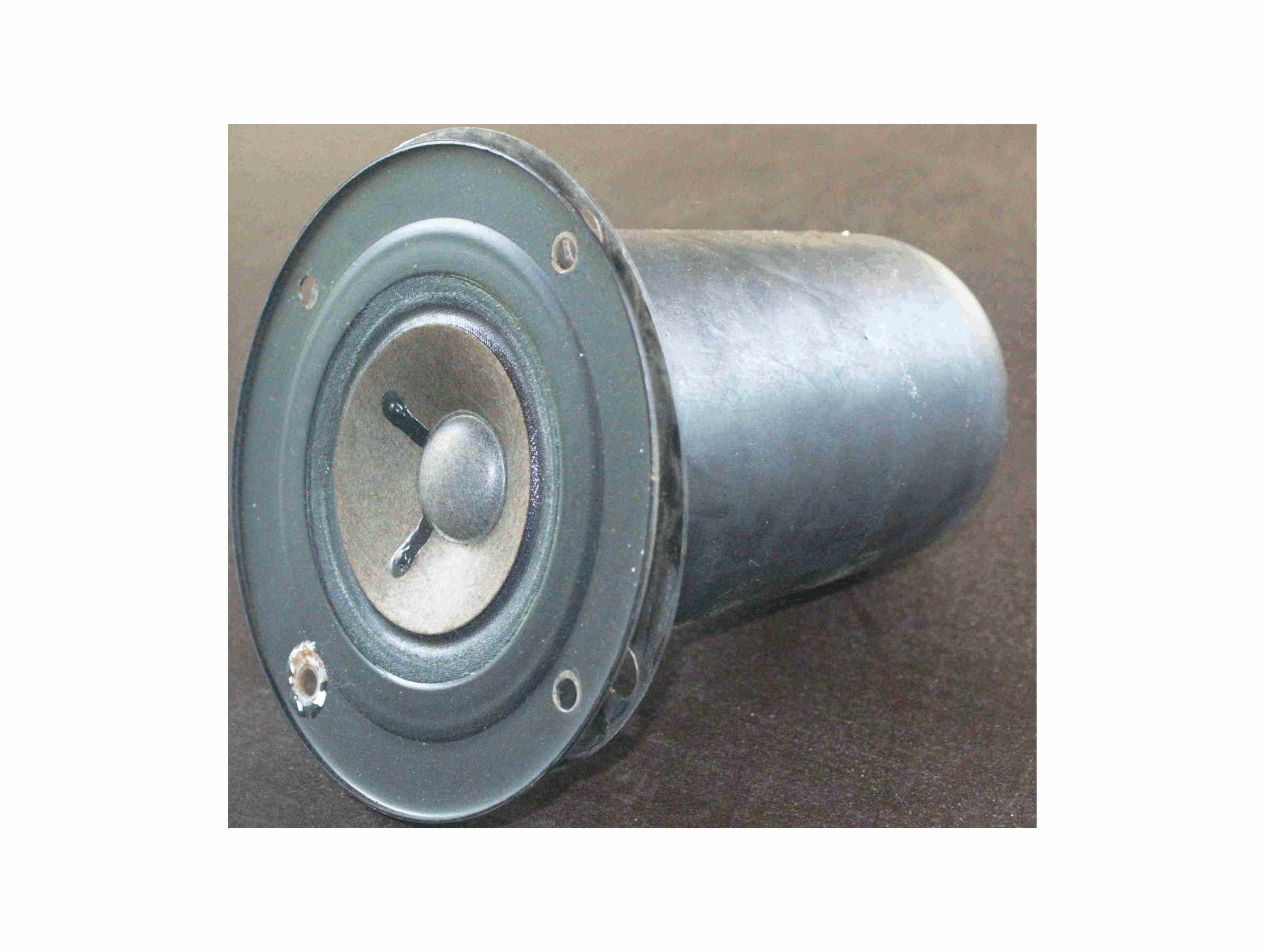

I had a pair of these as a kid (found them used for a song) and had them until they were stolen when my house was broken in and robbed in broad daylight (in Southern California, crime like this was rampant). The cabinet had a nice walnut veneer. They sounded ok but I recall the acoustic suspension made the bass rather limited. I recall they were heavily stuffed with fiberglass. The two mid tweets had their own plastic cylindrical rear chambers also stuffed with fiberglass. That was many years ago and I never knew they were model 1B’s - I remember the made in Japan designation.
