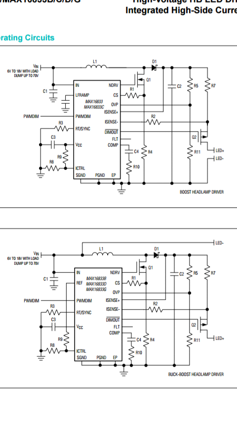

if I use it on its side.
with the output wires being attatched in this way
the loads negative is connected to the INPUT POSITIVE of the boost converter
With the loads positive connected to the POSITIVE OUTPUT of the boost converter
And by turning the pot i am able to buck AND boost with this supposedly "BOOST-ONLY" DC-DC converter with great efficiency
Only quirk is the voltage jumps up a bit when you detach the input power supply (with a very small or no load on the output)
How is it possible that this works in this way?
Its only got a SINGLE inductor.

I think this hook up method inverts the voltage that the chip sense pin sees at the voltage divider (the pot). I like it! Very useful.

Well it doesn't really change how the chip operates. but it does change how you get the voltage output of it. sometimes you'll get a voltage spike depending how good the boost converter is made. Usually only when turning it off or if its running in current limited mode. so be careful with light loads or sensitive loads.

AFAIK it's a common method for driving a led
as you wrote the output "0V" now sitting at input V+ which is bit tricky when the output connected to "something else" that have a real 0V/GND which can make a dead short
for LED it's acceptable beacuse load at the end of chain
I'd only use one output or the other but not both at once.

Main drawback is your output is not properly regulated
Any fluctuation at input will be followed by output in reverse, because Boost Controller Vfb is reading actual output (GND Reference)

What makes you think you can identify a buck/boost converter by the number of it's inductors? Actually only one inductor is needed that lays somewhere between the input and output terminals. Buck and boost converters solely are discerned by their arrangement of switching devices. So, if you place all devices that are needed for both types around your inductor and drive them properly, your converter will either buck or boost on demand.

And i'm just saying in general most of the buck/boost converters I see are using two separate inductors
so I'm just going on what ive seen. How would you get a buck boost converter with a single inductor working with regulation on boosting AND buck control?

Many kits with dual inductor usually a SEPIC Converter
Kind a "buck-boost" but different topologies
