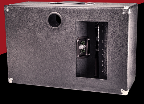

Rear vent/diffractor cab

Yeah, I agree & it's so simple it's worth trying to DIY, seen the graphic here?:

Might be louder because the their vent is in effect a conical horn, at the frequencies you're gonna notice it most.
Tried to reverse engineer it, but Celestion haven't published complete specs for the G10 Vintage. I don't think the exact numbers would matter much though...
It might, and that's certainly what the manufacturer claims. I'd love to hear a comparison and SPL measurements with a conventional cab of similar size using the same speaker in both cabs. That would tell the truth, one way or the other.
I expect the "horn" dimensions are not critical, as you say. I suspect the tuning frequency of the slot does matter, though. It will depend on the width of the opening between the two angled vanes, and the volume of the air-chamber in front of it
You could probably get reasonably close by guesstimating the thickness of the wood used in the angled panels, and comparing that with the width of the slot in the photographs and images of the CAD model. If the wood is 3/4 inches thick and the slot is, say, two times as wide as the wood thickness, you know the slot is about 1 1/2" wide...
From what I've seen elsewhere, those meaty 4x12 Marshall cabs are usually tuned to have a bass peak at roughly 100 Hz. With some fiddling, it should be possible to try to tune your reverse-engineered cab to about this frequency.
A cheap electret microphone (One buck at Sparkfun: Electret Microphone - COM-08635 - SparkFun Electronics ) and free Room Eq Wizard software might be all it takes. Temporarily hot-glue the angled vanes into place, move them if necessary to tune to 100 Hz, then glue with wood glue and/or screws.
Interestingly, the back of the 2x10 and 2x12 cabs shows a separate bass-reflex port, in addition to the diffraction slot with its crude horn. This would make it easier to separately optimize the midrange boost from the horn, and the bass boost from the port.
-Gnobuddy
Actually one of the challenges with this is to avoid noticeable horn loading because of how it messes with the tone - if it behaves like a horn there's a low pass filter effect and there tend to be horn-related distortions in the midrange. Also any loading on the driver will affect the tone out the front, especially if it's increasing the radiation impedance on the back of the cone significantly in the midrange, reducing the cone excursion and thus direct radiating output at those frequencies.
I expect the "horn" dimensions are not critical, as you say. I suspect the tuning frequency of the slot does matter, though. It will depend on the width of the opening between the two angled vanes, and the volume of the air-chamber in front of it...
...Interestingly, the back of the 2x10 and 2x12 cabs shows a separate bass-reflex port, in addition to the diffraction slot with its crude horn. This would make it easier to separately optimize the midrange boost from the horn, and the bass boost from the port.
The slot dimensions are critical because if the slot becomes too narrow the AVD starts to behave like a rear-horn, and the large coupling chamber volume means that you get an acoustic low pass filter coming in from the upper bass / lower midrange region, which basically kills the mid and treble rear output.
The bass reflex port is used to adjust the tuning frequency of the enclosure, so it's working in parallel with the air mass / air spring element of the AVD.
So the true innovation in this is that one apparatus is simultaneously allowing reasonably high fidelity dipole mid/high operation from a front firing woofer and monopole bass reflex behaviour.
