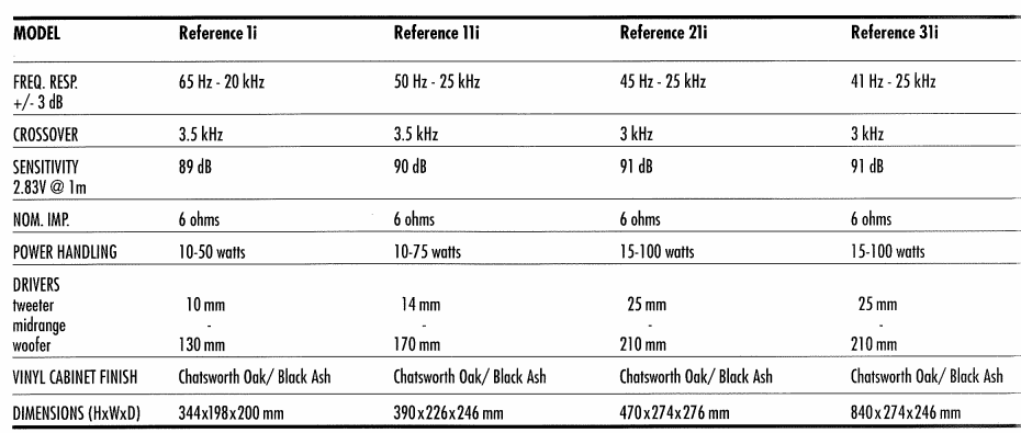

Plan is to reuse drivers and crossover. Basically just build a new enclosure and move everything over. Ideally we would need the T/S-parameters for the woofer to properly design the enclosure, but I haven't had luck finding this. Instead, it going to be a bit a guessing game that I hope someone here will join me in.

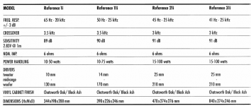

I found an old catalog from 1996. From that I know that the same drivers is used in the i21 and the almost twice sized i31. Maybe this can provide some clues...
F3 was however just 4 Hz lower in the i31.
I took out the drivers and measured the cabinet. I estimate the volume to 22 liters, excluding drivers, brace and so on. Port is 49 mm in diameter and 165 mm of length. According to an online calculator I found, this would mean a tuning frequency of 36 Hz. Agree?
What is then best approach? Just aim on same volume and tuning? Or should I increase the volume and lower the tuning to try to get some more bass? If I do lower the tuning, I believe that a risk is that the bass rolling of earlier, meaning deeper but weaker bass? Am I wrong?

No, you can succesfully build a larger cabinet as i31 is, which will be roughly 35 litres internally. Port you can adjust by listening, use the same diameter as original. 8" units are normally deployed like that. In regard to measuring impedance, a working sound card with one line IN and one line OUT, a resistor, some hook-up wire and alligator clips or similar coupled to ARTA labs limp module or R.E.W. software as an alternative is basically it. But, no rush there. Whatever suits you better at the moment.

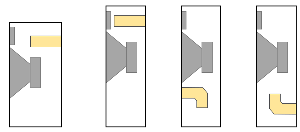

This project isn't moving that fast, but still moving some and now I have an issue I want to discuss. This is regarding to the port placement.
I'm going to build a new enclosure where I'm aiming at the same volume and tuning, but I'm changing the geometri. The i21s have a port facing backwards (sketch 1). I realize that if I would keep the port diameter and length I'll probably getting to close to the front wall (sketch 2). Further on, the port diameter is rather small so I'm considering building with larger. The port would then be even longer and harder to fit. So therefore I'll probably ending up using a bent port.
Any difference in pointing "inwards" or "outwards", inside of the enclosure? (inwards being up in sketch 4, outwards being down in sketch 3)
Would it make a big difference in moving the port from backside to front? I'm considering this, since I'm feeling that I'm then would be more free to place the speakers very close to a wall? But I'll think I like the estetics of backside port better...
