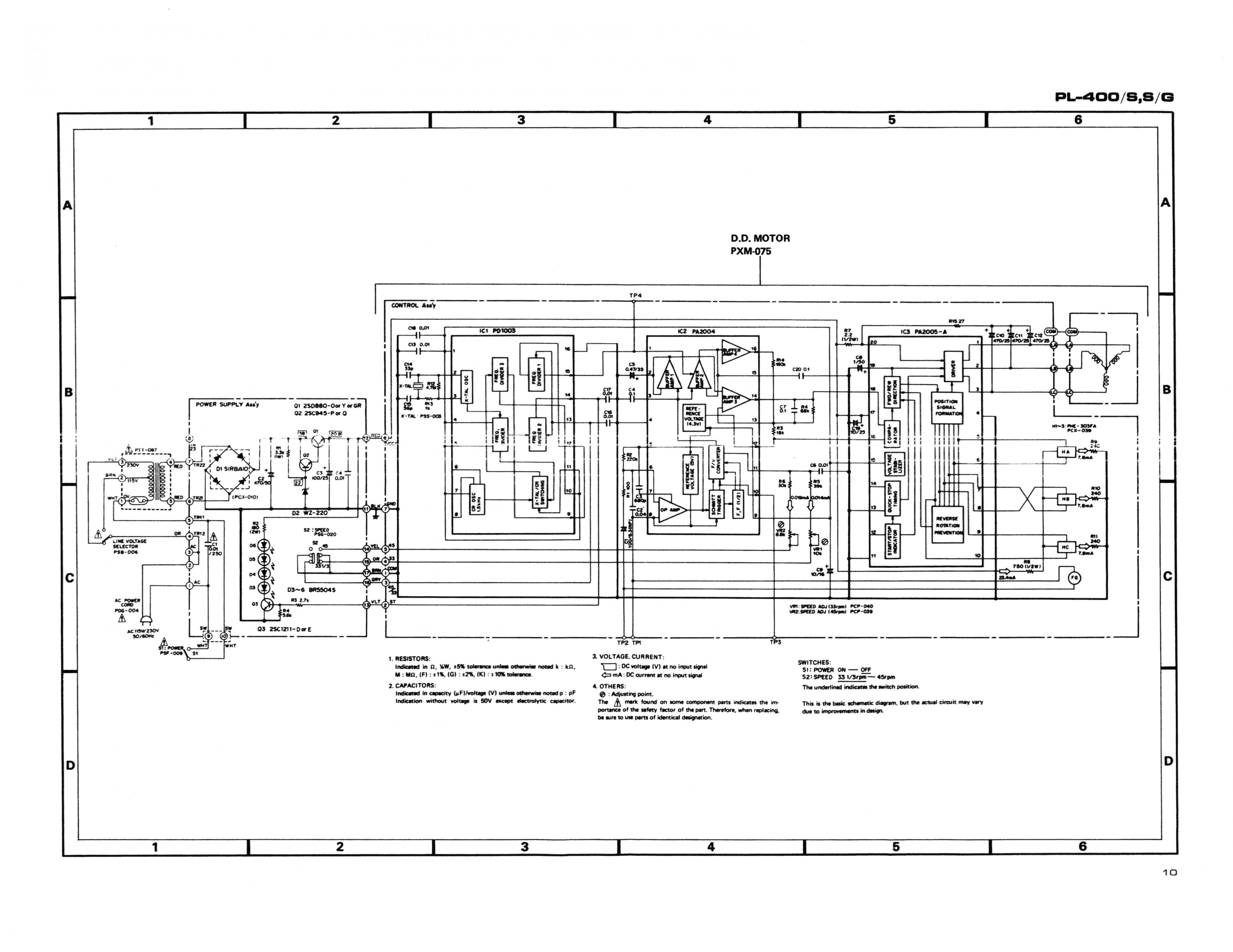

My Pioneer PL-400 turntable is not maintaining speed, it will work sometimes, then when he operates for a while the speed will increase. I suspect capacitors mainly because the turntable was built 40 years ago in 1980. I has a couple odd capacitors that I want to check with the experts on. One is a .47uF tantalum, C5, that runs from one of the buffer amps in IC2 to ground. Any reason I couldn't replace that with a film capacitor? The IC's use ceramics to decouple and a couple for timing, C14&C15, around the crystal, X-Tal. Could I replace those with film capacitors? The last one I have a question about is C8, an electrolytic 1uF, 50V, could that be replaced with a film cap? I suspect cost in 1980 drove the selection of the caps and space for the tantalum cap, but pretty sure I can find a cheap small film cap that would work, if the tantalum wasn't selected for a specific purpose.

The manual describes using an oscilloscope to set the speed system, I'll do that after replacing all the parts.
I have located the bad part. The Pioneer PD1003 chip has went bad, shorted internally, dropped input voltage to 2 volts, took the chip out input voltage came back up to expected 10 volts.
Anyone know where I can find one of these chips? I have searched online.
They were used in PL-300, PL-400, PL-500, PL-600 and PL-L1000 turntables and in the CF-F1250 tape deck.

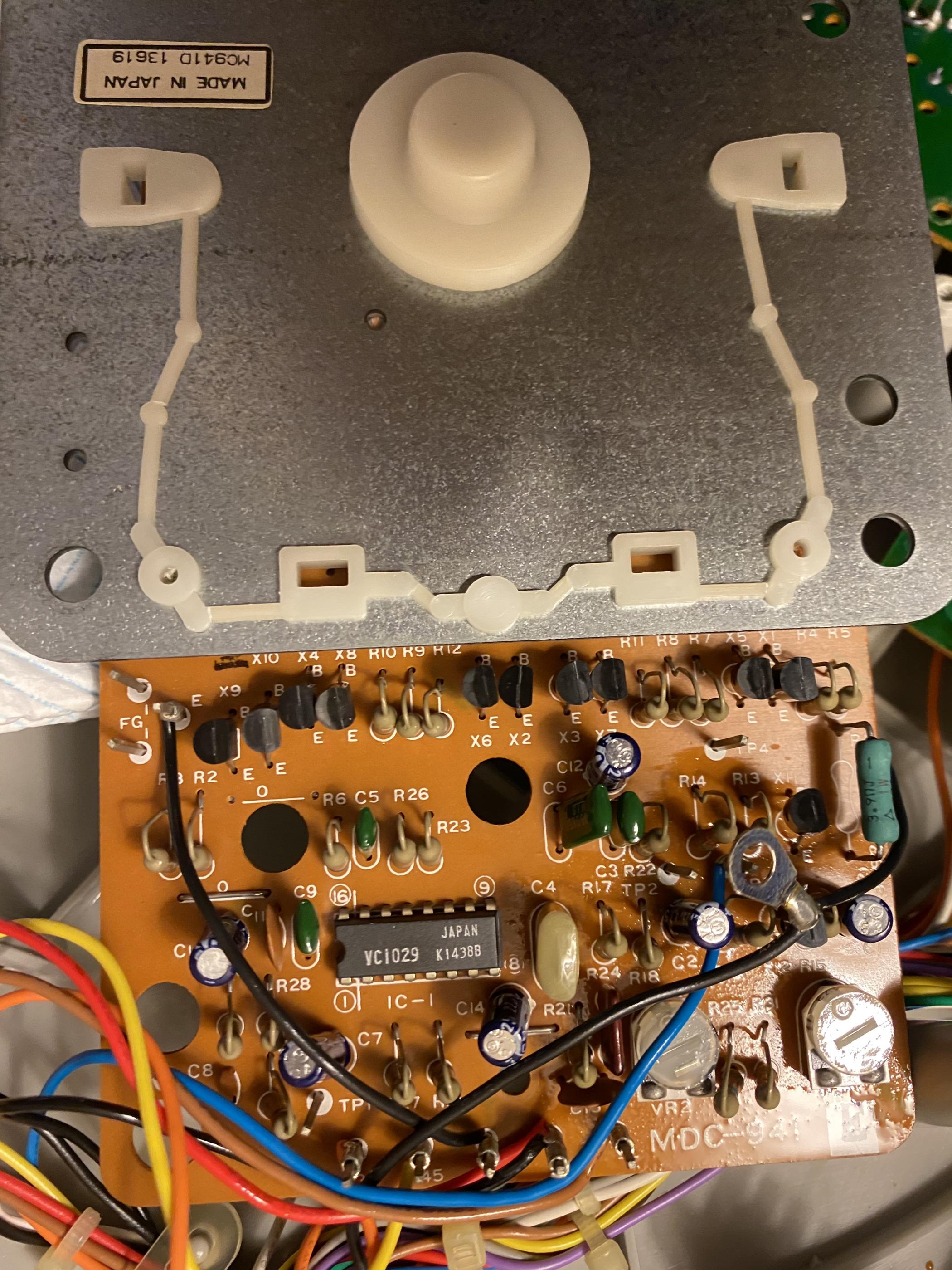

I am also facing exactly same problem like you with my JVC LF-71 DD TT 🙁
Once it cools down and I turn it on it run at right speed for 10-15 min and later starts spinning like mad😱
I am sure its not the issue with speed control circuits or loose connections etc.
and I think problem lies within motor circuit and wanna fix it but the thing is I just have basic knowledge of electric components, could you please guide me how you found out that the issue is in IC?
My TT motor is DD DC servo and have similar kind of IC like yours(NEC VC1029) so how could I test if it working fine?
kindly advice.
Attaching snap of the motor circuit:

I have no idea without a service manual and schematic of the circuit.
You might want to take a look at the attachment a couple posts above, it describes how the Pioneer systems work and your looks kind of similar. I do know Pioneer let other vendors use their technology
