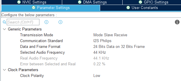

I am currently designing a simple pass-through application for I2S audio on the STM32F072RB microcontroller. Basically it receives data on one of its I2S peripherals and forwards them to the other I2S unchanged. This is done using double buffering and a DMA is utilized on both RX and TX sides. Both I2S are in slave mode on the same clock domain. The source of the audio signal (I2S master) is the Up2Stream Mini bluetooth module from Arylic. The power end is the TAS3251 chip which takes the I2S data coming from the STM32 directly. Later I would like to enhance this application with some low/high pass filters, volume control and FFT.
But what is the problem: sometimes just after the powerup/reset the receiving I2S is somehow unable to lock on the incoming clock and that results in the entire transmission being corrupted (noise or silence coming out of the STM32 - see the video where I repeatedly reset the MCU and few occasions show the corrupted audio). I have quite isolated this problem and I am 90% sure it is caused by the receiving I2S. But what I don't know is the root cause and if it is the wrong locking on the clock, how to recover from this?
Both the receiving and transmitting DMA runs in circular mode, so there is actrually very little code to implement this whole thing - just an init and one ISR to swap the dual-buffer.
I am also attaching screenshot of the receiving I2S config.
By any chance, is there someone who has an experience with I2S audio on STM32 and can give some hints on resolving this?

Have you checked the I2S timings of your I2S master with an oscilloscope? STM32F072 datasheet lists the required setup and hold times.

Ok, that sounds reasonable. I have put everything relevant to I2S and DMA to this excerpt. Please note that most of this code (especially the init functions) is auto generated by the STM32IDE.Not the whole Code..

static void MX_I2S1_Init(void)
hi2s1.Instance = SPI1;
hi2s1.Init.Mode = I2S_MODE_SLAVE_RX;
hi2s1.Init.Standard = I2S_STANDARD_PHILIPS;
hi2s1.Init.DataFormat = I2S_DATAFORMAT_24B;
hi2s1.Init.MCLKOutput = I2S_MCLKOUTPUT_DISABLE;
hi2s1.Init.AudioFreq = I2S_AUDIOFREQ_44K;
hi2s1.Init.CPOL = I2S_CPOL_LOW;
if (HAL_I2S_Init(&hi2s1) != HAL_OK)
Error_Handler();
* @brief I2S2 Initialization Function
* @param None
* @retval None
static void MX_I2S2_Init(void)
hi2s2.Instance = SPI2;
hi2s2.Init.Mode = I2S_MODE_SLAVE_TX;
hi2s2.Init.Standard = I2S_STANDARD_PHILIPS;
hi2s2.Init.DataFormat = I2S_DATAFORMAT_24B;
hi2s2.Init.MCLKOutput = I2S_MCLKOUTPUT_DISABLE;
hi2s2.Init.AudioFreq = I2S_AUDIOFREQ_44K;
hi2s2.Init.CPOL = I2S_CPOL_LOW;
if (HAL_I2S_Init(&hi2s2) != HAL_OK)
Error_Handler();

I2S that works intermittently is quite likely suffering from incompatible timings or noise in I2S signals. You can adjust the timings by changing the GPIO speed settings of I2S pins. The speed settings alter the rise and fall times which in effect changes the timings slightly. Another way to change the timings is to use series termination resistors on I2S lines (e.g. 20 to 150 ohms). But as I said before you should check with a scope that the signals and timings are according to datasheet.
Thanks for your hints. I observed the I2S signals briefly in the early stage of this project and haven't done any further checks since that. I will do some proper measurement again and will consider your ideas.I2S that works intermittently is quite likely suffering from incompatible timings or noise in I2S signals. You can adjust the timings by changing the GPIO speed settings of I2S pins. The speed settings alter the rise and fall times which in effect changes the timings slightly. Another way to change the timings is to use series termination resistors on I2S lines (e.g. 20 to 150 ohms). But as I said before you should check with a scope that the signals and timings are according to datasheet.

Never used F0, but in some F4, there was errata for I2S in slave mode:the receiving I2S is somehow unable to lock on the incoming clock
In I2S Slave mode, WS level must be set by the external master
when enabling the I2S
Description
n Slave mode, the WS signal level is used only to start the communication. If the I2S (in
Slave mode) is enabled while the master is already sending the clock and the WS signal
level is low (for I2S protocol) or is high (for the LSB or MSB-justified mode), the slave starts
communicating data immediately. In this case, the master and slave will be desynchronized
throughout the whole communication.
Workaround
The I2S peripheral must be enabled when the external master sets the WS line at:
• High level when the I2S protocol is selected.
• Low level when the LSB or MSB-justified mode is selected.
Maybe this helps?

I just checked that the same issue is also described in the errata of the F072 which I am using. Based on the description of this issue, this looks exactly as the problem that I am having! I will try to implement the workaround as a next step. Thank you very much for pointing this out!Never used F0, but in some F4, there was errata for I2S in slave mode
@saddevil @bohrok2610 @AIM65 - Guys, I really appreciate all your tips and hints! I will first try the solution proposed by altor and if that does not help, I will also consider your proposals.

@altor
I am trying your solution. I will make my own implementation as I am using the HAL library. As the first step, I have implemented only very simplified version where I basically wait for a certain state of the LRCK signal until I start the I2S reception.
This is a very crude solution but I already observed significant improvement with this. The issue still occurs but very rarely and I think this could be further fixed by implementing properly the waiting for edge on LRCK signal.
Again, thank you very much!
C:
while (HAL_GPIO_ReadPin(LRCK_GPIO_Port, LRCK_Pin) != GPIO_PIN_RESET); //use GPIO_PIN_SET for the other I2S mode
status_rx = HAL_I2S_Receive_DMA(&hi2s1, (uint16_t *)i2s_rx_buffer, buffer_size);
