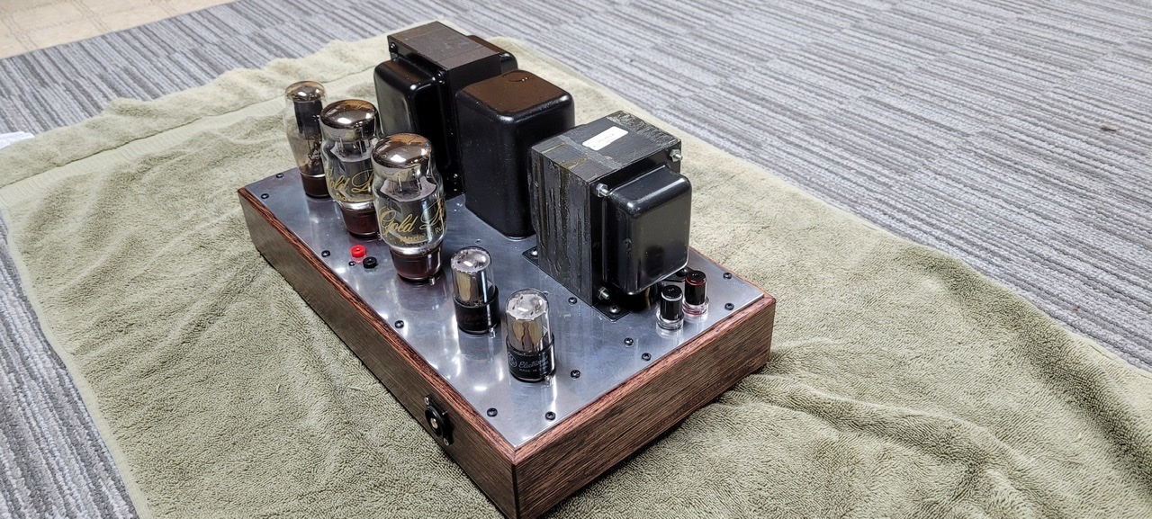

OTOH, I am deeply prejudiced in favor of a classic ultralinear Williamson amplifier. ;-) At 25 wpc it should drive the Gallos with no problem. I have built my "forever" version using a pair of Heyboer copies of the great Peerless S-265-Q output transformer. They are wonderful amps.
I have now four friends who have built copies of the same and they are all profoundly satisfied with them. Here's one version, currently driving a pair of Nesterovich floor-standing speakers:
A fellow member here, TH&D, has built a similar Williamson with Hammond transformers, I'm sure he would share the schematic. That is my suggestion! ;-)

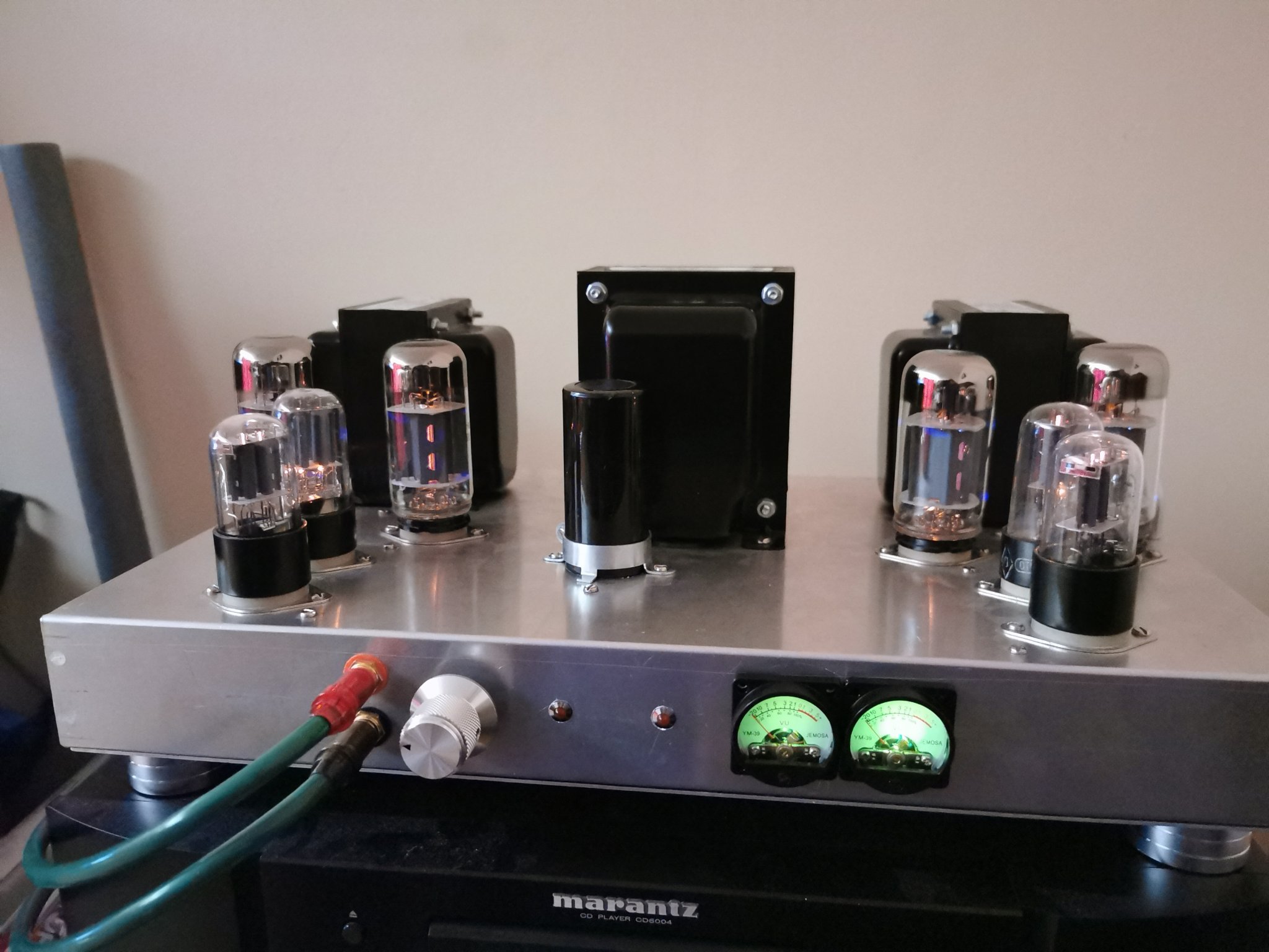

I built an amp losely based on the Eico HF-87/89, paired with Monitor Audio Bronze Bx5 floorstandings, 90db claimed, worked pretty well out of the box. 28W avg before clipping starts.
The Eico is a nice design, a lovely-sounding amp.

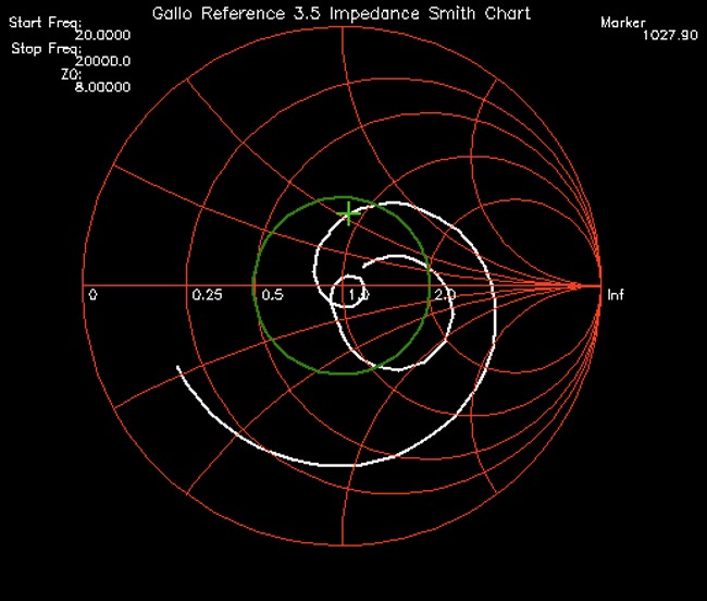

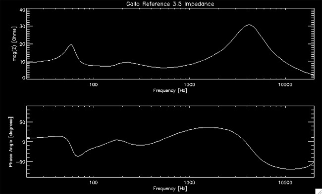

Engineer's amp, Tubelab SPP with something like EL84 output. sounds like 15-20 watts may be enough for you. For the impedance charts like Planet 10 says something with low output resistance would be a good idea, push pull with feedback for lower output impedance sounds like a good solution overall.

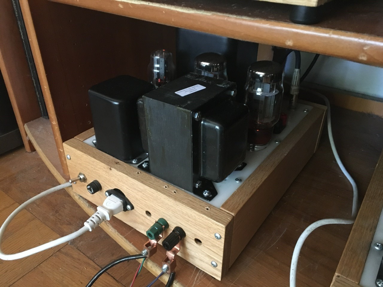

I've got the Gallo 3.1's. I'm running push-pull EL34 monoblocks (with the latest Van Alstine mod board). Compared to this, the original stereo 70 with the same mod board wasn't quite enough, I could hear the power supply sag/compression at high volumes. The monoblocks preserve the impact of peaks on dynamic recordings much better. So my 2 cents is go at least to push-pull EL34 power class (and don't skip on the power supply iron). I've got a fairly small room, and I don't blast it too often, but I want that impact on recordings that warrant it. I've also got the Gallo sub augmentation amp which helps take the load off the tube amp.

hi jgf, sorry what amp are you reffering to? What are these PP EL34 monoblocks? ST-70?I've got the Gallo 3.1's. I'm running push-pull EL34 monoblocks (with the latest Van Alstine mod board). Compared to this, the original stereo 70 with the same mod board wasn't quite enough, I could hear the power supply sag/compression at high volumes. The monoblocks preserve the impact of peaks on dynamic recordings much better. So my 2 cents is go at least to push-pull EL34 power class (and don't skip on the power supply iron). I've got a fairly small room, and I don't blast it too often, but I want that impact on recordings that warrant it. I've also got the Gallo sub augmentation amp which helps take the load off the tube amp.
The Engineers amp and Williamson ultralinear are intriguing ideas which I'm considering trying also.
Hi Chris, I bought 2 of Van Alstine's stereo 70 mod boards, and put them in 2 Stereo 70 chassis running one channel each, with a big choke where the other transformer would be. Prior to that I had another of the same board in one of the Stereo 70s.hi jgf, sorry what amp are you reffering to? What are these PP EL34 monoblocks? ST-70?
