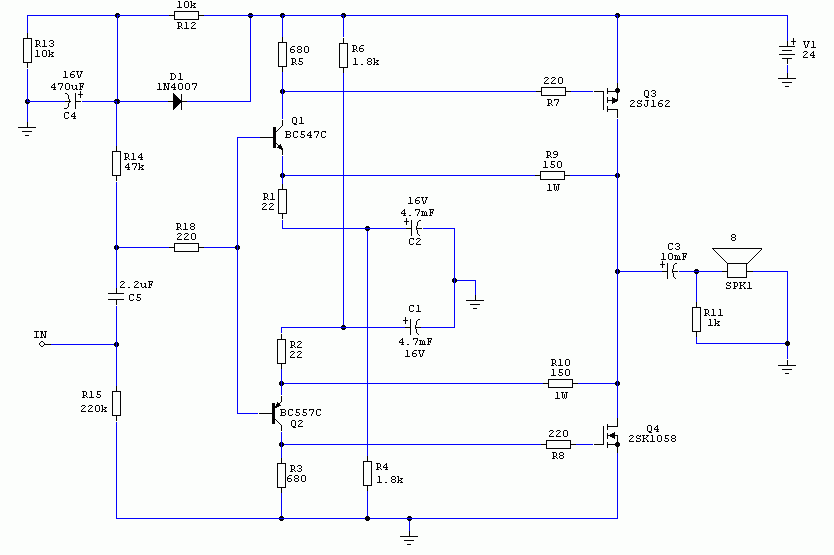

So, it's a single rail 24V power supply, clean 5W cl. A amp that you want - Laterals at the output, different sounding than ACA, right ?
This is what I like (sch. in attachment) - one more F5 modification. Input stage is rearranged to avoid unobtainum small Toshibas (all who tried it reported that it doesn't sound worse than k170/j74, some even like it better). Of course, k170/j74 can be used but in this case I'd recommend GR variant (Idss 3-5mA) since LatFETs need less current drive and have lower Vgs. In that case all additional biasing shebang is not needed (R4/R6, C1/C2).
When I made it, I had reasonably matched transistors and it worked lovely as it's drawn - 12v at the node where drains meet, Id was about 0.7A which is quite all right since with no source resistors we can enjoy the extended class A regime (thanks to FETs' square law transfer curve). If you want to experiment with Id value, use 1k or 2k trimpots instead of R3/R5.
Current through BJTs is set at about 2.5mA (it depends on R4/R6 value) which I chose as a compromise between the need to have enough drive for decent bandwith (>=100kHz) and Ib low enough to provide for decent Zin (50k is fine, good 2u2 coupling caps are plentiful and inexpensive).
Edit: I used k1058/j162 at the output but they are just k135/k50 in flat package.
And yes, C2 polarity should be reversed (drawing error).

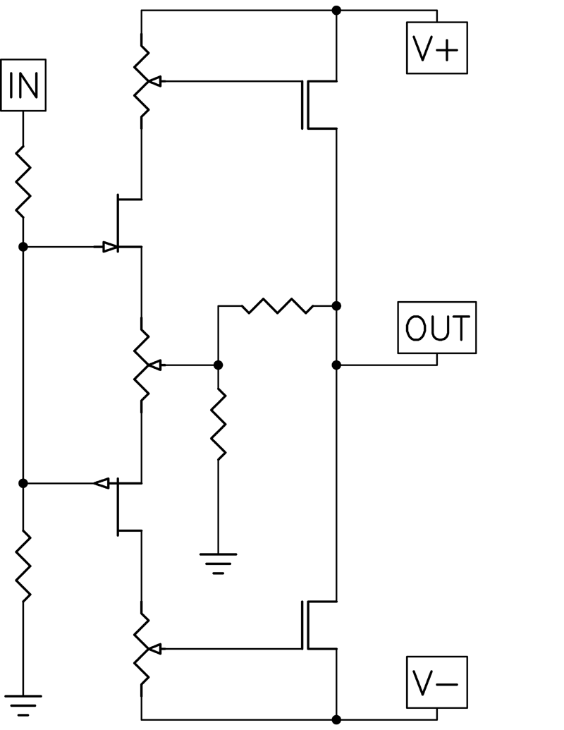

This description fits more the one Nelson shown in post 3.
The last one from Juma should also be a good alternative although I would use double polarity supply to get rid of the big output cap...

Seem to me that C2 polarity is right since your circuit is a single supply type.
Indeed, to me it looks like a native dual power supply circuit and arranged pretty bad to work with a single power supply.
It seems that your circuit is not balanced at all in the actual operation, being that Q1 working as a CE amplifier while Q2 works as a CC amplifier. For which the two drive signals of the power mosfet are quite different.
Then, what is the purpose of using the network formed by R12, R13, C4, D1?
Yes, you are right on that one, my mistake - I posted in a hurry...Seem to me that C2 polarity is right since your circuit is a single supply type.
If you put your mind into it, it can look like an ice cream, or whatever you want it to look like...Indeed, to me it looks like a native dual power supply circuit and arranged pretty bad to work with a single power supply.
Look a little harder - both Q1 & Q2 are correctly polarized and are driving the appropriate LatFET from the collector and receive the feedback to emitter, so both work in Common Emitter mode.It seems that your circuit is not balanced at all in the actual operation, being that Q1 working as a CE amplifier while Q2 works as a CC amplifier. For which the two drive signals of the power mosfet are quite different.
I'm afraid that not understanding that one disqualifies you as a critic, but here it is:Then, what is the purpose of using the network formed by R12, R13, C4, D1?
R12/R13 create a voltage divider which central point is held stiff at 12V (half PS voltage) with C4 which filters the residual ripple from the rail and that is the voltage set through R14 to the bases of Q1/Q2 and through the feedback network to the drains of LatFETs. R14 predominantly determines the Zin of the amp (since the base currents of Q1/Q2 are very low) and D1 takes care of C4's discharge.

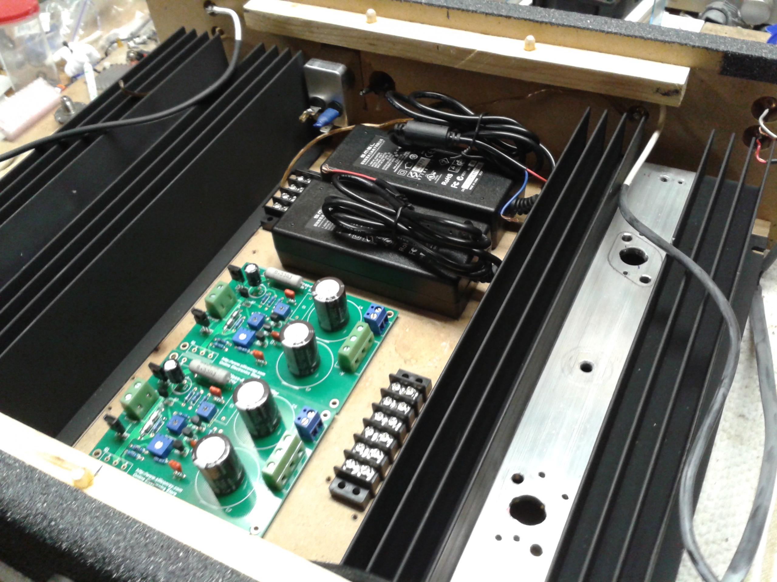

I'm already presently working on a JLH, the one from Silicon Ray with dual rail voltage.
For fun, so far it looks like this.
Eric

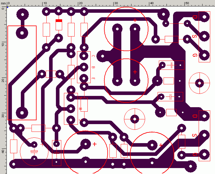

Since this is your design, how did you built it..via perforated board, PCB or p2p. Just wondering if a PCB already exist for your design.
Is there an existing PCB for another project that has similar amplifier topology.
Thanks,
Eric
Here is the PCB I made for this amp - 46 x 57mm, copper side view.
It has provisions for bandwidth limiting caps in the feedback network and input LP filter cap (both in case of oscillations which didn't happen).
Output cap (10mF) is made out of 2 x 4700uF caps connected in parallel.
Input cap discharge resistor (220k) is placed on the input RCA connectors and the output cap discharge resistor (1k) is soldered on speaker terminals.

On your schematic (post no.8), R14 (47k) is connected on the left side of R18 (junction of C5).
On your PCB layout, I believe R14 is connected on the right side of R18.
Should R14 be connected to the left or right side of R18, does it make a difference ?
