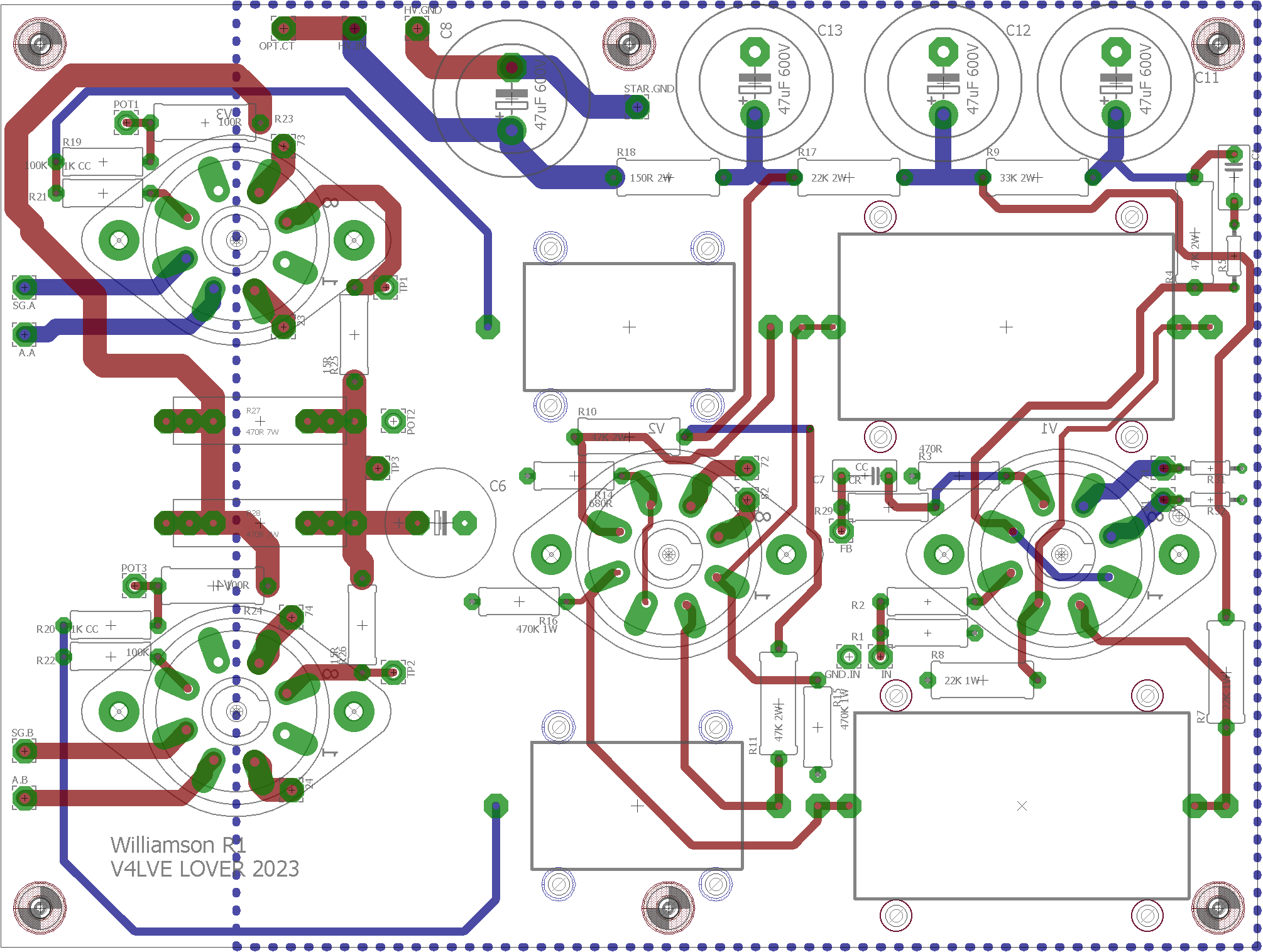

If you're interested, I've just finished commissioning a PCB for a modified version of the classic American Williamson design, the "Musician's Amplifier" by Sarser and Sprinkle.
https://oestex.com/tubes/mus_amp .pdf
The board is designed for octal-based tubes like the 5881, 6L6GC or KT66, and will work for the triode version or for the revised "ultralinear" version at 20wpc:
https://dalmura.com.au/static/Gilding the Lily - July 1952 - Audio.pdf
Excellent copies of the superb Peerless S-265-Q are available from Heyboer, along with a quality power transformer designed especially for this circuit. I have tweaked the circuit for stability and best performance. The PCB contains everything except the transformers, choke, rectifier and first capacitor. Only one choke is required. Filament leads must also be hand wired.
The Williamson is a wonderful amplifier for natural tone and utterly fatigue-less listening. If you're interested, let me know. All the parts can be ordered directly by your members, I am not a vendor. ;-) I had this developed for my personal use.

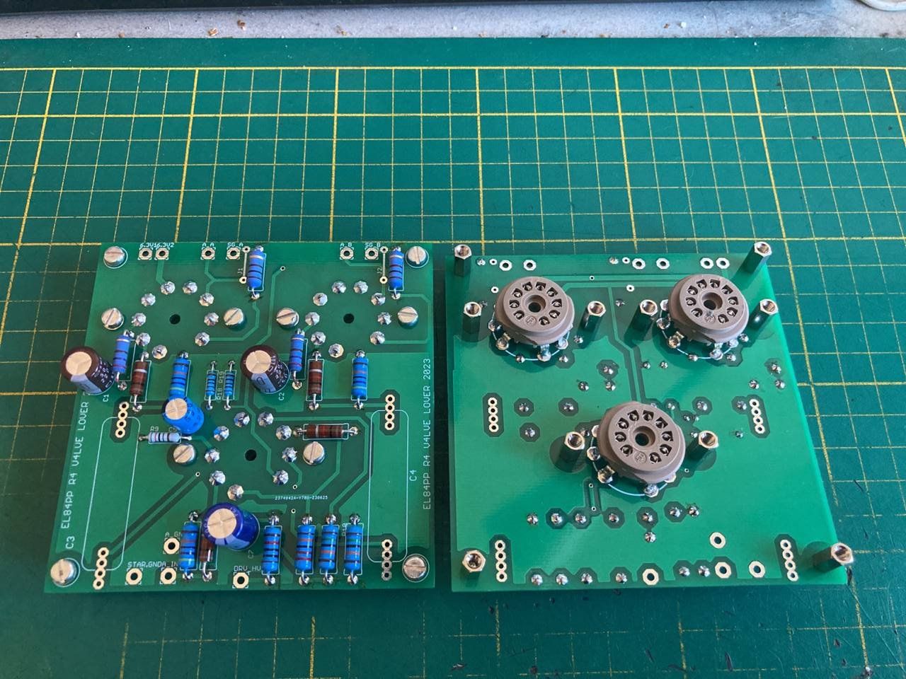

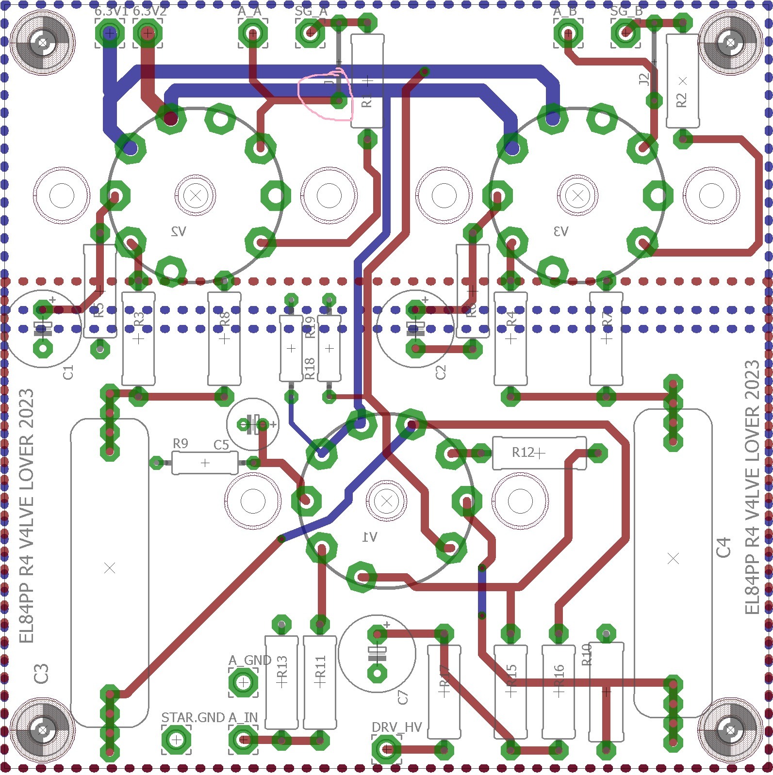

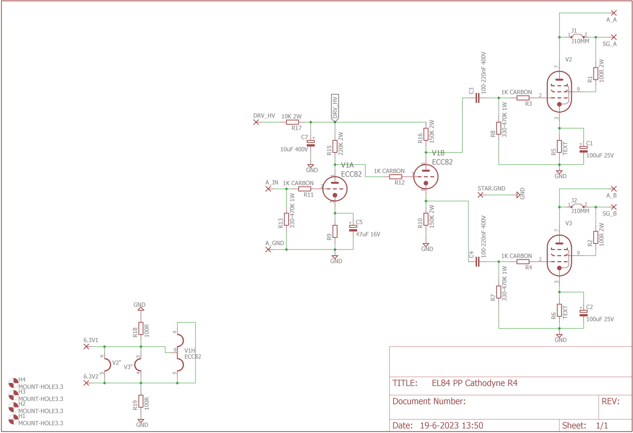

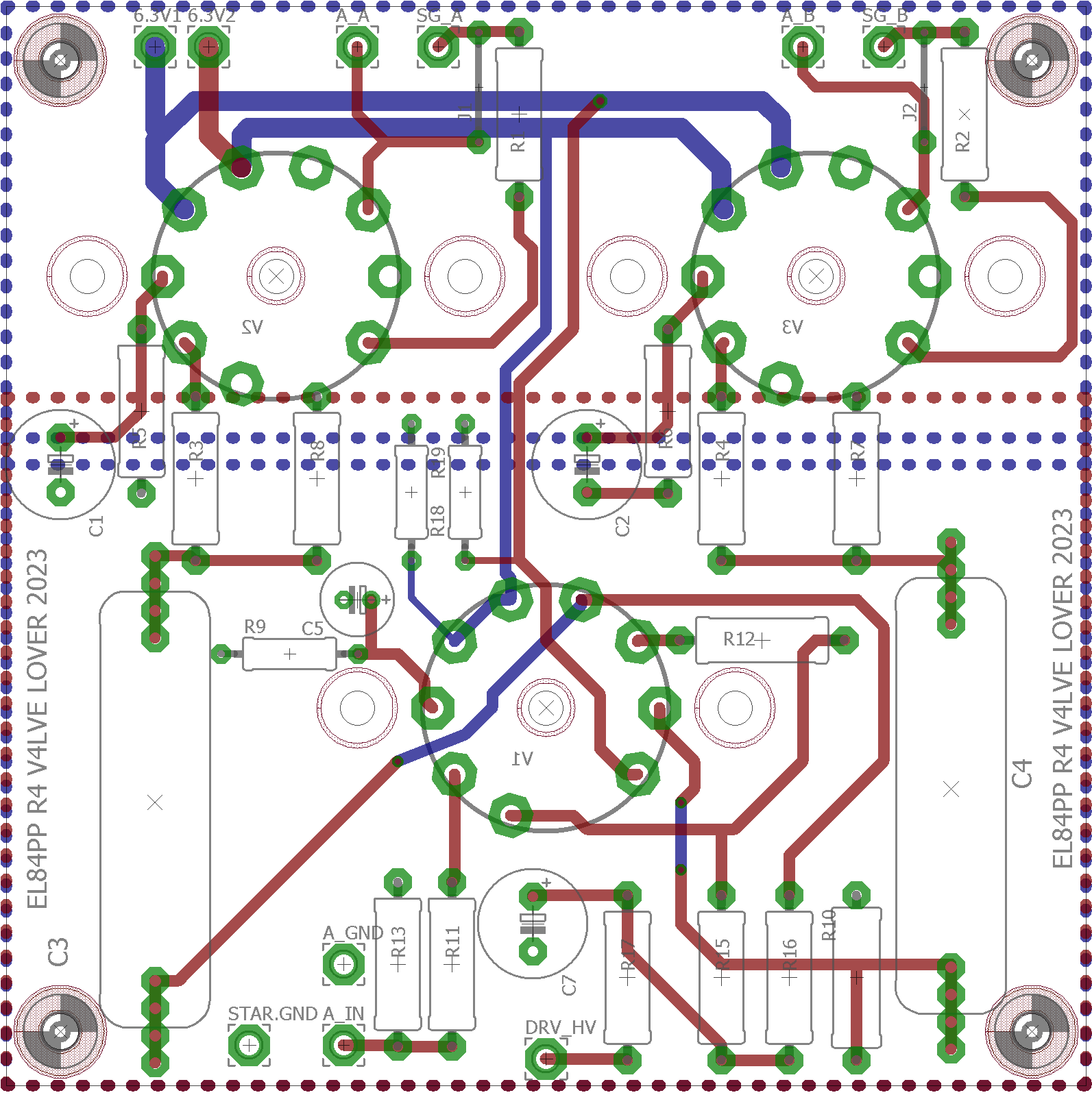

I can offer this: a very simple 100x100mm board for push pull EL84/6BQ5, using ECC82/12AU7 as a phase splitter. It a follow-on revision of previous boards using the same mechanicals. Its very straightforward, can be used in UL/Pentode/Triode. Sockets are mirrored as to facilitate mounting the board under a top plate. Holes in the centers of the PCB allow you to use the PCB to drill out the center holes. Sockets are the excelent Belton VT9-PT
Hard to go wrong with this circuit. I can provide PSU boards as well.
No feedback, nothing to go wrong or oscillate. will produce 8-10W of power, more than enough to annoy the neighbours. I will get some sockets in the mail today, i will build a board and post pictures.

Great info, thanks to all. I have a personal interest in the Williamson amplifier, especially a modern stabilized version of it, which I may persur as time allows. But it's rather elaborate for a first project. That simple EL84 PP PCB mentioned by @v4lve lover might be an ideal starter amp. Good to keep the parts count to a minimum.

As i promised, a photo of a nearly completed set, only missing the coupling caps. This new board revison has strain relief near the tube sockets so the solder joints on the board aren't stressed that much during tube swapping.
It took me 45 minutes to build two boards, a novice helped by some guidance from example photo's and capable of reading color codes on resistors should be able to do it under an hour. Only thing that is left to do is hook the board up. The solder pads are 1.9mm holes facilitating easy wire-to board.
Anyone interested in boards is free to contact me, i bought a ton of boards for my stand at the local radio club swap-meet.

If you are doing this project as a first-timer, the circuit and board presented by @v4lve lover looks to be a fantastic choice… 1) it’s simple, 2) has a PCB which will greatly reduce wiring errors, 3) has no feedback so will be very tolerant of using essentially any output transformer, 4) uses in-production tubes (this is getting more important as time gos by) and 5) it’s very difficult to make a bad sounding EL84 amp, is it was designed to be an audio tube - in fact, it may be the last of the dedicated audio designs. They are sweet and beautiful.
Get some suitable Edcor transformers and have at it!

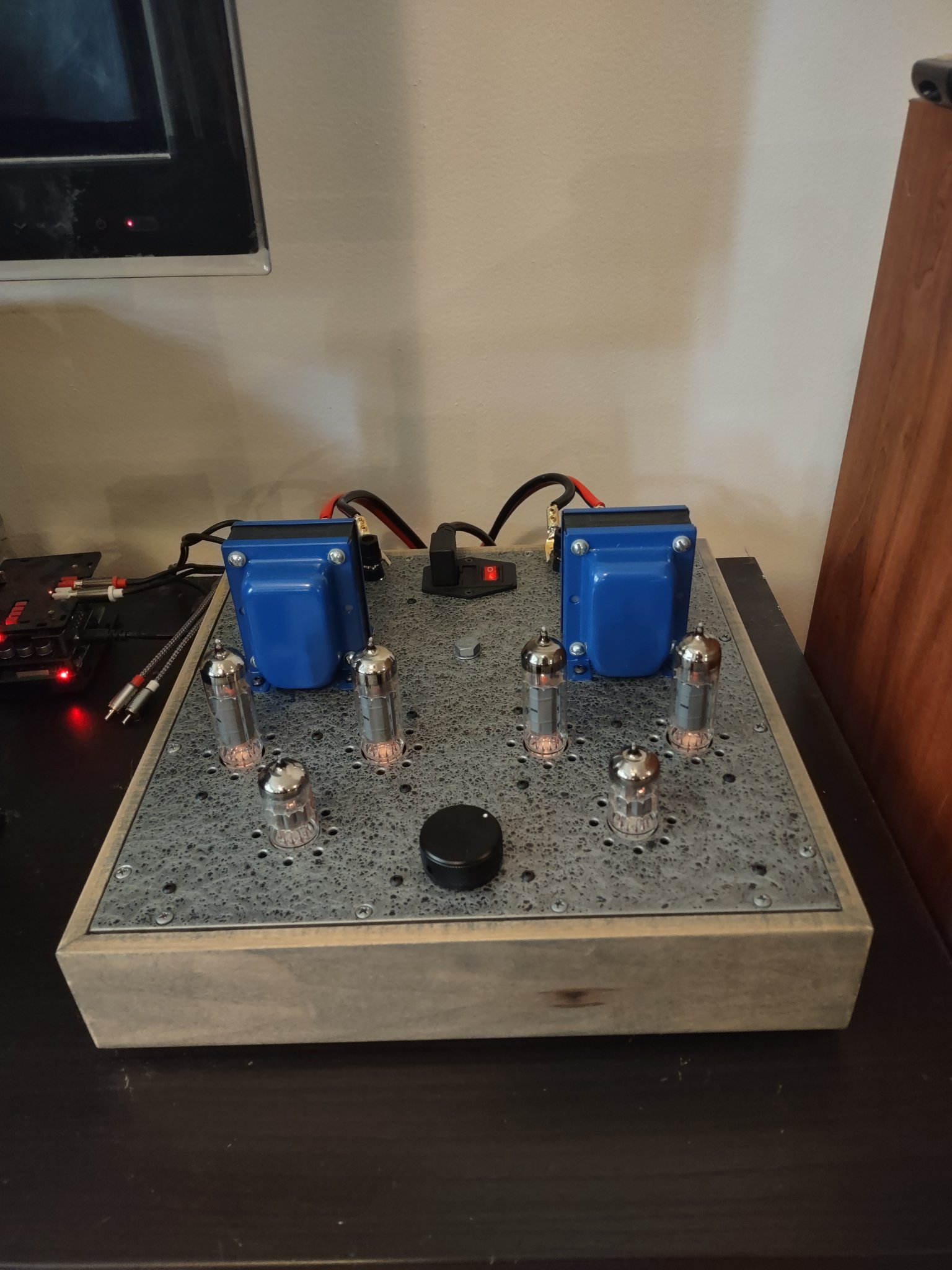

Done and done. This thread is 5 months old! I had a pair of PCBs from a seller out of Hong Kong using the "Dynaco 6V6" circuit and whipped up an amp with a top plate CNC cut at a friend's shop, and I built a maple base.
The OPTs aren't to spec so I had to learn to use a scope to find the best value for that cap in the Fb loop - the phase lead cap?
Anyway, good times. Thanks for taking a look
