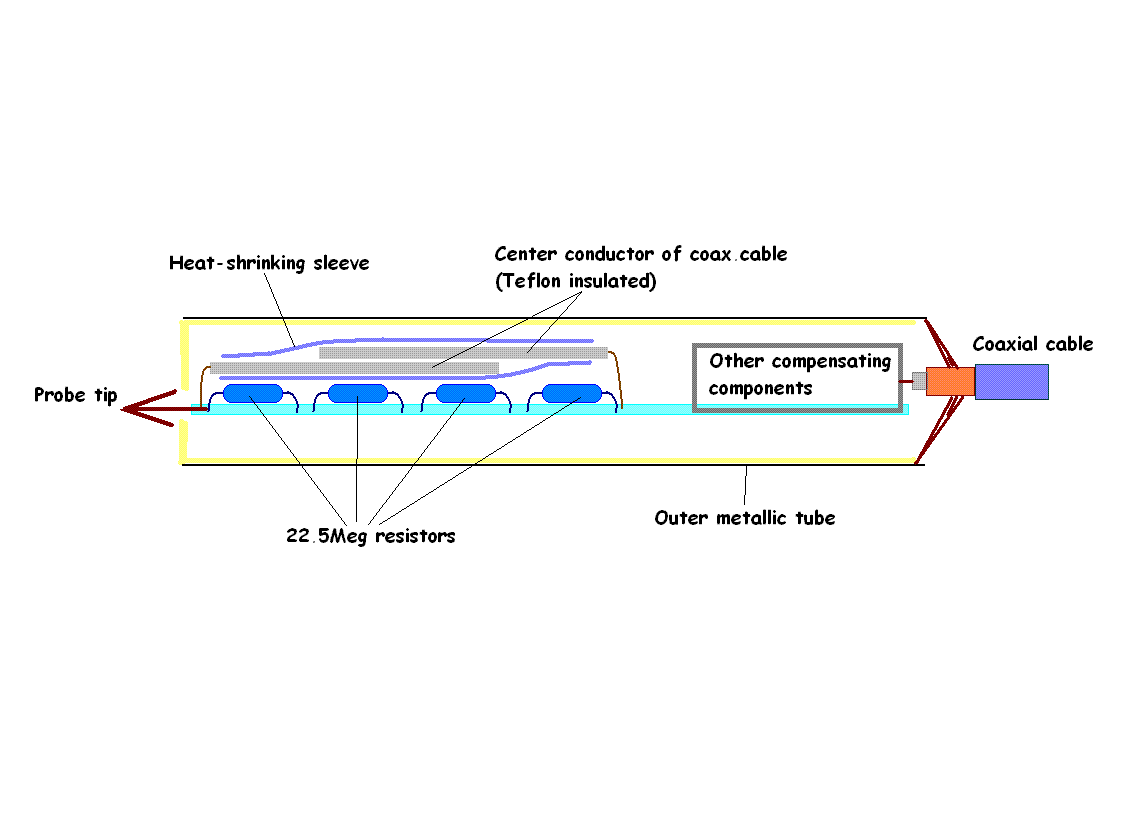

If you want to be on the safe side, here is a successful design of a X100 probe:

You don't have to implement the 0.15pF; in fact they are unwanted, they represent the capacitances of the resistor string to the grounded shield and they have to be compensated.
The resistor string is made of 4x 22Meg/5% VR25 resistors selected so that their total is 90Meg (the individual value is unimportant, only the total):
http://www.electrodacus.com/store/D1090015/doc/spec.pdf
The main compensating capacitor C5 is made from two lengths of the center conductor of a coaxial cable rated at 4KV, held together with a heat-shrinked sleeve.
C7 and R6 are actual components, their value may need to be tweaked to get a perfect square wave response.
R5 is the input resistance of the oscilloscope, paralleled with a 10Meg resistor installed in the probe.
Its purpose is to fine tune the DC calibration of the probe, if you don't succeed in having precisely a 90Meg input, and to avoid the build up of high voltages if the output is left unconnected.
C4 is the total of the cable's capacitance and oscilloscope input, plus an adjustment capacitor to get a flat square response (C5 is unadjustable once assembled).
The probe is good up to 5KV.

It doesn't really matter, unless you work with VHF signals, which is not the primary purpose of this probe.Where does the 0volt reference clip on?
to the metal tube? at the probe end?
In my case, I found more convenient to attach it at the coax cable entry, but you could solder it anywhere on the probe's body.
Mine is insulated, more for comfort and grip than safety: the metal connects to the chassis of the oscilloscope via the cable, and the oscilloscope itself is earthed via its power cable, it is thus safe, even without insulation.Presumably the metal tube has external insulation for operator safety
