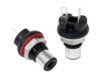

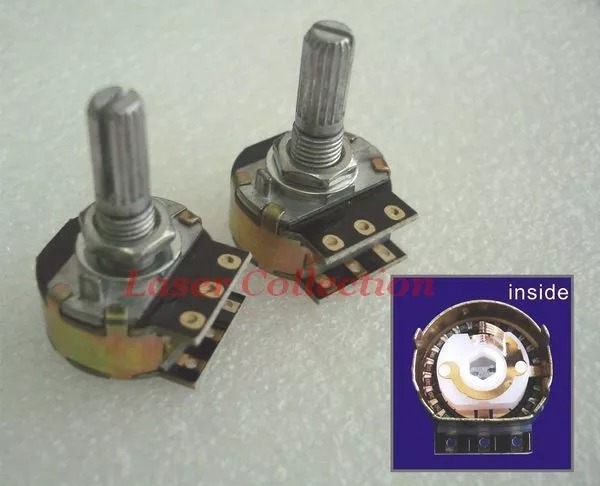

I'm building a preamp and looking for recommendations for brands and suppliers of potentiometers and knobs, RCA sockets and mains power switches. Quality is the key and cost is down the list of priorities.

For pots, I like TKD CP2500, either 2CP or 4CP (4 ch. balanced). There was a guy in Vietnam that sold these and was reliable, but I'll have to dig up the info on that. For knobs there are a couple of Asia based suppliers though one of these (vt4c) went out of business. The other that I know of is http://www.thlaudio.com/indexE.htm.

For RCA - Neutrik are your best bet for quality industrial grade.
Pots - Industrial: TKD or Alps. If you would like a stepped attenuator then something like DACT or Goldpoint. Or there is something like a muses chip.
