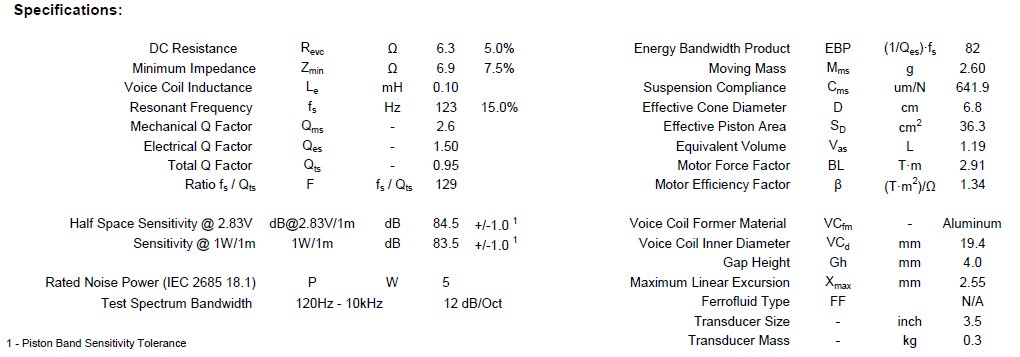

TC9 is the classical choice, but Faital 3FE and 4FE, Mark Audio CHN-50, SB65WBAC25, Scanspeak 10F series and some others are probally also fit.
I think the TC9 is a favorite because of it's size/performance ratio. It's just big enough (Sd x x-max) to work as a complete full range solution (after EQ) while being small enough to keep the onset of comb filter problems at a high enough frequency (to keep it out of voices etc.) and still work well at off axis angles. It doesn't hurt that it's affordable. 😉

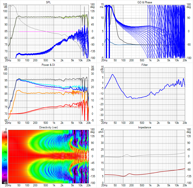

The above is a simulation, done with VituixCAD of an array of 25x TC9 without shading. You see the lobing at ~4-5 KHz that points at the ceiling/floor? Depending on where that ceiling is (around 50-55 degree in my case, ceiling height 3 meter), it will cause some frequency ripple starting at about 5 KHz.
That floor/ceiling bounce will move up in frequency when you use a smaller driver. It will move down in frequency if you use bigger drivers.
** The ripple would be there in some shape or form with a single driver too, as that would not have the vertical directivity of an array.** see end of post.

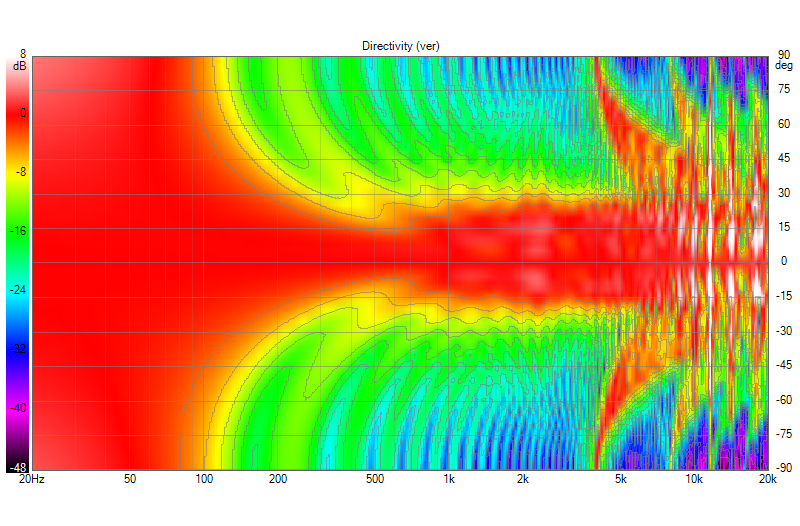

Lets see another view:
You see the peaks and dips start at ~5kHz too, at about a 2.7 meter listening distance. If you move further away from the array, the comb pattern will move up in frequency. So it all depends on what size driver and the listening distance. And you'll need EQ, preferably done at the most used listening spot/distance. In an untreated room you can use an average of multiple measurement points, for instance along a couch. If you have treatment on early wall refection points you can get away with single point measurements. Basically arrays like these light up parallel planes, while everything else sort of escapes them. So they don't over-react on tables or chairs in the room, but do light up parallel walls. Be advised that enclosure corners/ridges are parallel too. Big enough round-overs on the enclosure go a long way to avoid diffraction as it happens at every driver, that's 25x!
- do note the DI, that's the bright red line in the left middle graph. If you compare it to measurements from the favorites according to Harmon Theory (Toole) it certainly isn't a bad score!
The FaitalPRO 4FE35 is a bit bigger than the TC9, meaning the comb problems will start at a slightly lower frequency.
If you listen from slightly further away, it would not be that different though than if one would sit closer and use a smaller driver.
Basically you'd want a driver that has a clean looking IR and preferably a slightly rising frequency response. No ringing top end, as that would not work well after being arrayed. And choose one you like (after a bit of EQ to cope with the rising response 😉), you'll get it back on steroids!
You're going to need EQ, so do plan for that.

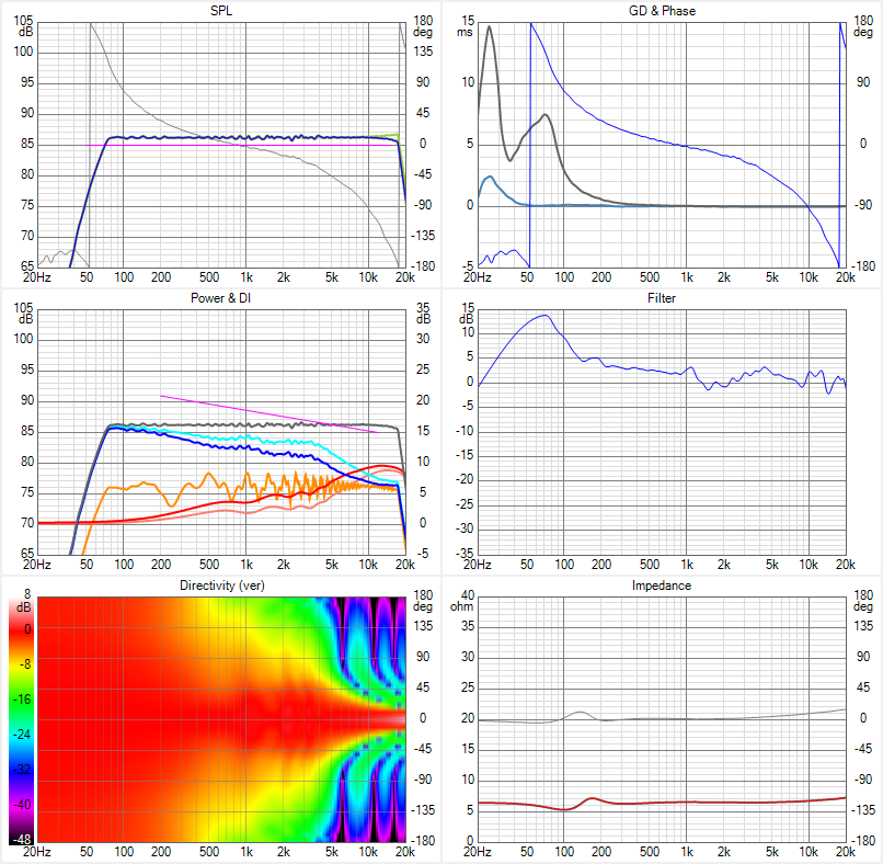

Comparison of a single driver under the same conditions:
Plot of a single driver. Note that the orange line is the prediction of the frequency at the listening spot. These graphs presented here only have floor and ceiling reflections active, no side and back walls.
