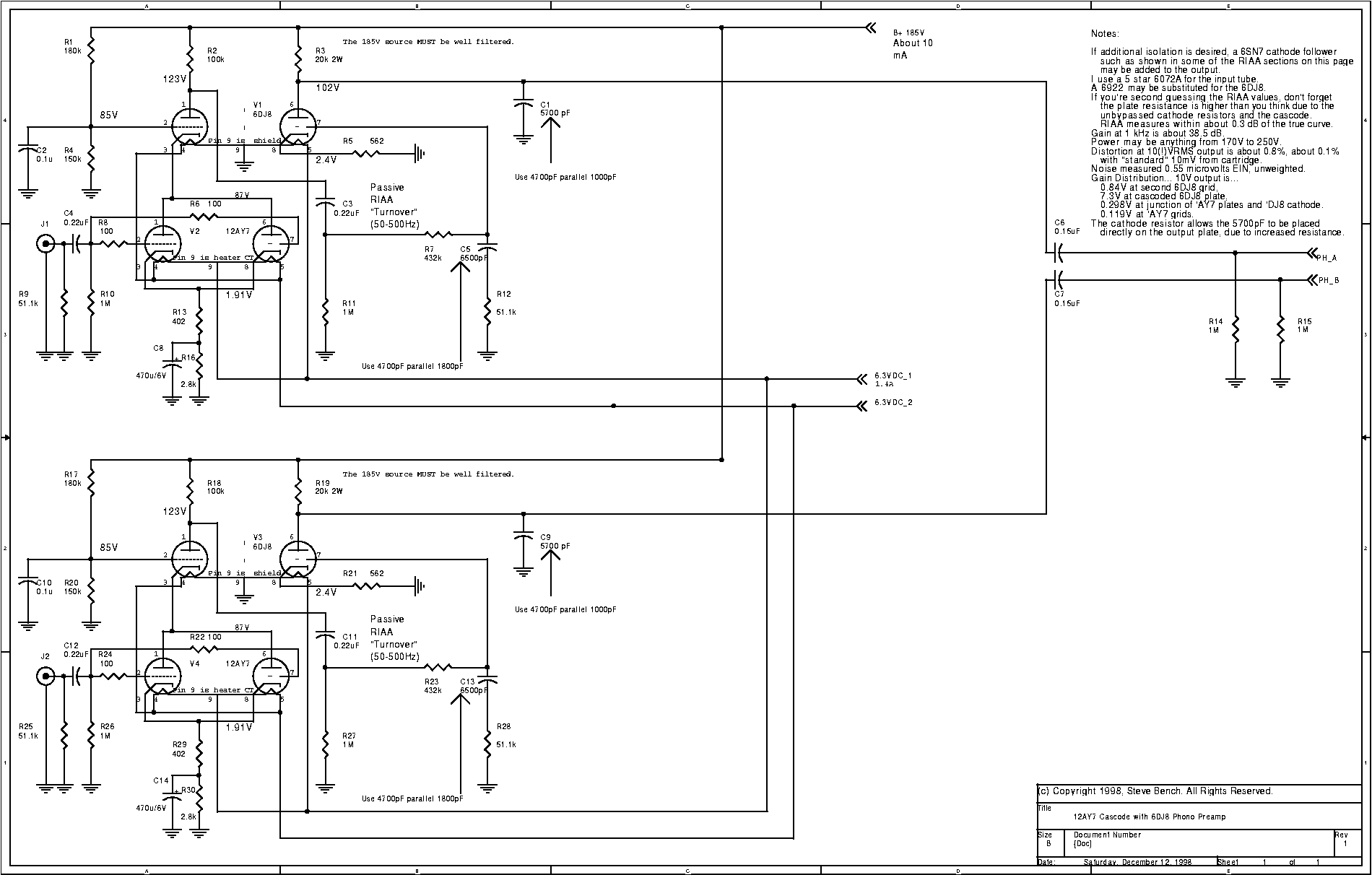

Steve Bench RIAA 5 - I built one of these in the late 90s, still have it today. Fantastic!
Use shield tube sockets on the inputs.
http://diyaudioprojects.com/mirror/members.aol.com/sbench101/Preamps/RIAA5.gif
One question is how much gain you're looking for. What sort of cart are you going to feed it with?
The guy has 6dj8 not 12ay7 which aren't too cheap for 4 of them...are the new 12ay7 good?Steve Bench RIAA 5 - I built one of these in the late 90s, still have it today. Fantastic!

@dreamth The RIAA5 uses 6DJ8 and 12AY7. Both are dual triodes, so only (2) tubes are required.
