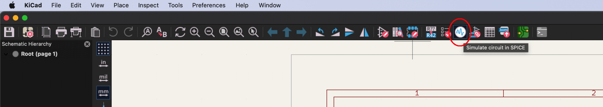

KiCAD is excellent. The new version seems to include a SPICE simulator as well, though I have yet to use it. LTspice, TINA-TI, and PSpice-for-TI are all free circuit simulators. As with any engineering software they're not the easiest to approach, but they do work well once you know how to use them.

There's a button for it... I haven't used it. Usual disclaimers apply... 😉

Hmmmmm, Been hearing about it, I will have to see if I have it in my version and give it a try, Thanks for the Heads up, I had been looking for it but never took the time yet to start a project in it and Re-learn Kicad.
