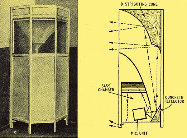

And my first question. Attached is a posthumous interview of Voigt by Bruce Edgar. Bruce Edgar made horn design accessible for DIY-ers and did have contact with Voigt to come to an interview for Speakerbuilder magazine. They had several conversations over phone, but in the end did not meet in person. Voigt's widow sent Bruce part of Voigt's archive and he used both this information and the telephone conversations as th basis for his mock/simulated interview.
What grabs my attention here, is that Voigt/VirtualVoigt says that the corner horn is a quarter of the square traxctrix horn, with a reflector placed above it. To me, this suggests that only the part of the horn pointing straight up is part of the intended horn design. And that the part of the Home Constructor's Horn above the straight section is merely a reflector.
The Cinema is referred to as a "four foot horn" in all references I have found. English is not my first language and I wonder what this means. Does it mean 4 feet times four feet"? Or does it mean "two feet times two feet"?

Dave, yes and no. It´s big and clunky and in modern times we work to reduce reflections and timing smearing. Yet we also design drivers with a high Xmax for dynamic range and use phase plugs and reflectors and waveguides to achieve a desired frequency response and directivity profile. Dynamic range, frequency response and directivity profile are exactly what Voigt targeted with his corner horn.
Thanks, that clears some things up for me.Means either 4 ft high or 4 ft axial length to me, but it's 5 ft tall, though it's terminus is ~2 x 2 ft = 4 square ft (4^2').
To complete this:Means either 4 ft high or 4 ft axial length to me, but it's 5 ft tall, though it's terminus is ~2 x 2 ft = 4 square ft (4^2').

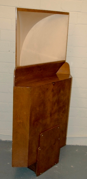

Sides of the square horn are: 2 ft = 60.96cm
The area of the square horn are: 60.96^2 = 3716,1216cm^2
The corner horn has a horn mouth that is 1/4 of the full square mouth: 3716,1216 / 4 = 929,0304^2.
These are not exact numbers, but pretty close and give us a reference to determine whether the horn mouth of the corner horn is indeed the end of the vertical section, or whether it's actually the opening after the reflector, aiming straight at the listener.
I have calculated the area of the vertical section before the reflector, and the opening after the reflector aiming straight at the listener.
End of vertical section before the reflector: 1089,161128 cm^2
Opening after the reflector aiming straight at the listener: 3239,116038 cm^2
In the previous post, I concluded that the mouth of the corner horn is around 929,0304 cm^2. Comparing this to the two values calculated in this post, the end of the vertical section before the reflector has an area that is much (much!) closer than the other value. So I consider the end of the vertical section before the reflector confirmed as the actual horn mouth. It's interesting that the other value is quite close to the full size horn mouth. This might affect the acoustic behaviour of the horn. Something to be studied in a hornresp model and an actual construction.
So, the horn mouth is 1089.161128 cm^2 and the curved section/reflector is separate from the horn. When modeing the performance of the horn, chose this value as hornmouth.

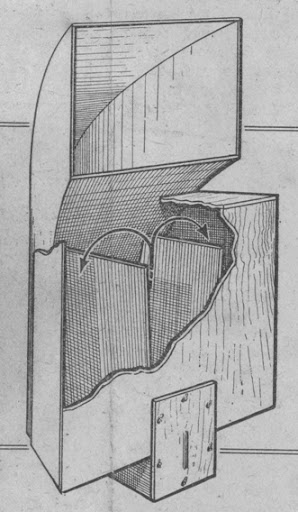

I have the urge to know the insides of this horn very well, so I like to do the calculations and comparisons myself. I also appreciate the knowledge and extra eyes available here. I learned everything on just a few interesting forums, and this is both enjoying that, and giving others the opportunity to get interested and involved as well.
Yes, lots of stuff in that thread! After reading through a lot of it, my abbreviation of it is that the basic principles are well documented, but actual specifications are missing. Not strange, they were commercial products and the intellectial property was his livelihood.@Ivo you seem to have it bad, so (when you get some free time to sit) check out some of the many references conveniently cited in the PFM voigt thread. if you haven't already.
What I want to know is how he put his theoretical-mathematically derived design into a practical loudspeaker design. When we understand exactly how he made the corner horns, we can model response of different drivers accurately, but we can also "roll our own" horns of different expansion types and different sizes. That's what I want to know.

Two things:
- If you look at the very drawing you posted, it is definitely a tapered pipe, split in two paths. Kind of like a Voigt W-horn. It's visible in photographs of physical specimens of these horns. If you have built a variety of tapered pipes/pipe horns, it is a feasible design.
- In the available literature, Voigt says the horn has strong response to 100 Hz. A Tractrix horn does not have strong response down to its calculated cutoff. Its actual acoustic cutoff is sqrt(2)*Fc. So to achieve the an acoustic 100 Hz Fc as Voigt describes of his corner horn, you would need to design a horn with a cutoff of Fc/sqrt(2)= ~70 Hz.
- I think I need a few more days to confirm, but today I calculated the Fc of the most certain stretch of the horn, and its Fc does indeed appear to be 70 Hz.

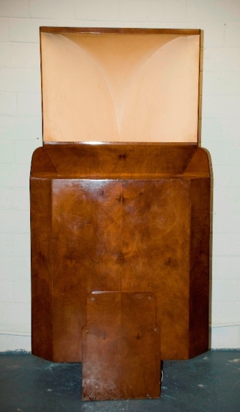

In the Bruce Edgar "interview", Bruce lets Voigt say that the corner horn is the quarter of a full square cinema horn, when you it over its diagonals. That would suggest that the horn expansion is derived from the mouth section of the horn, where the mouth flares out into a 90 degree angle. It doesn't look that way in the plans, but I figured I might check whether Voigt did indeed start calculating with a full mouth and cut it in the diagonal manner stated, or simply recalculated starting from a reduced mouth size.
I used hornresp to pump out several tractrix curves and did some shuffling and comparisons in Excel. It has become a very messy series of graphs, which I am hesitant to show. 🤣
I see that the curve derived from dividing a full tractrix curve by four does not overlay as well as simply starting the calculation from the quarter size mouth. So, I think Bruce Edgar went a little too far in his interpretation of Voigts intention/method here.
By entering the throat and mouth size into hornresp, it will calculate the proper expansion, You don't have to do calculations based on a full horn and manipulate them.
