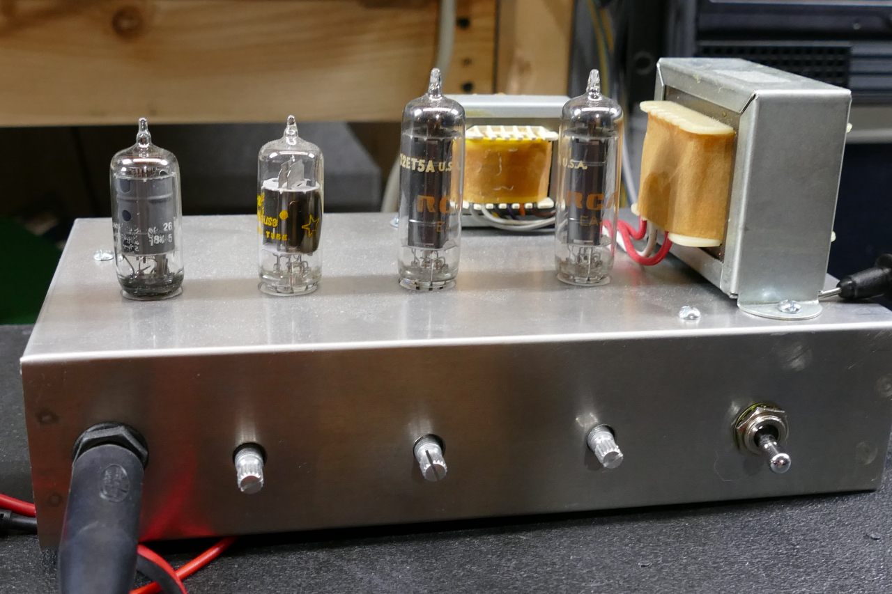

I have built several small guitar amps that use series heater strings and derive their power from an isolation transformer with a "120 volt AC" secondary, often the Triad N68-X. These transformers are usually NOT exactly 1:1, but have a higher number of turns on the secondary to make up for transformer losses. I get 170 volts from a bridge rectifier, and 340 volts from a voltage doubler under load on those with my 122 to 125 volt line
There is a small measurable (scope) and sometimes audible difference between the two types of diodes in these amps.......unfortunately, the UF4007 is not always the better choice. Transformer wiring, lead dress, PCB layout, and total DCR in the path influence the measurements. Granted some of these amps have as many as 8 diodes in the power supply. They are far cheaper than "vacuum tube" power transformers.
The 8 diode amp makes 15 watts of output power, has a bridge for 170 volts for the screen grids and tube heaters, and a full wave doubler for main 340 volt B+. It likes UF4007's.
The 5 diode 4 watt amp runs the tube heaters on unfiltered DC, and uses filtered DC for 170 volts of B+. It likes 1N4007's.
