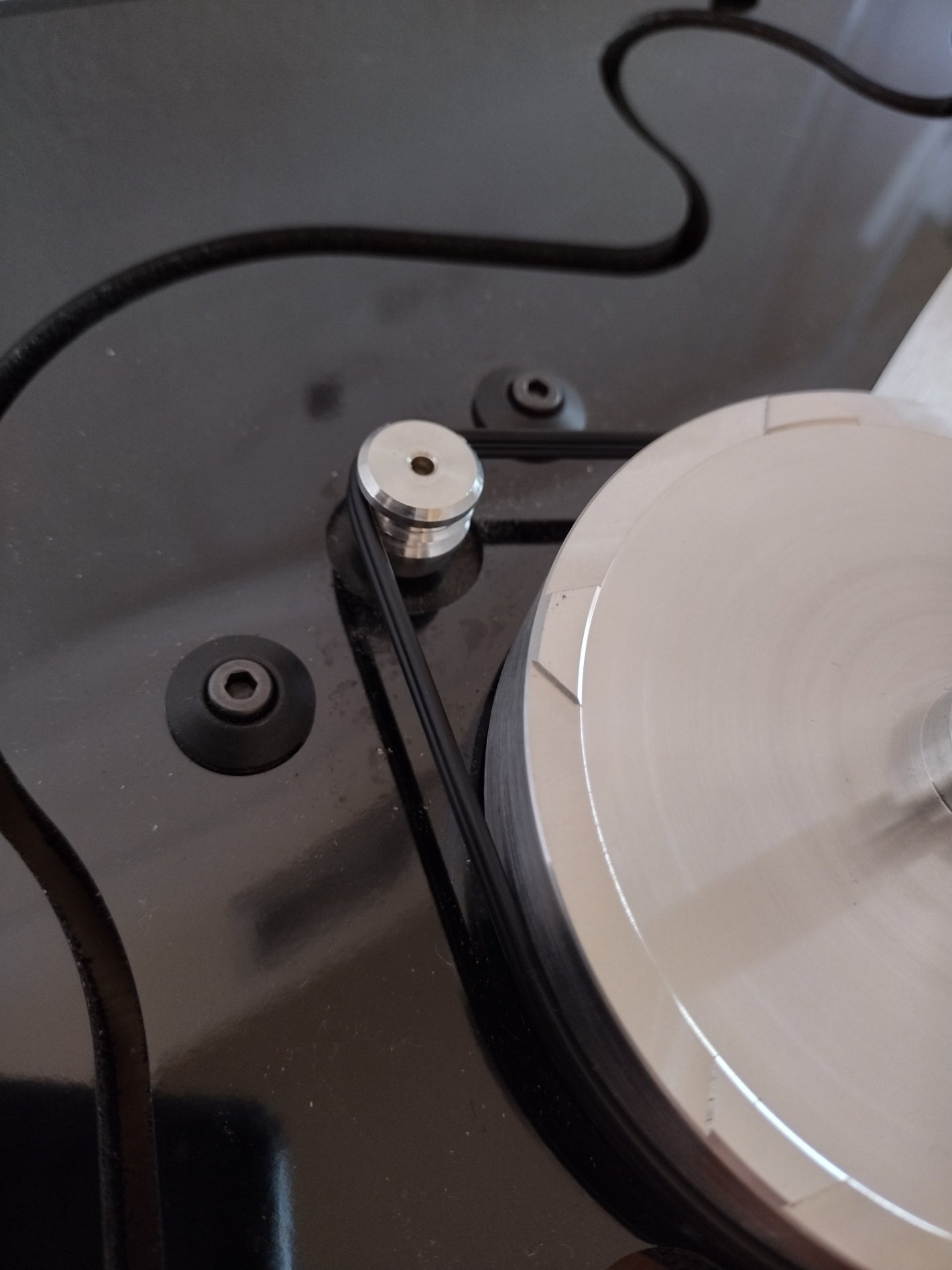

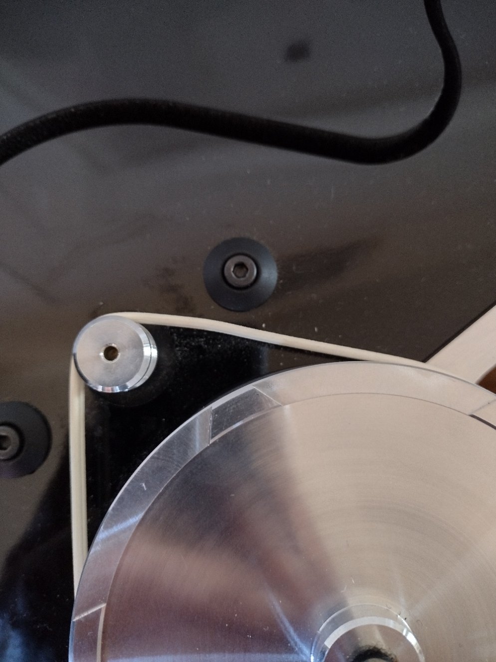

I thought I'd resurrect this old thread to share my findings. As my old Rega RP8's white belts had become a little slack, and somewhat put off by the cost of official replacements I decided to do some experiments using off-the-shelf O-rings. I had already measured that the thickness of the original belt was 2mm, and that the diameter was in the region of 106 to 108mm. Trying the new 108mm belt first the turntable was running fast by around 0.7%, the 107mm was better at approx. 0.5%, the original 'slack' belts about 0.3% fast, and finally the 106mm belts were almost spot on at 0.1% slow. All speed measurements were conducted using the RPM Speed and Wow app (of which I have no knowledge of its accuracy but assuming it's consistent enough to do comparisons). Interestingly I tried a 2.5mm thick 106mm belt but the motor 'bogged-down' and would not come up to speed. I'm not promoting the supplier used for the belts but give the details for information purposes. I will do further measurements and listening tests to confirm whether the new belts are indeed (very good) value for money.
