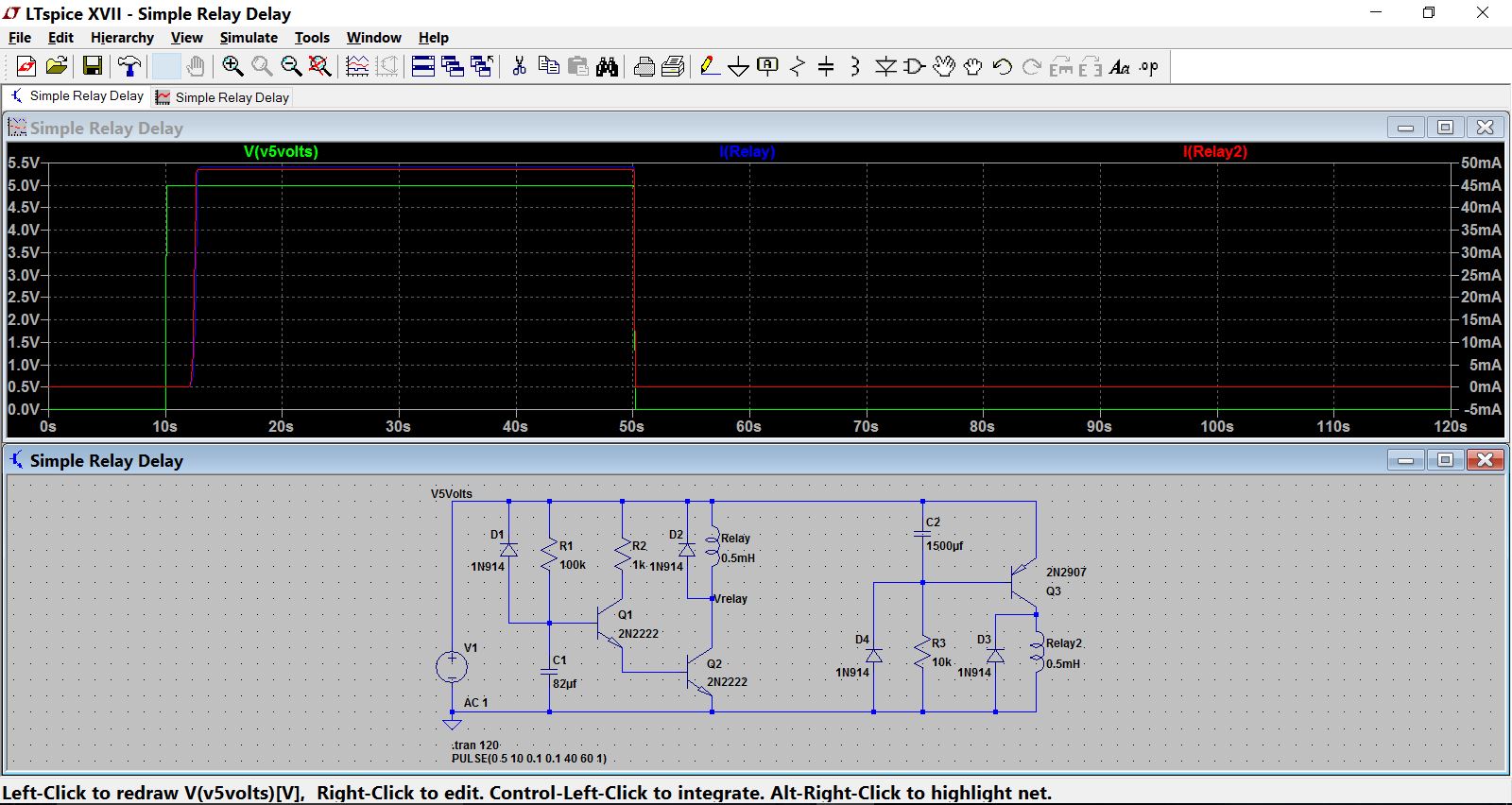

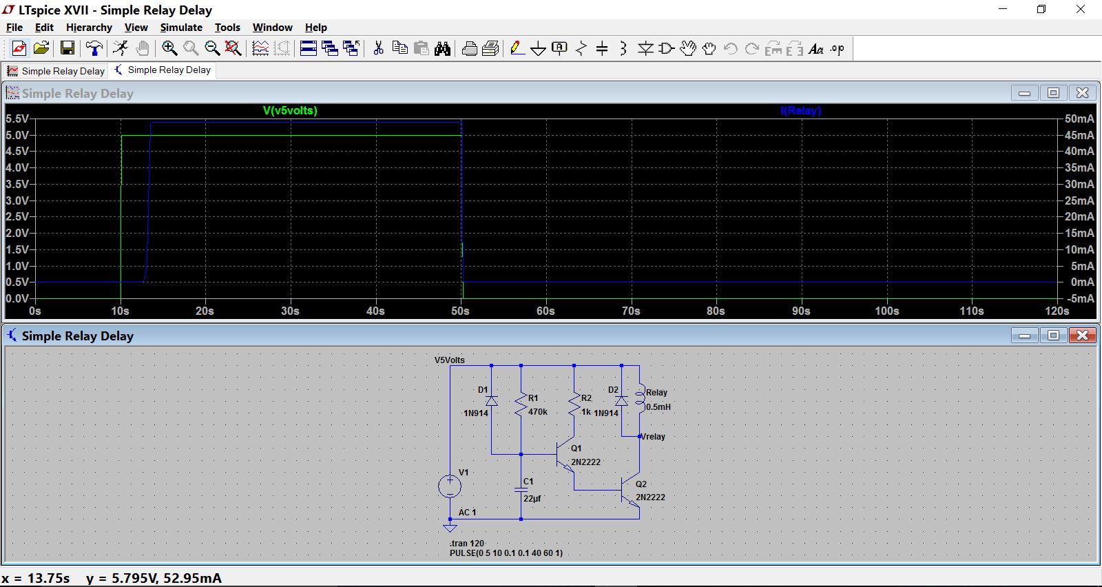

This is based on your example. It works, but look how much bigger the cap needs to be than in the two transistor example. The one in your picture could well use an FET which would be the best solution but its not workable with a 5 volt supply unless you used very specific parts that might be hard to get.

The one with two transistors is the most repeatable and allows the use of small value caps. The single transistor version needs a large cap and relatively low value resistor (to be able to drive the single transistor) and has the disadvantage (as does the other but not as bad) of only 'using' or allowing the cap to charge to around 0.6 volts before the relay operates. The two transistor one gets that up to around 1.2 volts, so considerably better.

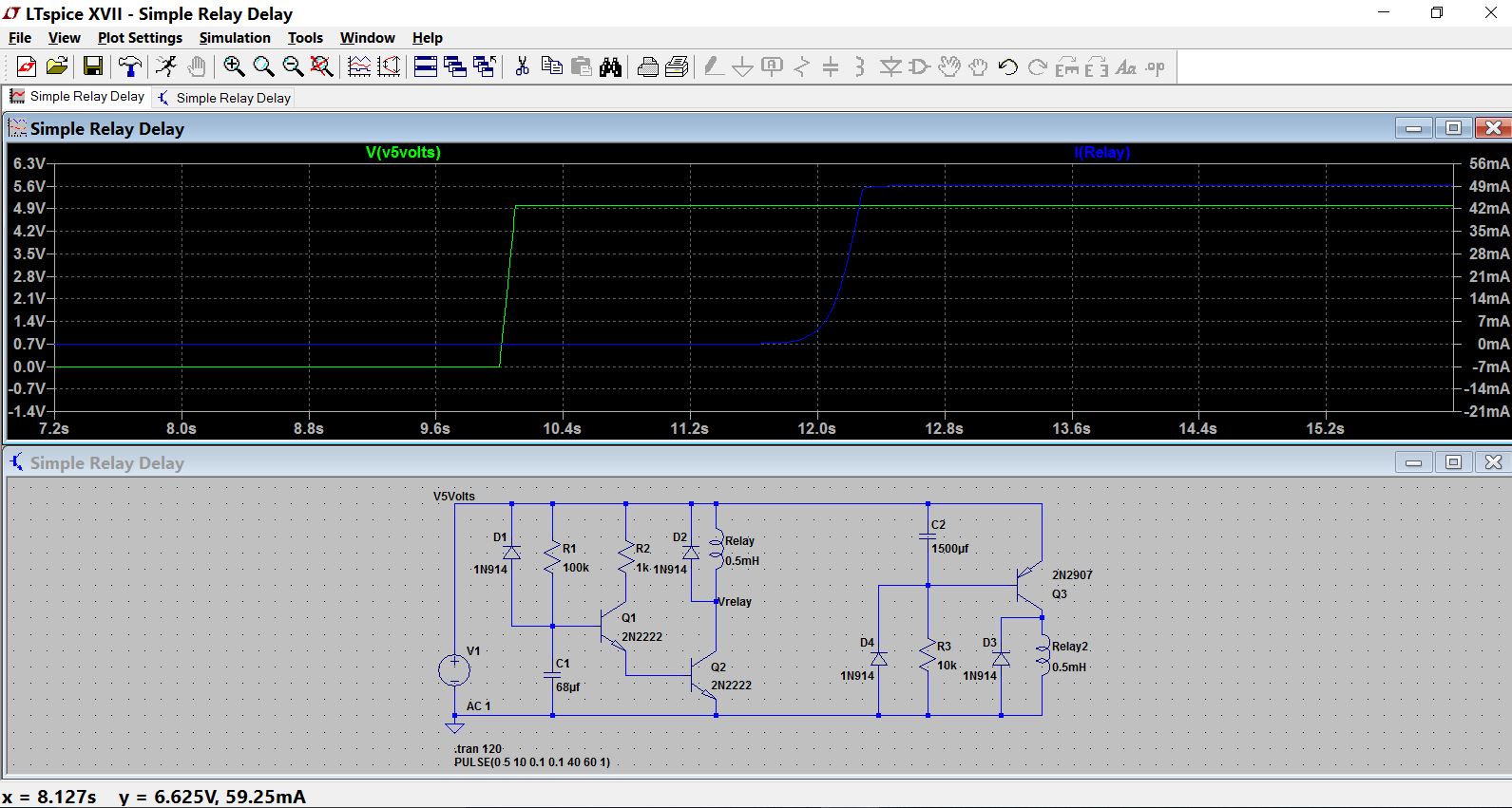

If we go with Andrews concerns and reduce R1 to 100k to allow for lower gain transistors, then somewhere in the 68uf or 82uf range would give two seconds. If that was a little long then use a 47uf, if you wanted longer then a 100uf and so on. Its very flexible.
I'll look in again later today if you have any more questions 🙂
You can see the delay here. Its about 2 to 2.5 seconds for the values shown.
