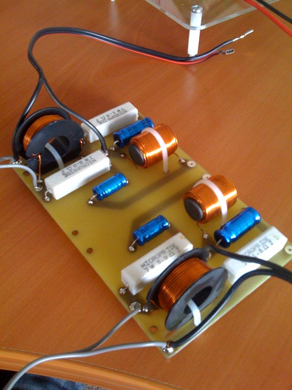

I have a pair of Mission 760 (old singlewiring version)
They have seen their best days, but the drivers are still good as new. (5 1/4" midwoofer, probably made by Peerless India. Vifa D19-TD 3/4" poly tweeter)
So i want too make new cabinets and eventually improve what can be improved.
The cabinet are easy too improve. a laminate of 16mm MDF and 14mm Birch takes care of making a solid box. wich also should improve looks. a sligthly deeper box with the same volume would also allow a longer,wider and less noisy port
But what about the x over in the 760`s
Have anyone figured out the way the components are hooked up and wich value the different inductors, caps and resistors have?
My x overs are so littered with melt glue that its close too impossible too get any info out of them.
I guess i could succed with just designing a regular 12db/oct Butterworth filter with 5 khz as a x over point and attenuate the tweeter 3 db with an Lpad.
What do you suggest? should i try too duplicate the stock filters with higher quality components (IF i can find out the needed info) or should i design new filter from the bottom

I would measure the response of the filters and then duplicate them (with better quality parts), but that's assuming you have the req'd crossover design software and skills.
Oke. I intend to the same: to improve my 760i filter.
I have replace the cap in serie to the tweeter by a audyn cap 4,7mf and the audyn 15mf cap (in the woofer correction).
Had these part here doing nothing. So why not use them?
I sounds a lot better!!clown:
I would prefer mundorf for the tweeter, maybe i will but these later.
The Resistor in serie to the tweeter is 3.9 ohm 7 watt
The Resistor in the correction of the woofer is 1,8 ohm 7 watt
I like to know the value of coil in serie to the woofer. It is a ferriet type. An air coil might improve sound. Anyone?

Just for reference, here is a photo of the crossover in my 760i's before modification as I am making a 'boombox' from them here: http://www.diyaudio.com/forums/full-range/165384-small-boombox-speaker-selection-port-design.html
Seems like the 760i has a different woofer than the 760, my woofers have smaller magnets and i have also a different x-over/terminal
Photo of modified cross-overs
Here's a photo of the modified cross overs. The information about the boom box this went into is here.
http://www.diyaudio.com/forums/multi-way/165384-small-boombox-speaker-selection-port-design.html
