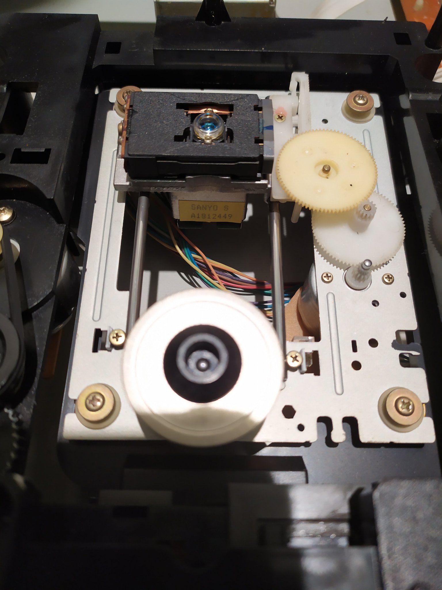

I am new here and need an advice. I recently got this Luxman CD player from a friend's father but came without the remote control. Is there any way to find a remote control or a substitute for it? (including phone app as a last solution)

Hi Mooly, thank you very much for your fast and helpful message! You made me curios so I opened it and looks like on the laser motor it reads Sanyo, is this means that there is big chance will not work with that remotes that you suggested? (I have to buy one in order to try, don't have any universal remote in home)

You can't say for sure, however based on that it does make it less likely tbh. If it is Philips based it would use a Philips chip set and you would see things like TDA and SAA prefixed chips in the main circuitry. I can't turn much up at all on this player I'm afraid.

can you post pictures of the circuit boards to help identify the mfr of sub-assemblies?
