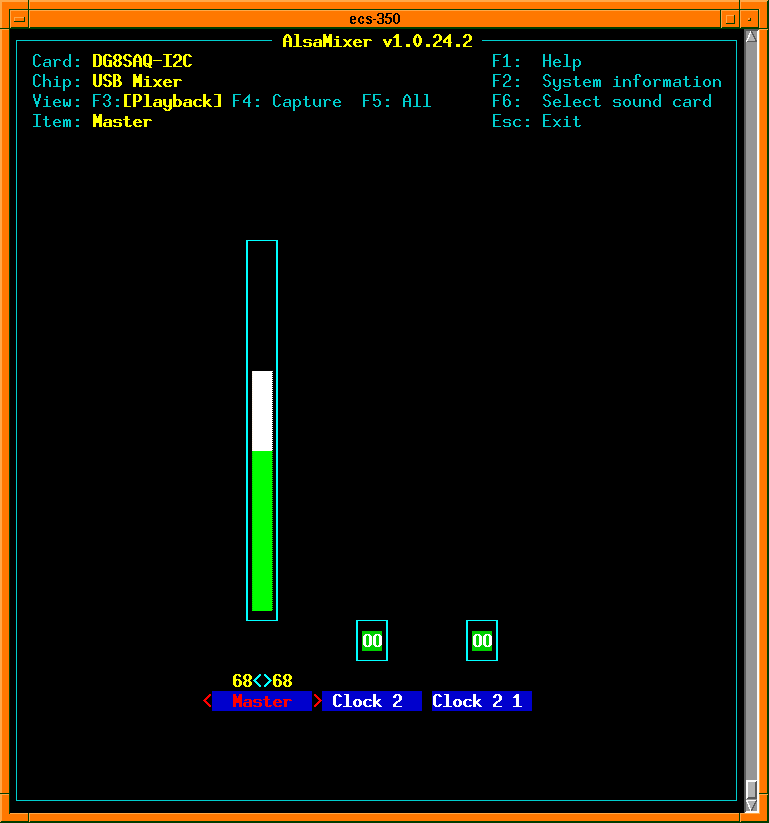

you create a 'fake' slider or mixer entry in alsa. a few ascii lines in /etc/asound.conf and some in /var/lib/alsa/asound.state. the state file is what you have to edit to create a new 'Master' fader. even though its not real, it does show up as an entry in alsa and any sound app can 'move' it since its just a regular vol slider, to it.
the best way to work this is to use a usb sound card or one that is bit perfect and does not *change* any data when even a so-called Master slider is moved. all my usb/spdif dongles are like this (if you use the digital out instead of the analog out).
that's the slider part. the back-end part is a poller I wrote that checks /dev/ttyUSB0 for any new i/o and also checks the mixer app by calling a hacked version of linux 'amixer'. I call amixer to get the current value (in shell script) and if the value changed since last time, I send a serial update to my preamp (over usb). if no value was changed in the mixer, the poller scans the serial/usb port for *preamp* knob changes. if the user turned the knob, a new value will be seen and that gets pushed back to the mixer 'amixer' and the vol display on the computer is now updated and in sync. that's the general idea: keep polling both and if one changed, update the other. even in bash shell script, it keeps up fast enough to be useful.
the hard part for most is not all this: but the real world interface to your audio system, for real world vol control. I designed and built my own preamp and a feature that was always part of the design was 'remote remote control' over some kind of serial port.
http://www.diyaudio.com/forums/analog-line-level/206157-cs3318-arduino.html
the code is partially in bash and partially in C. will post (probably in another diyaudio thread) on how to do it, at least up to the serial port part.
last section of asound.state that you have to add:
control.5 is the entry I had to add by hand. it has to have the magic name "Master" and 'iface MIXER'. find the last entry in your file (mine was #4) then add this control entry with one higher than the last entry. save the file (and save it under a new name, too, so that you can copy it over the /var/lib/alsa/asound.state at system startup time).
to get it to 'work' you have to have alsa reread its state file (usually it creates a state file, but here you created a new fake entry to an existing state file):
depending on your card # it could be 'restore 1' or 'restore 2', etc.
once you do that, you should be able to run alsamixer (the image/capture I posted) and see the NEW 'Master' there. if you run alsamixer first and don't see it, then edit the file, do the alsactl restore, then you see it, you know things went well 😉
in mpd, you should point to the Master mixer if you use mpd:
mixer_type 'hardware' means you do NOT use software vol control (so that you don't touch the bitstream). what we've done is to fake out the system and make it think that there is a real hardware control called Master and to link it with mpd.
go into mpd, vary its volume and in another window, watch alsamixer. the two controls should 'move each other' being the same widget accessed via different apps.
