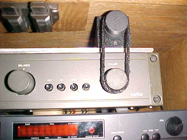

I am new to this forum and I have an old preamp and all knobs are rotary and there is no remote control. I want to try and craft a remote for the volume. I found this picture on the internet to illustrate my point. I don't want use a rubber band but I am curious if there are aftermarket options anywhere for slipping a knob control over the volume knob or something similar to get remote volume. Can anyone offer some thoughts?
Looks like a good way to wear out the pot bearings, and so achieve a short but happy life for this old technology.
I'd mount the motor in front of the volume control, with a flexible shaft coupler joining the
knob-less volume control shaft to the motor. Ugly, but effective.
Something like this: https://www.adafruit.com/products/1175
Why not replaced the original potentiometer for a motorized one ? You can build the PCB in the case too. Drill a small hole for the IR eye and you are done.
I thought about a similar thing too - if you're the kind of person who swaps pre-amps regularly enough then you don't want to keep replacing the volume control with a motorised Alps, costing you time and money and devaluing the pre-amp in the process (people don't like modded stuff in general).
I would do it differently in that I would use a belt/string that wound around the knob a few times tightly perhaps with a spring tension - like the string used on many tuner/receiver dials, connecting to the tuner knob. That way the tension in the string is used to increase the grip on the volume knob and not in pulling the knob in one direction (and therefore potentially damaging the pot).
Or.. because most knobs are attached via grub screw, simply replace the knob with a toothed one of some description (look inside an old printer for some spare parts to play with) and use a toothed belt.
Or as above but using secondhand lego gears with a remote control - Lego Bionicle remote control sets seem to be about £10 on ebay.
Otherwise, if it's a pre-amp you intend to keep, I'd go for a digitally controlled volume kit using the Muses chip and replace the volume pot with an associated rotary data thingamy.

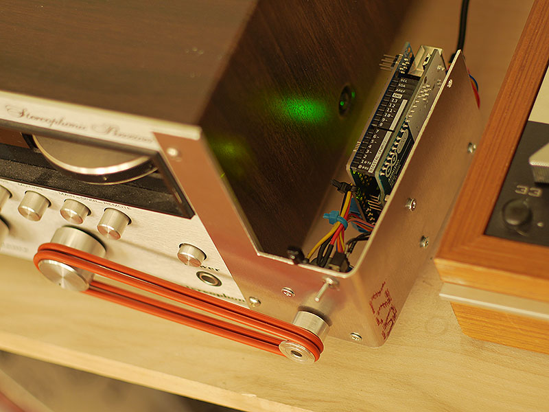

Here's someone's Arduino based solution:
https://www.waste.org/~knobs/arduino_remote_stereo_volume_control.html
Yeah it sure does look professionally done. Creative solution though. Resale value is also unharmed 😀

I mean that you could do this on the outside just like the example in the picture so that it can be removed.
