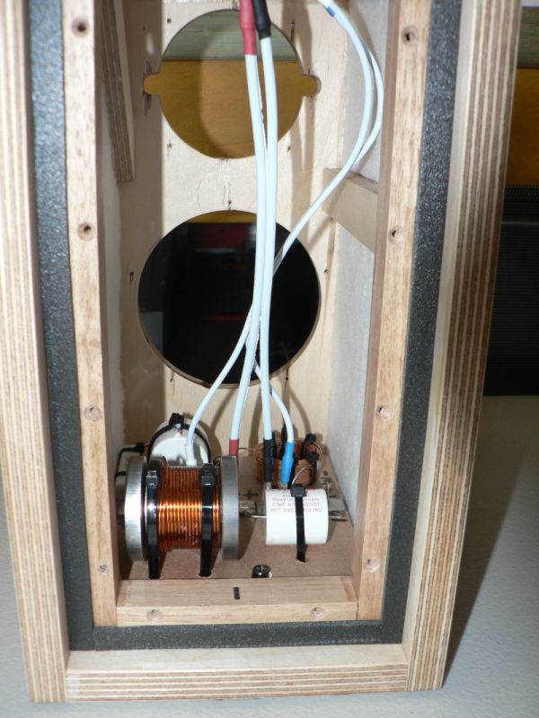

weatherstripping!! That actually gives me the idea now, I think I get it. Lay the weatherstripping on internal cleats and just screw the panel to the cabinet. Hmm... Thanks for that.
Most of my speakers have removable back panels for easy access to xo etc, especially on small speakers. Also handy when removing drivers as they can get a thump from behind to remove them.
Just needs a cleat for the back panel to rest on and a gasket to seal it.

You'd obviously have to look at other ways of doing your bracing with that previous speaker of yours as an example, however the rear panel is the easiest to make removable and gives incredibly good access.

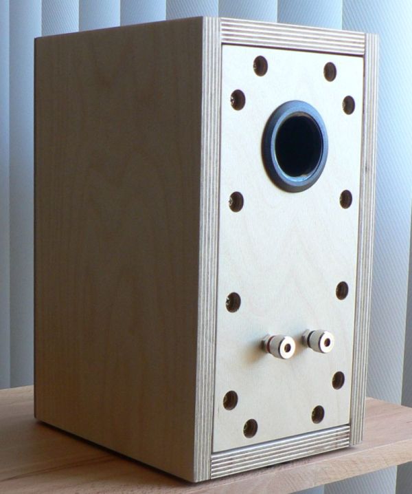

Make the box minus the rear panel and glue in a recessed edge (on all sides) inside the box that the rear panel will screw to, such that the rear panel sits very slightly inside the rear of he box. Use some form of foam/rubber seal, plenty are available with an adhesive on one side, and it should prevent any leaks or vibration. You can also add braces side-to-side aligned with the rear that the rear panel will also screw to which provides further rigidity.

I try and avoid using wood screws an awful lot these days, trying to make maximum use of metal threads (through the use of t-nuts/nutserts/inserts) as it allows components to be removed/replaced without few of being able to really tighten it back down each time. Basically if is a permanent fixture then it's glued, and if it's removable then it's a metal thread.
That weather seal does disintegrate after a while. I use a polyethylene foam gasket that you can get from Wagner but I buy from WES Components (same place) as I have a trade account.

One other thing. When you drill the driver screw holes, countersink the entry point as it stops the mounding of MDF etc (see pic post #6). I then drive screws in and coat the threads with PVA which soaks in to give it extra strength especially in MDF.
