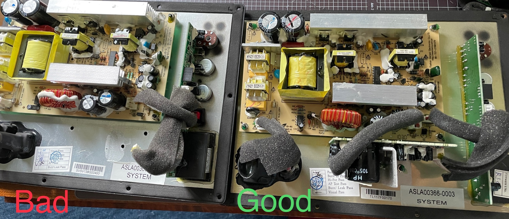

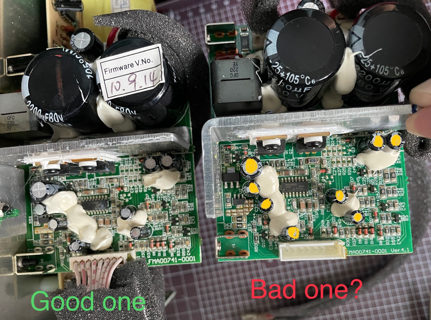

Pretty straightforward. A power supply board, input/control and then the output board. Cables were disconnected when measurements were taken and caps drained.
Out of all the measurements I've made (Fluke 87V) the only differences I've found are for the yellow marked smaller caps (most 16V, 10-22uF) on the "moset side" of the heat sink. They get their values (within 15%) on the working amp but show OL on the broken one..

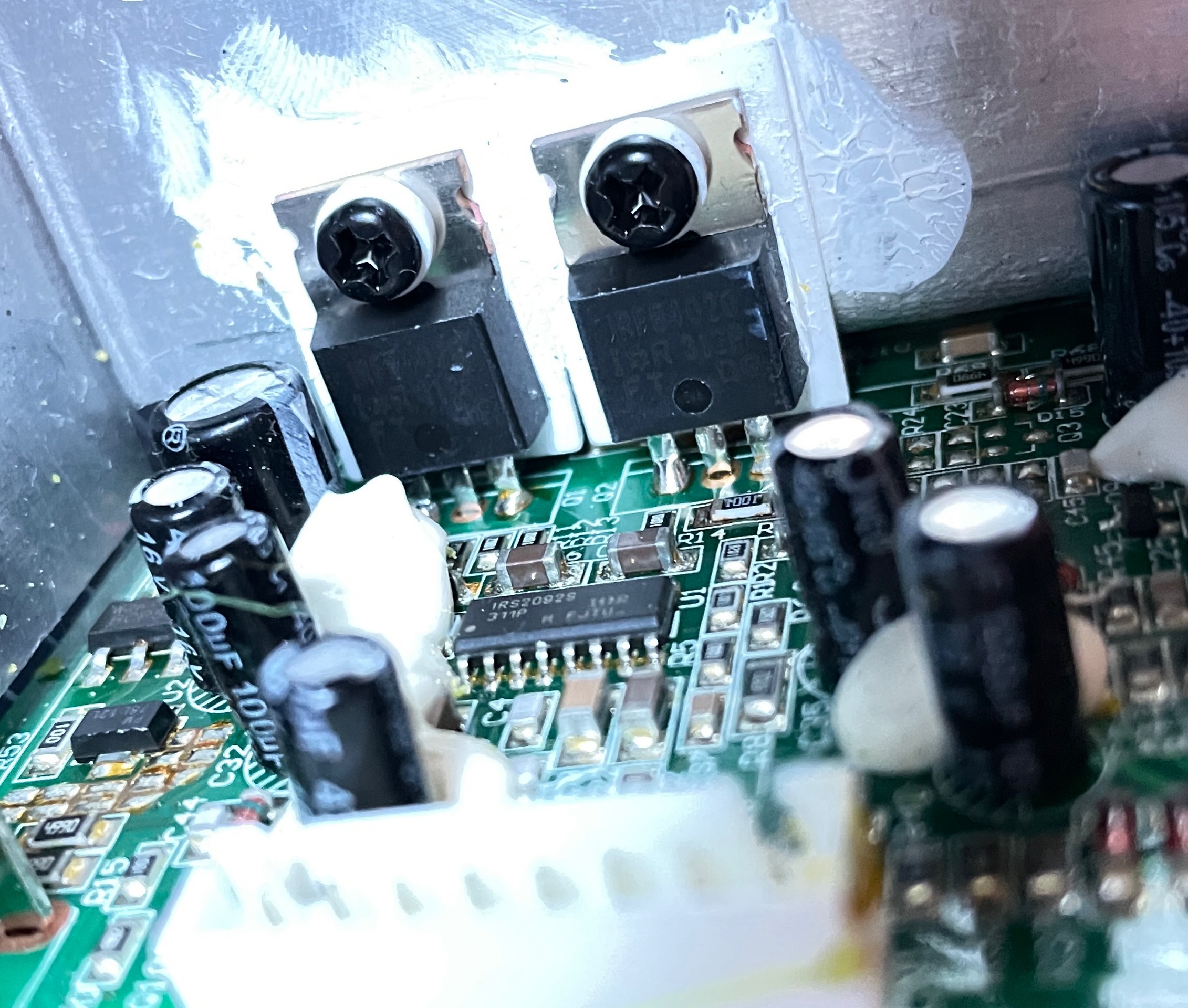

Here's the output up close:
And some identified parts with their datasheets.

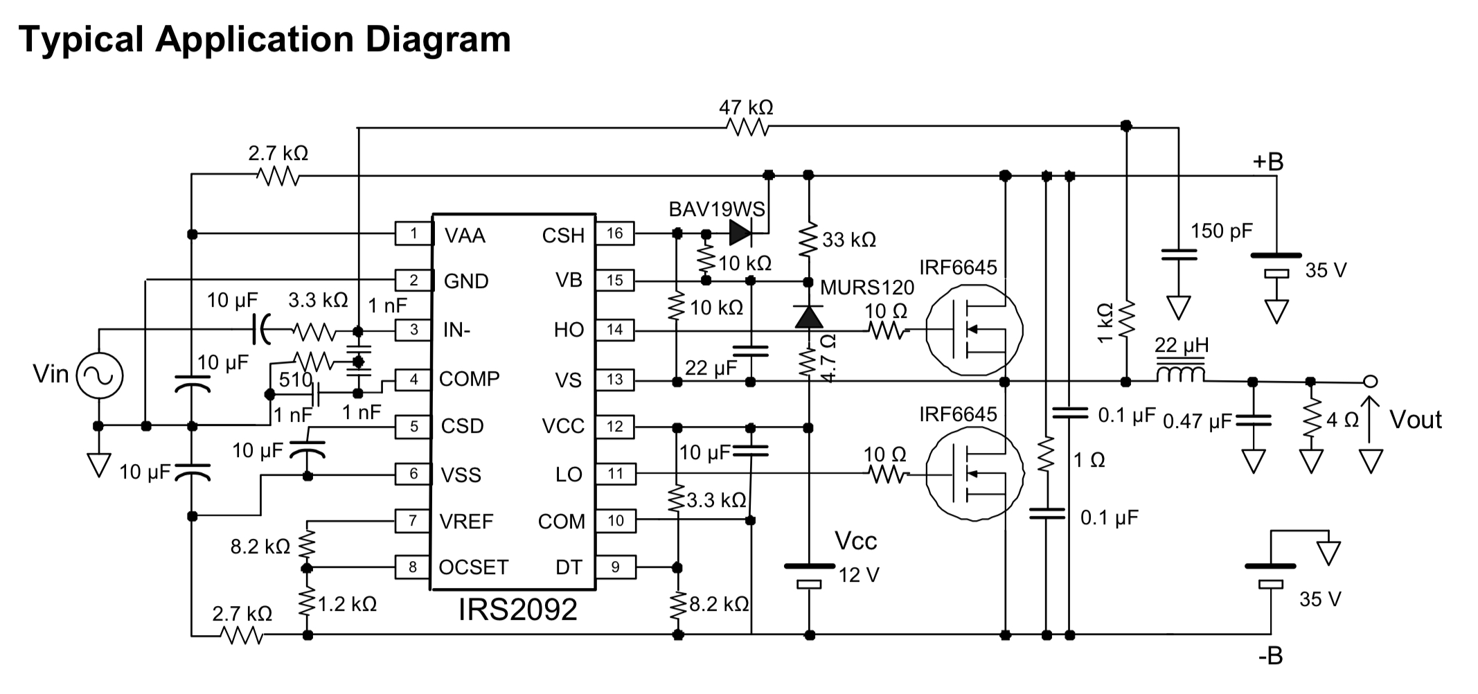

- IRS2092 amplifier (http://www.infineon.com/dgdl/irs2092.pdf?fileId=5546d462533600a401535675f1be2790) Example circuit looks pretty similar in regards to the resistors/caps value I've measured (in circuit)
- 2 IRF840 power MOSFETs (https://www.vishay.com/docs/91070/sihf840.pdf)

The smaller ELE caps are measuring OL sounds like the low voltage rails feeding the IRS2092 are shorted. This can be confirmed by measuring resistance from IRS2092 Pin 2 (ground) to Pin 1 (~+5V,VAA) and Pin 2 to Pin 6 (~-5V,VSS). This should be measured with the output board not connected to the SMPS.
If the above is confirmed, we need find the source of the short. It could be the IRS2092. If you have the equipment to desolder the IC, I would start by removing it and repeating the above test on the IC out of circuit.
If the LV rails are still shorted, the two 5.1V zener diodes (D15, D16) used to regulate the +\-5V rails could be shorted. Remove from PCB to test.
If the LV rails are still shorted on the output PCB, one or more of the ten small signal NPN and PNP transistors could be shorted. Check the PN junction diode drops on the PCB first. If you find a short, remove the transistor from the PCB and retest to ensure there wasn't another shorted transistor on the PCB shorting out the one you first tested.
When you find the culprit, I suggest digging a little deeper to try and understand what happened before trying to power it back up.
