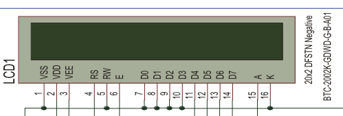

Hi Pars,
Thanks, that would make sense. Easy fix, lamps may be out. Replace with LEDs, but this requires some experience doing that to avoid hot spots.
