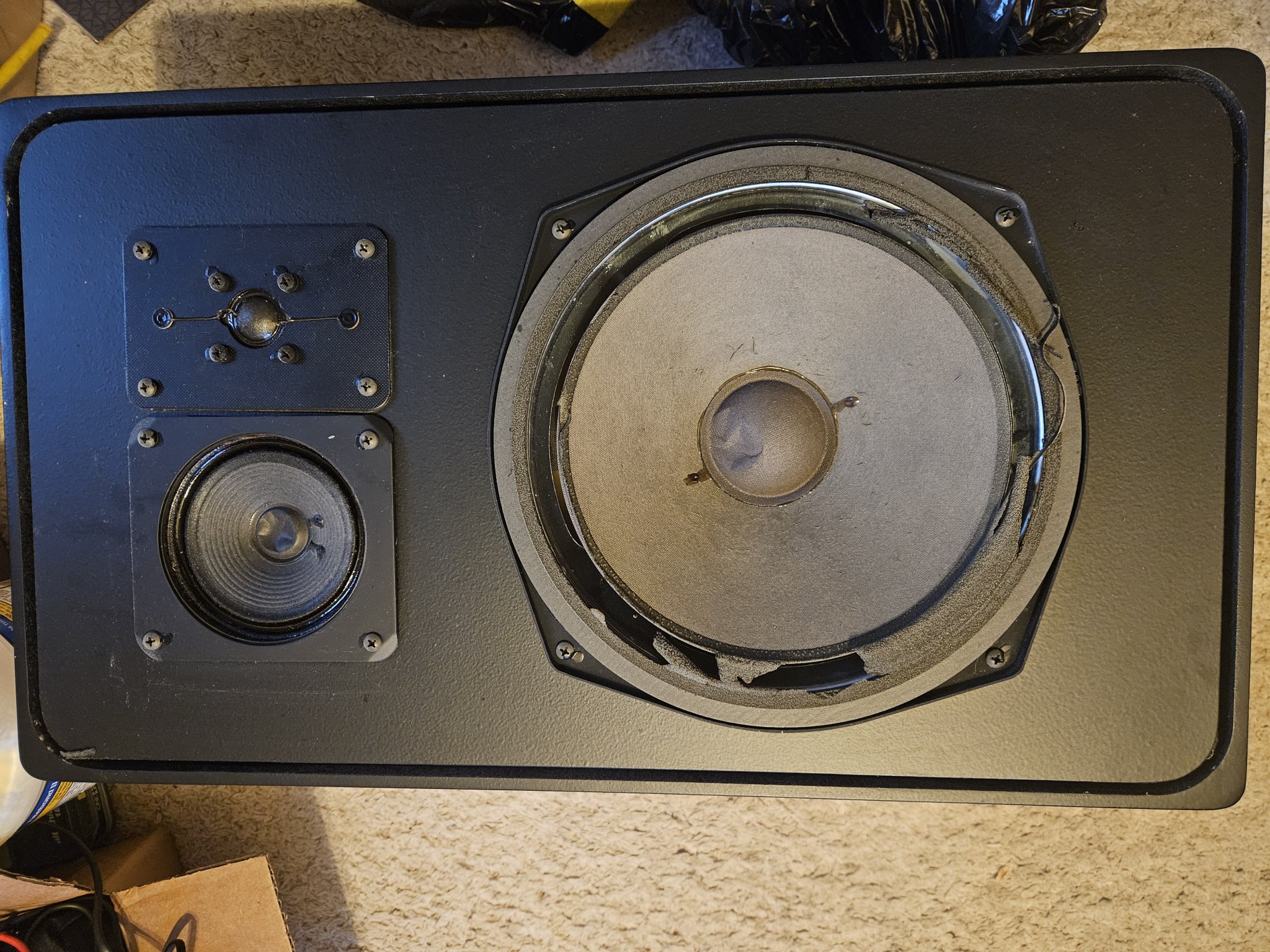

A friend at work has given me some Braun 1005 loudspeaker for repair after they have been in his loft for a some time.
Obviously he has a good loft or he protected them well as they are in very good condition for their age. He remembers buying them in the early 80s. Ideally he want to have them working again for his office space.
The woofers need a refoam and the one of the woofer domes and the midrange cone also has a dented dust cap. I have opened up one of them to get some info on the crossover. The inductor mounting screw and the pcb retaining screw are both made of brass which is a nice touch

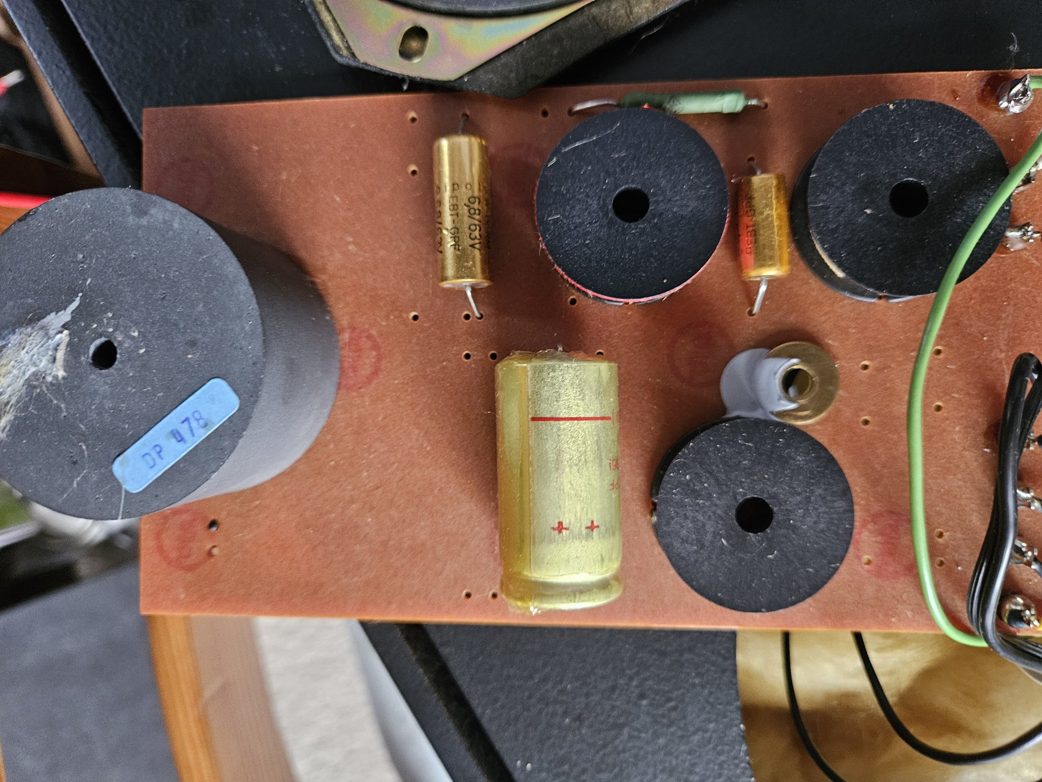

The bass has a ferrite cased inductor which I measure as 3.9mH plus a parallel 47uF marked ElKo electrolytic. which i measured at 50.3 uF.
The small midrange cone is fully enclosed as a single unit , much like the sealed tweeters of old. It has three components in series with it 0.2mh, 6.8uF, a 7.2ohm resistor and then a 4mH inductor in parallel. I haven't measured it series resistance yet but I think it will be high as it is a very small inductor for a value of 4mH.
The tweeter is fed from a 3.3uF with 0.4mh inductor in parallel.

The Braun SM 1005 were the ones with the 50mm dome midrange, your speakers are the Braun
IC 1005. The slash + number was used for the iteration, the speakers were modified slightly over time.
I don't remember Braun using FF in the tweeters, but I might be wrong there. It could be some dirt or dust in the air gap too. Since the capacitors are electrolytes, I'd rather change them before disassembling the tweeters, after 40 years it's suggested anyway (all of them) for the tweeters use a foil capacitor, on the mid too if it's not too expensive, for the bass just use a good electrolyte (it's just parallel anyway).
When disassembling the tweeters (yes, do both! You don't want them to sound different) there aren't any secrets but on reassembling you have to be careful since they are likely not self centered.
If they don't have FF, you can center them with a thin 0,2mm plastic foil, which you can pull out before tightening the screws. With FF that doesn't work, you get the FF everywhere.
If they have FF, remove it and either replace it (to get the correct viscosity is a gamble though) but you might have to center the VC manually. You can do that by ear, give them a sine at 1,5k--2k of ~0,3V and move the front plate a tiny bit and settle on a position that doesn't distort. Tighten the screws and give the tweeters a glide sine 1-10k of 1V and listen to them for distortion. If they do, loosen the screws and repeat.

I wasn't in a hurry to change the capacitors in case they are a particularly good type of German made capacitors known to have a long working life. When the speakers are refoamed I will look at the overall response and how they sound. If I have doubts over the measurement's achieved I will change them.

Thank you. 🙂 You're already an expert, not much else that I can contribute knowledge wise. 🙂 I am reluctant to replace a dustcap on a cone midrange driver because it will change the sound. A dented dustcap on such a driver usually still sounds better than a replacement unless it has the exact same diameter and is glued into the same spot. The reason is it changes the tension and behaviour of the cone and its flexing will change. Measurement wise, it does not change much but it still sounds different, a subtle change some people are sensitive to and will notice while others will not. And believe me, a dented in mid dustcap really irks me too.
Soft dome mids can be un-dented by heating them up in an oven to ~60-70° C since that usually softens the coating and they spring back to their former shape or you can nudge them a bit to do so but it's important to not exceed that temperature to avoid charcoaling the fabric. Also, don't burn your fingers on them! Use medical gloves and just touch the dome or tweeter for a second. Don't try to do all the dents at once, be happy if you managed to get one or max dents go away, let it cool down, wait and repeat.
On a woofer in a 3-way the replacement dustcap doesn't change much, so a replacement is likely not noticeable sound wise. On a 2-way it can make a difference but it's still not a great change unless it's xo'd quite high.
You've already mentioned most successful methods of un-denting the dustcaps, not much to add there but how to stabilize the dustcap since it's weakened at the folding lines. To get it in better shape (literally 😀), you can use wood glue, diluted ~1:10 or wallpaper glue thinned down too.
