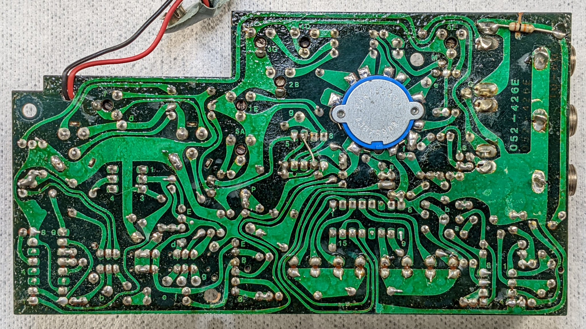

Quick update: I re-flowed the solder joints around the switch. They didn't look bad before, and they look really good now. However, when testing it afterward outside of the plastic case I noticed that any pressure or flexing of the board would change the pattern and flashing of the LEDs. It could still be a switch issue, but now I suspect there's either an intermittent short at a solder joint or along a trace, or one of the logic components is starting to fail. I'll try the Deoxit drip down the shaft to see if that helps, but I'm not optimistic at this point.

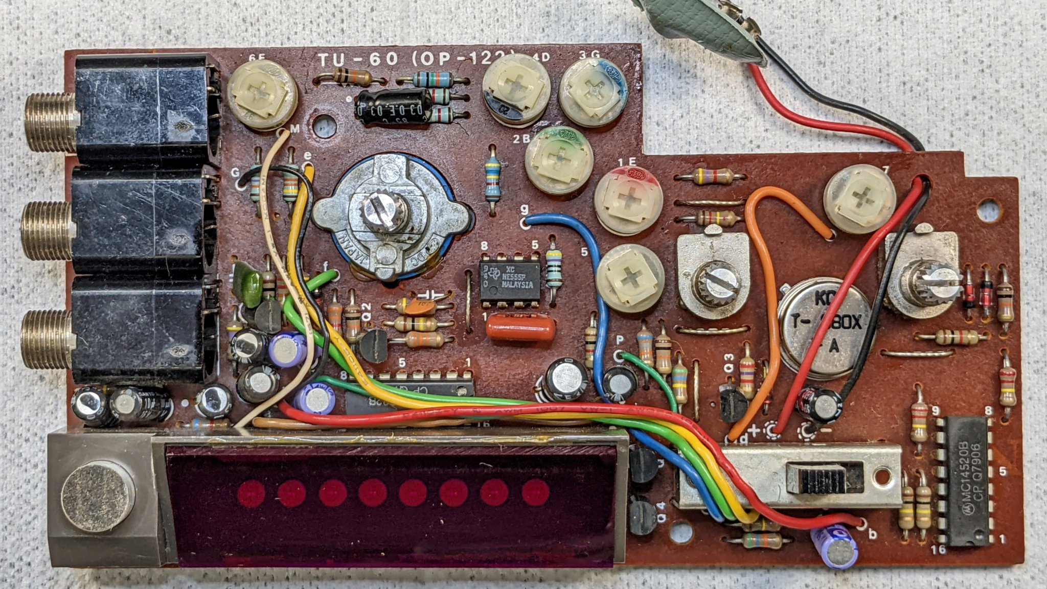

High res front and back pics attached below.Can you post a close photo of both sides of the board?

Still think an oxidized/dirty switch is the most likely thing. There are several pots that could be dirty too.

Its quite possible there is a bad solder joint or broken component leg. Try to localize the problem by applying pressure on solder joints, components with a pencil. Often solder joints can look good without an inspection scope to see full detail.

There seem to be several very cheap trim pots. Those are often a problem in older equipment,
but their setting methods are likely difficult to find out.
There is no external access to those, so I would assume they're set at the factory and never adjusted afterward.There seem to be several very cheap trim pots. Those are often a problem in older equipment,
