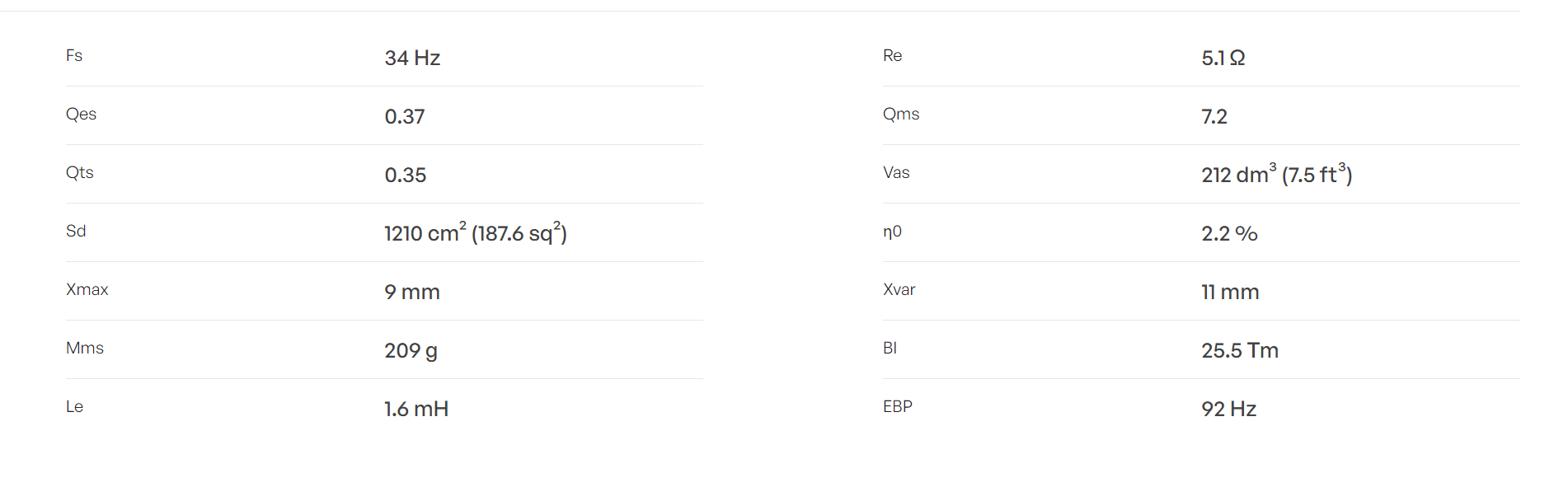

Personally I would suggest something from B&C, probably could find one that matches TS parameters of original quite good and those drivers are high quality. Maybe look for 18TBX100, 18TBW100, 18NW100, they are very good mid-price options. Try to find TS parameters of original driver and find close match.
The EV drivers are custom made to a price point and as such they are only just good enough for general uses, I think the drivers thermal capacity is it's biggest weakness. However I would not suggest using a car audio driver they generally don't have anywhere near the correct sensitivity for PA applications, there should be a PA sub driver that would swap in. The right way to do this is to model drivers in a program like WinISD for the enclosure volume and port dimensions of the EV cab.

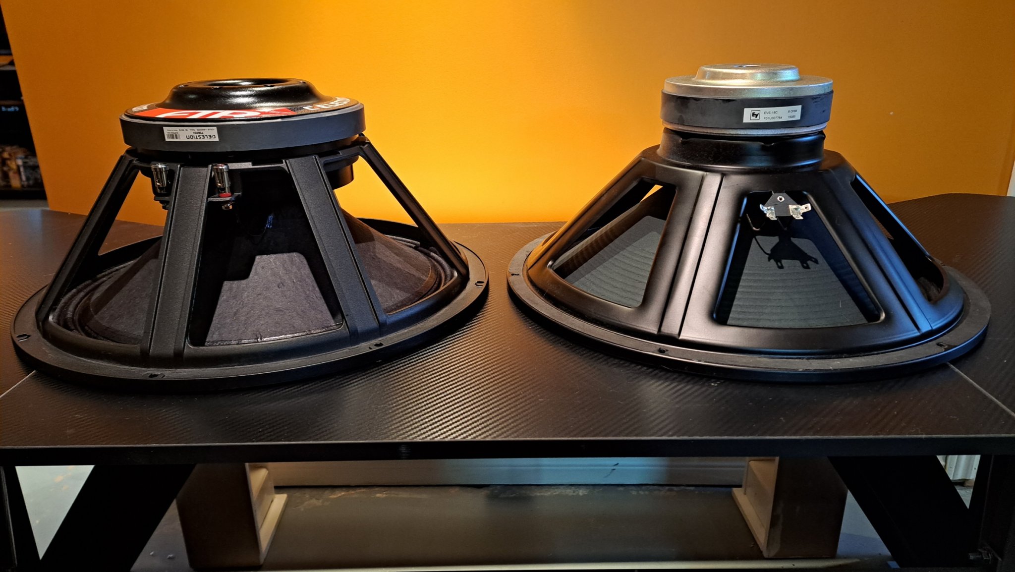

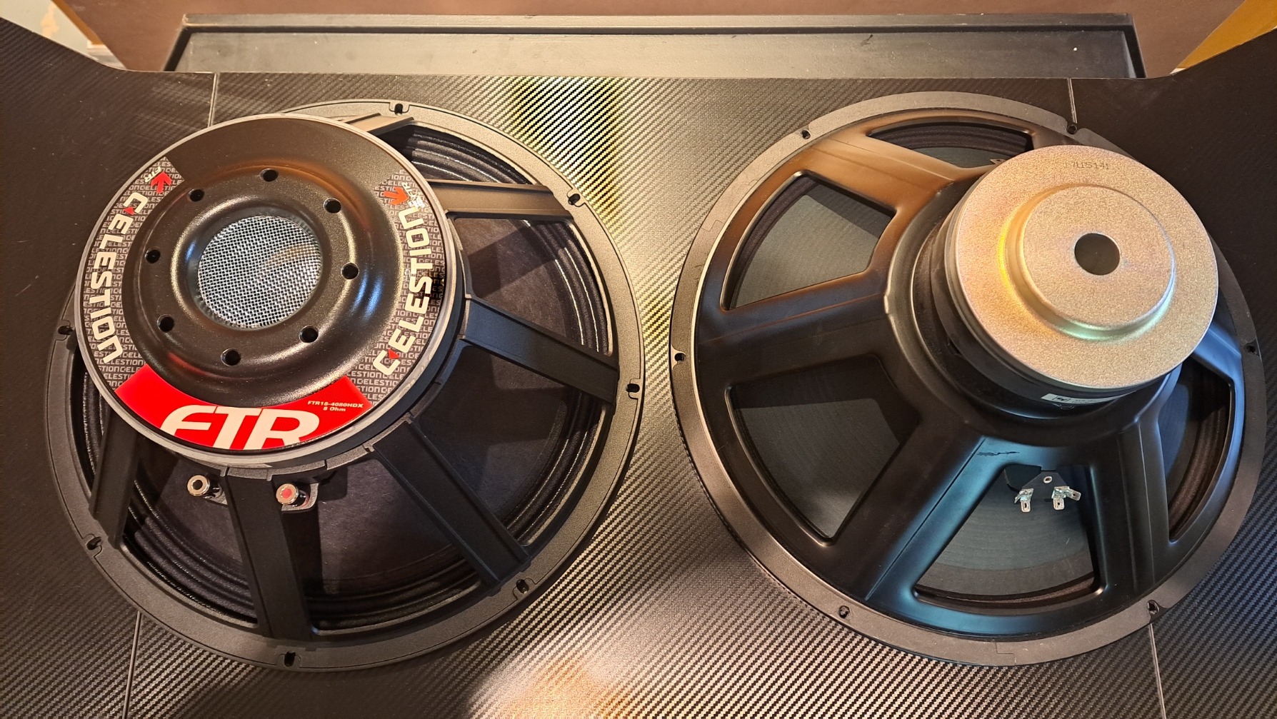

I did this upgrade with a pair of passive EV EKX18's I acquired with blown drivers, in my case there was a Celestion 18 that was a good fit.

there are also 8 ohm versions, be careful - other specs differ slightly between different nominal impedances of drivers. Not sure about price in US but here in europe is about 250-300 euro. TS parameters determine the behaviour of driver in enclosure, you should try to match them with original. Since there is no info about original driver parameters I would probably try 18TBX100 since its commonly used in many bass refex cabs and reliable. Cannot gurantee 100% tho since there are many variables. Since there is need to handle heavy bass i would definitely go for driver with decent X Max and large voice coil for cooling,
Here is example of T/S parameters

There is some EQ applied to broaden/flatten the response but from what I discovered doing this with my EKX boxes is that it's minimal and that makes sense... a reflex sub really doesn't need a lot of help, the amp module does include a ton of protection though so I think a different driver would be pretty safe as long as it is suitable for the enclosure.My concern is, since they are powered by onboard amplification, there might be high amount of dsp correction applied, so they can get maximum out of relatively non-impressive driver.
For what it's worth here is the OEM EKX driver and it's replacement.
One thing you may see here is the difference in the driver bolt pattern, I had to drill new holes and add a few more T-nuts and bolts.
