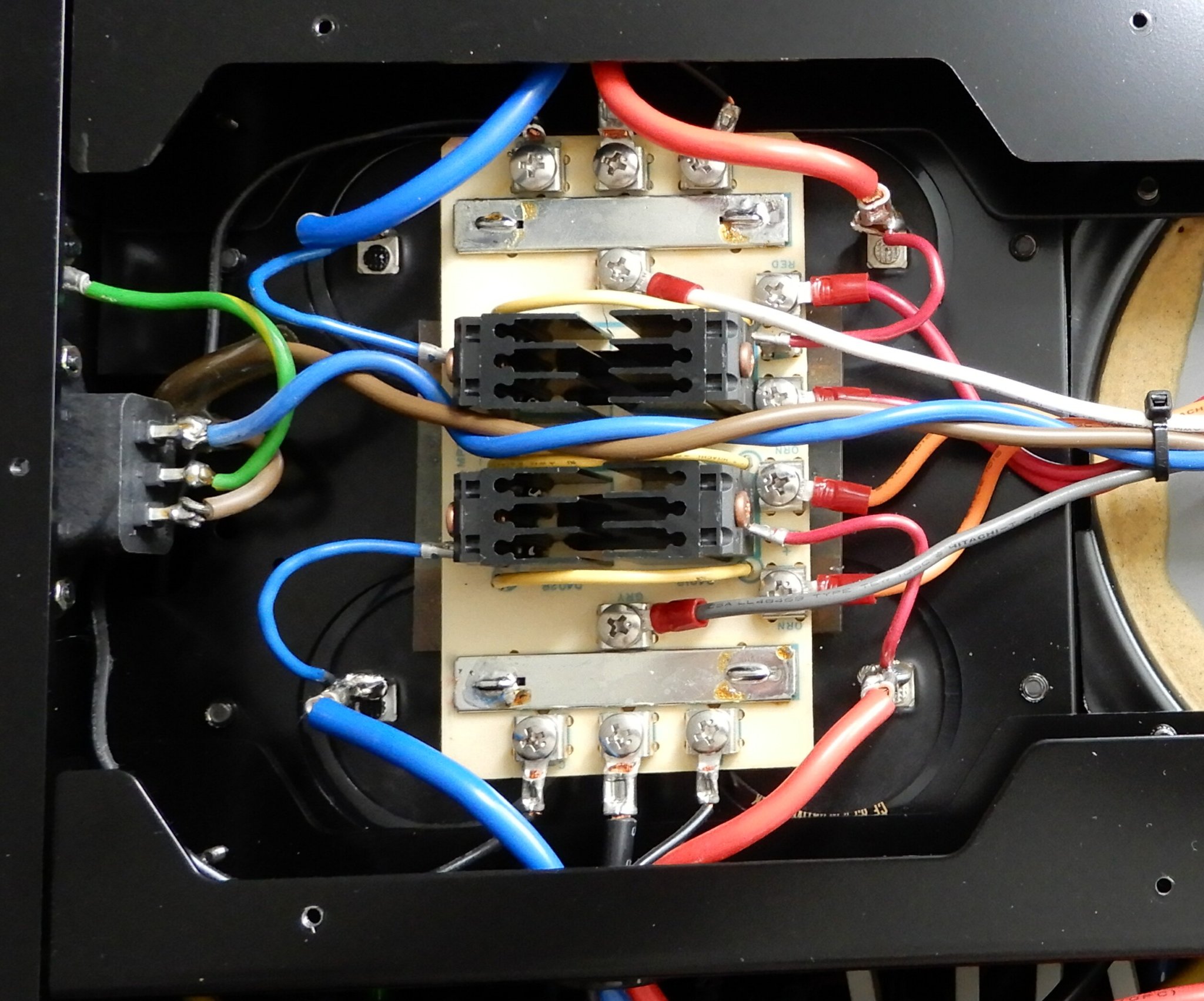

You will have a bit of a challenge changing main filter caps in this amp. I was not able to find any suitable capacitors with the combination of spade terminals, spacing, diameter, capacitance and acceptable length. Available capacitors I was able to find only have screw terminals and the spacing is different.
This power supply/rectifier board is made for spade terminals to be soldered into the ground buss. Also, the capacitors must fit into the clamp plate with the terminals in the proper locations. Here is a photo of the bottom of the amp, showing the PS board.
Thanks @GKTAUDIO
I think the same capacitors I found were used here, so it seems to be doable:
https://www.audioberg.dk/nakamichi-pa7ii-reparation/
I guess some connection cables and ring terminals were used - or maybe soldering lugs were screwed onto the capacitor and soldered directly to the board in your picture?
