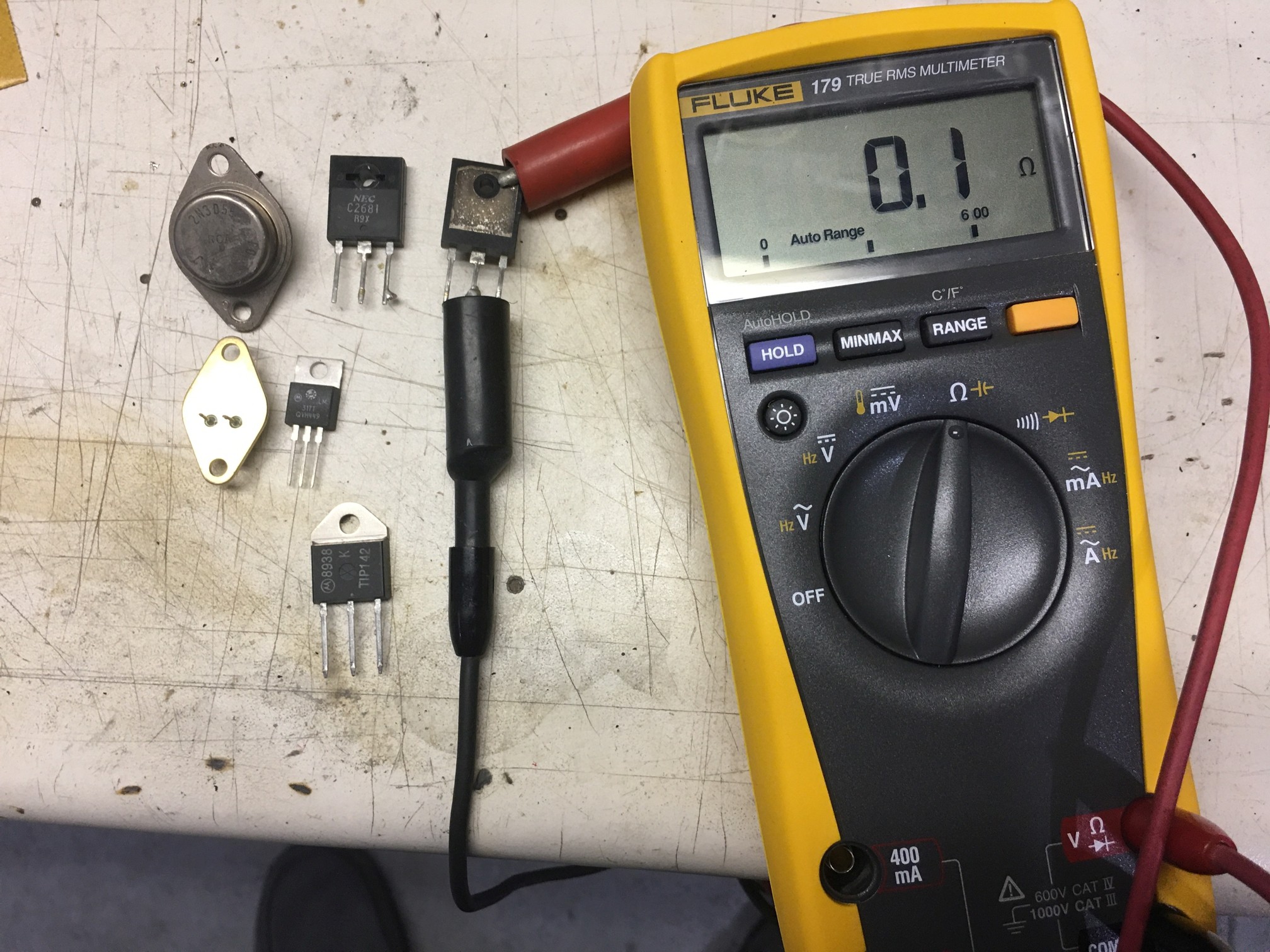

As far as I know, Transistor Outline (TO) packages were designed to be backward compatible. The TO-247 (and related) package was designed to be mounted on TO-3 heatsinks without the need to do anything to the heatsink. This is the answer to the mystery of the tab electrically connected to pin 2. To mount a TO-247 transistor on a TO-3 heat sink, clip pin 2, fold pins 1 and 3 so that they go through the holes and bolt the tab to the hole that has the electrical connection.
Similarly, TO-220 package was designed to retrofit smaller TO-66 heatsinks.
I assume this would be ok in the case of a quick repair, wouldn't look very good for your best design! Cheers.

You do *not* want to clip pin 2 on a TO-247 when inserting into a TO-3 socket. The mounting hole is *insulated* on the To-247 and TO-3P. You have to connect a wire to the collector lead and run it into the opposite hole. You’re thinking of the no longer available TO-218, which had a collector tab. The TO-220 will indeed fit the old TO-66 socket as described. Might want to heat shrink that collector lead to keep it from shorting against the heat sink. For now TO-3’s are still available. Not many types anymore - but you really only need two or three. You can still also get the MJ802 and MJ15015 families, but there’s no reason on God’s green earth to use them over the MJ15003 family. There is a scattering of other types, but not well suited to audio. The few that are , are only available in NPN (ie, 2N3773).
Sorry, my bad. Clearly insulated packages like TO-247 need their pin 2. I meant something like TO-218. I have a number of power transistors whose non-insulated tabs are indeed connected to pin 2. I do not remember where exactly I read about retrofitting 3-pin transistors with tab onto TO-3 heatsink by cutting pin 2, but I certainly am not the origin of this idea. BTW, the one on top left is a vintage RCA 2N3055 I got many years ago! Cheers.
