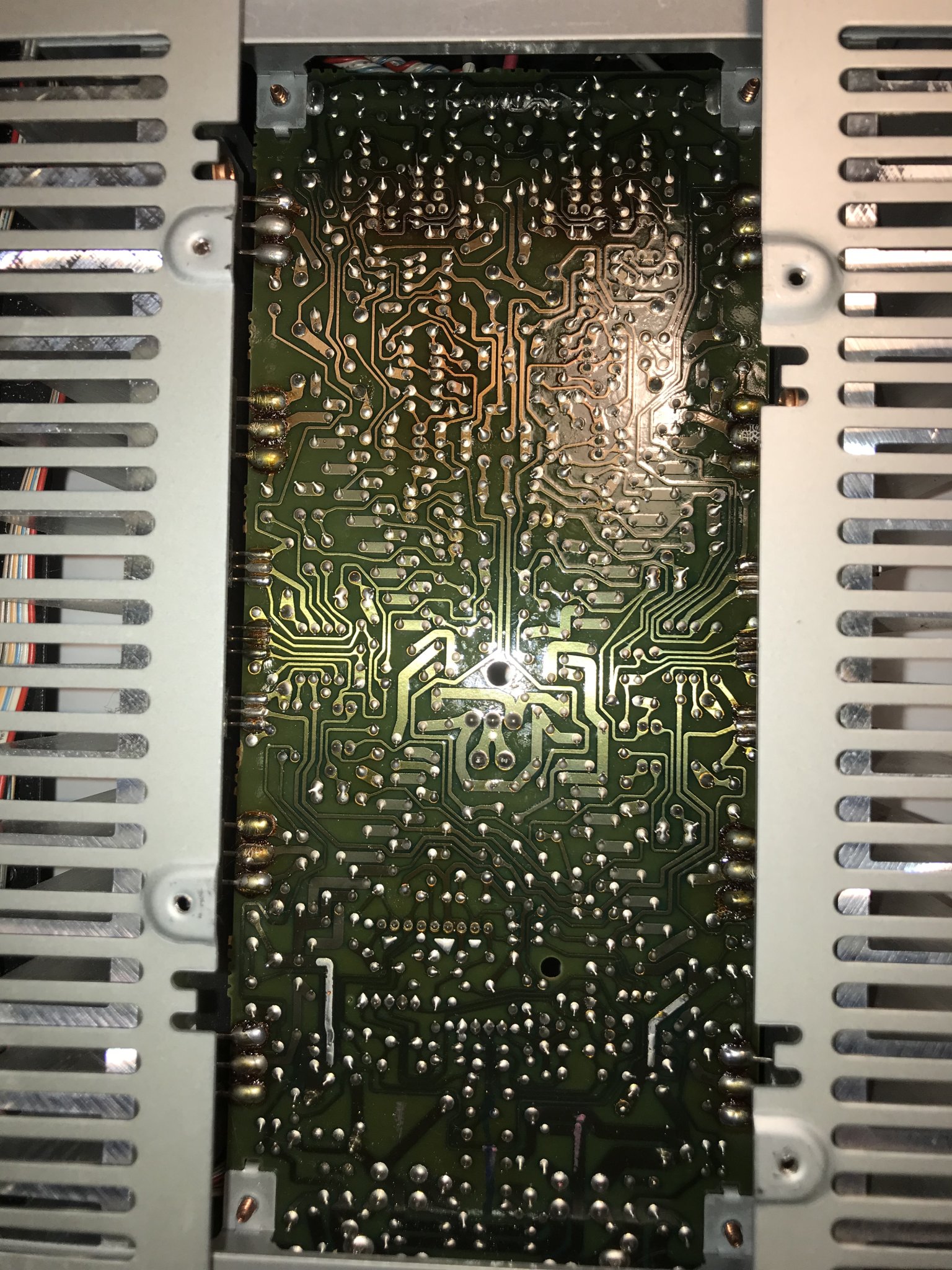

My PM80 MK II works normally for some time, then starts to throw some loud pops and cracks to speakers, probably damaged something inside because of over heating. I was told to not worry about temperature, because it should have some thermal relay inside that switches power off when temps getting too hot. It was used in normal conditions, volume knob to 10 o clock, and it was sitting in TV-table, having about 3-4CM room above.

I would check for bad solder joints because it was the cause of same problem on a few amps i got for repair.
Bad joints were mostly on power supply boards but also found some around the output transistors/ICs.

Power supply board seems okay

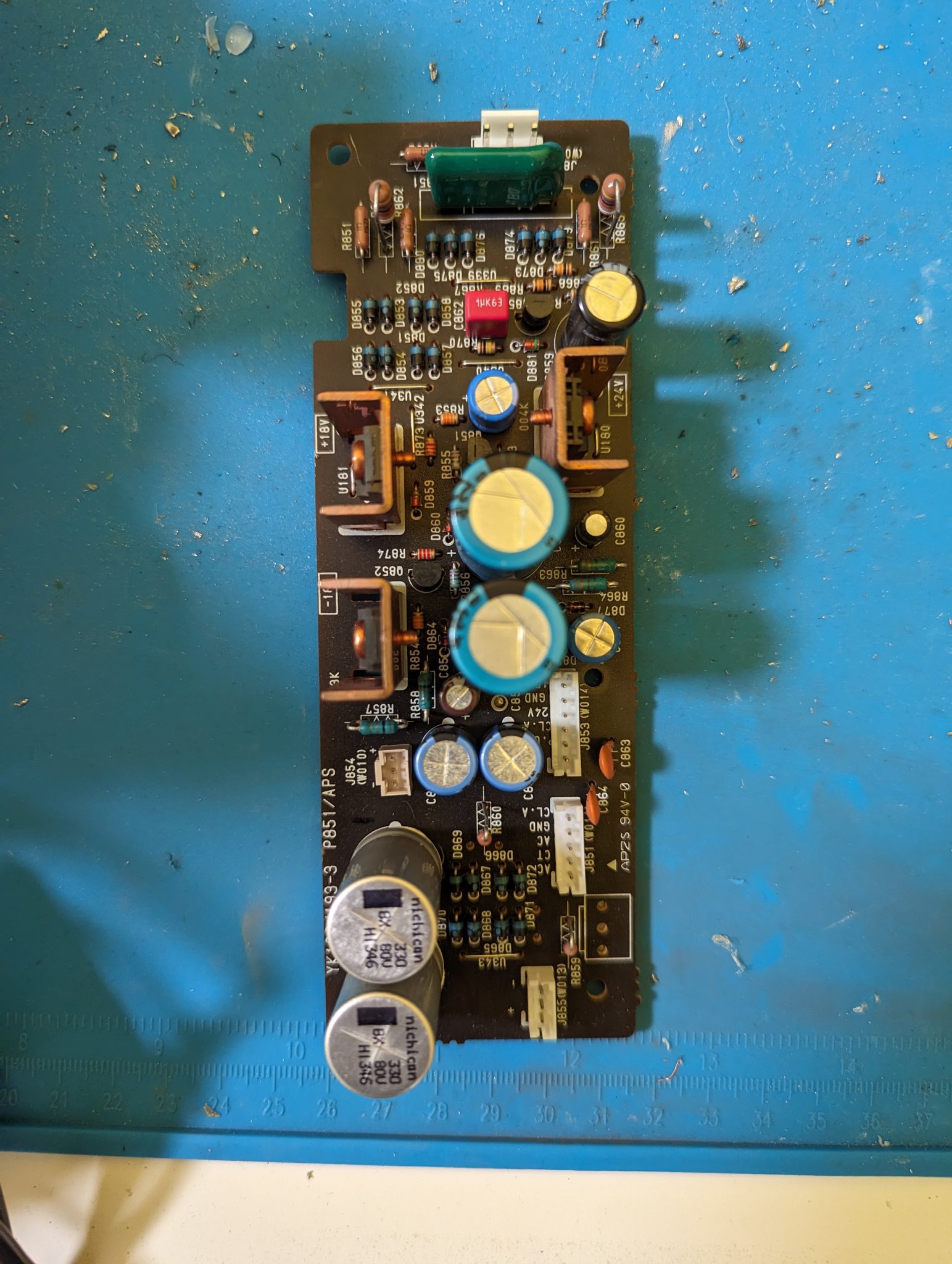

Have a look at the auxiliary power supply behind the front panel. Had the same problem with this amp and the circiut board was simply cooked. All caps on it and some of the resistors were out of spec. Also every solder joint was suspicious. Currently I have it out of the amp again to do a new board for it because it's not made of the best quality material.
measured from speaker terminals -04.7mV to -10.1mV from left channel, while right channel was roughly half of it
Nothing shabby about those output voltages, but in post 7 picture, I do see some solder joints that look nearly devoid of solder: two arrays of three, oriented vertically, not far from right side screw boss and "W" notch in the sheet metal. Looks to need cleanup and resolder. I'd look carefully for heat damage.
Cleaned it all up from dust, put it to a place where it gets all air from above it needs. Unit works fine now, but will check and measure components from this auxiliary power PCB as many users are finding problematic components from there.
Dust is the least of the problems, you should have it measured. 😉Cleaned it all up from dust, put it to a place where it gets all air from above it needs.
have to remove these components from board and then measure their values?Have a look at the auxiliary power supply behind the front panel. Had the same problem with this amp and the circiut board was simply cooked. All caps on it and some of the resistors were out of spec. Also every solder joint was suspicious. Currently I have it out of the amp again to do a new board for it because it's not made of the best quality material.
