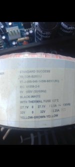

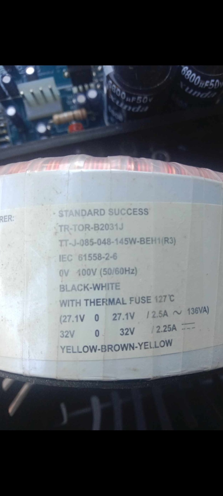

How is the transformer plugged in?
And what made you decide the transformer was faulty?
Please post a picture.

Believe nothing 😄, MEASURE.a pair of Truth 2030A monitors and one of them has what I believe to be a bad transformer (keeps blowing fuses). I've swapped in the transformer from the other monitor and that seems to work fine, so I don't believe it's a fault with the board.
There are no specifications on the transformer itself regarding VA rating etc, but I believe it's 24V secondaries with a center tap.
Tap voltage is measured directly, VA comes from size and weight.
There's your replacement specs.
See above.I'd appreciate if anyone could steer me in the right direction - given a board requirement of ±15v (after rectification, which is handled by 4 discrete diodes), and that the Truth 2030A provides 110w (75w+35w), would a 160VA toroid with 25V secondaries with centre tap be sufficient?
