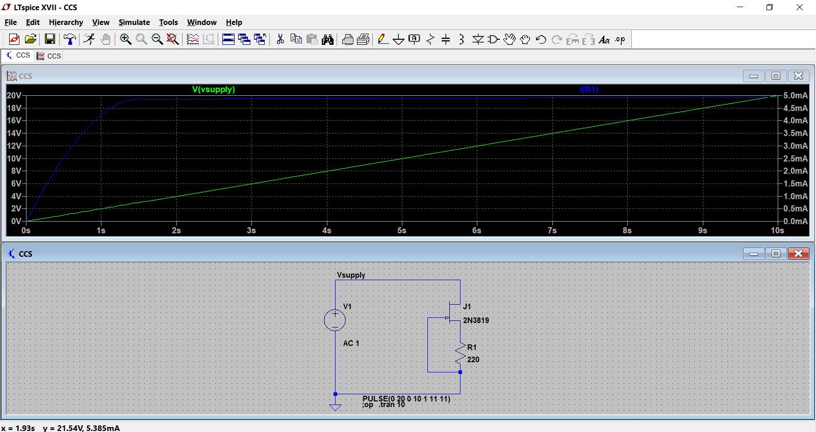

A constant current diode is a JFET. http://www.vishay.com/docs/70596/70596.pdf
BTW, where is it that you live where you can't buy them?
Like this. The JFET and resistor equate to a two terminal device like your CC diode.
The resistor has to be selected on test to suit the FET. Notice how the current is constant in relation to the rising supply.
Edit... you need to be sure you have sufficient voltage headroom for the FET to work. If you post the headphone circuit we might be able to suggest another alternative such as a bjt transistor CCS.

What Mooly said. And you can use a cheapo ($.40) J112 instead of the dear ($.86) 2N3819. Use a pot instead of the fixed resistor and dial in the desired current. The constant current diode probably has some temperature correction going on. There are ways to do this with discrete parts. How critical is your mission?

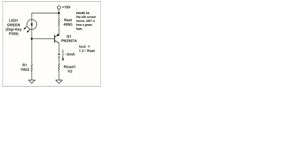

The BJT with a diode and a few resistors will build a reasonable CCS.
It's pretty easy to design, Rset is chosen so that Vbe - Vdiode is dropped at the required current
An LED is shown as they are low noise. If Vled is 2.1V and Vbe is 0.66V then Rset = 1.46V/Iout . So for Iout = 10mA you could use 150R

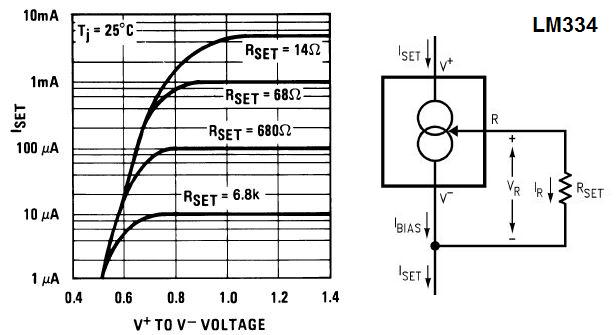

None of the LM334 and similar ideas work here, I wonder why you suggest them .
The OP does not need a constant current to a grounded load supply, but two terminal current source, a very different thing.
The FET or bipolar based suggestions are fine, of course.
So what's the problem 😕None of the LM334 and similar ideas work here, I wonder why you suggest them .
