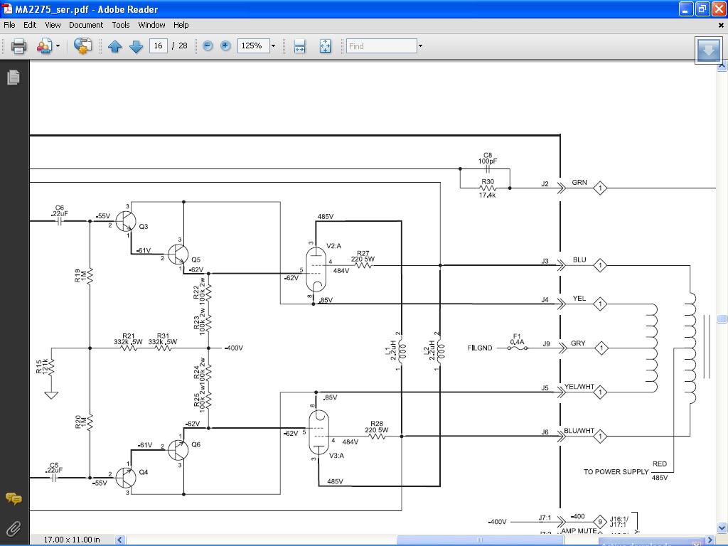

Per schematic shown: Q3 base at -55VDC and Q3 emitter at -61VDC.
How is this possible, forward biased junction blown open ?

dc coupling emitter to grid of power tube allows for class AB2 mode of operation,
so that at positive grid voltage, current flows to the grid, grid impedance drop like a stone..
perhaps an MJE340 will be better in that spot or even a TIP50...
let's hear what the experts say....
perhaps a reversed biased diode, say an 1n4935 across emitter base juctions can mitigate damage...

There is a mistake on the Mac diagram , voltages at Q3 should
emitter -61.6
base -62.1
Q5 emitter -62.8

Vbe of most transistors is usually 600mVbe to 700mVbe.
Pins5 & 8 determine the voltages around the transistors.
What is the range of voltage difference that can appear between 5 & 8?
output tube idle current is set by resistors R22/R23 on the top half and R24/R25 on the bottom half...
if the trannies Q3/Q5 and Q4/Q6 were not installed, the output tubes would have been at cut-off at -400volts g1..
but since trannies are there, about 1.8mA flows thru R22/R23 on the top half and R24/R25 on the bottom half biasing the output tubes to about 0.65v divided by the dc resistance of the traffo winding...and the grids at -62 volts...
slav, what model number is this amp?, looks like the first time i've seen one....
thanks slav, found service manual here.... McIntosh MA2275 | Owners Manual, Service Manual, Schematics, Free Download | HiFi Engine
